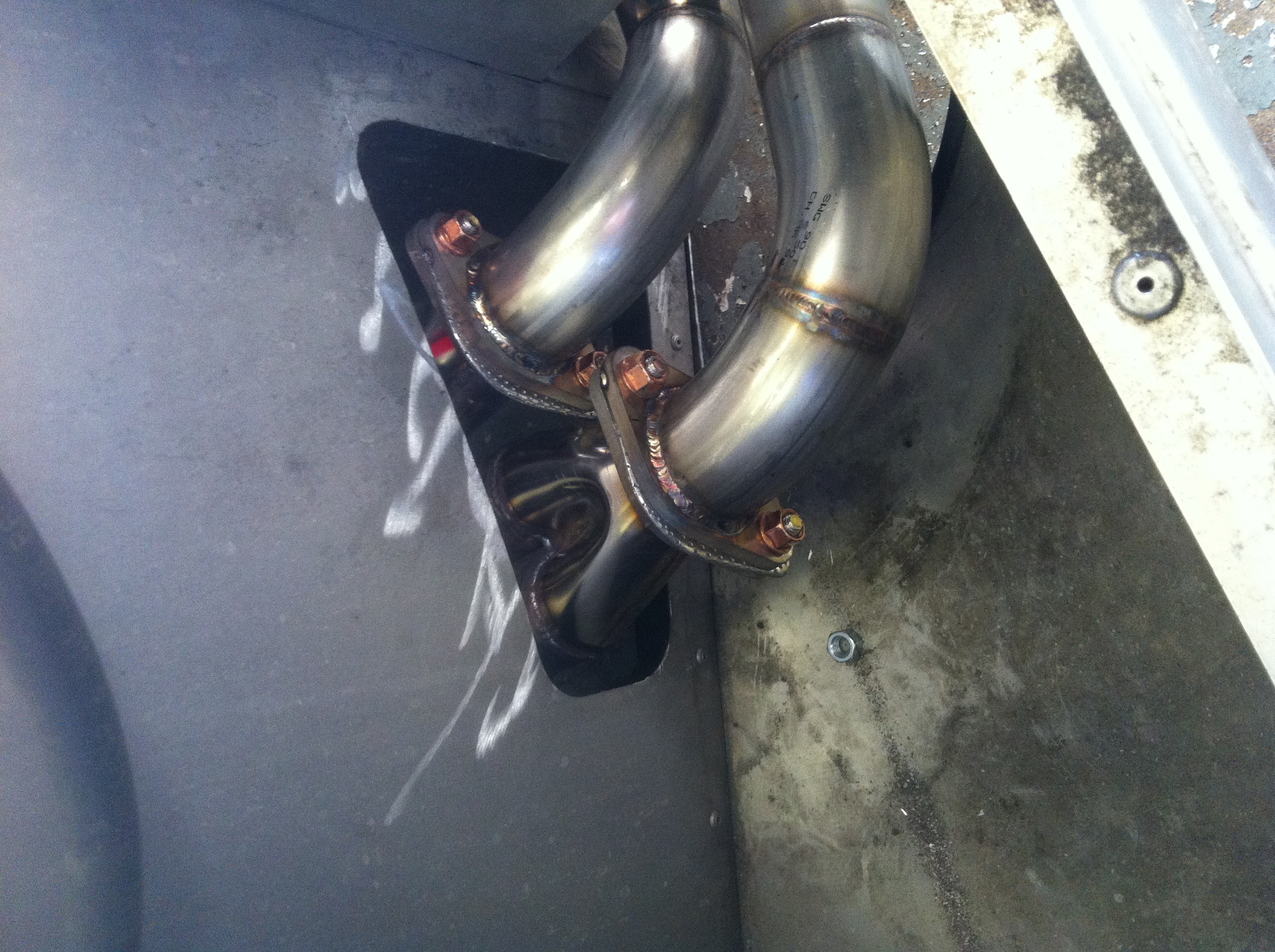

Exhausting.. Here's a few photos of the exhaust I took the other day before they were wrapped. Shame to cover up the tubes but it keeps things cooler under the fibreglass.

Hi Mark, well done with the conversion. how much hangs below the chasiss please?
Oh and some pics of engine installed if you would be so kind. where abouts are you based? would like to have a better look if possible.

Hi Malc
This is a standard Caterham dry sump set up with the titan pump. Clearance on this is about the same as the A series was. There is absolutely no option to install a K series without a dry sump, you'd leave a trail of sparks behind you shortly followed by the sump contents.
