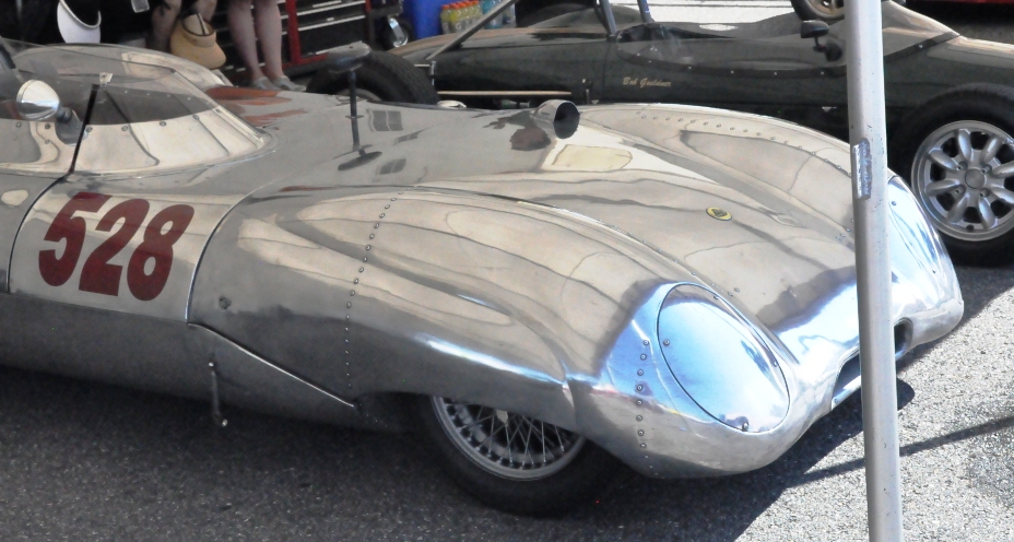

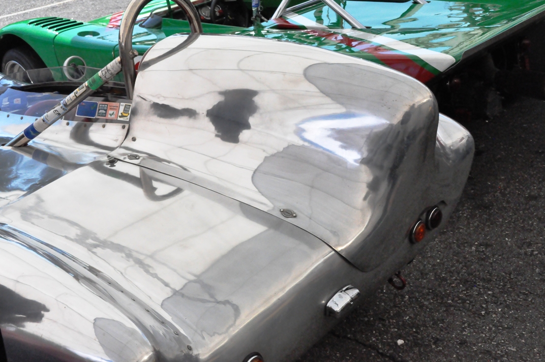

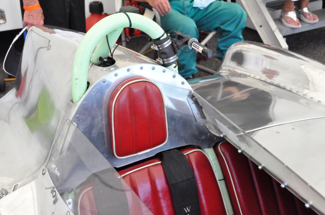

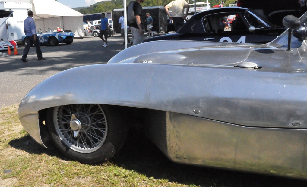

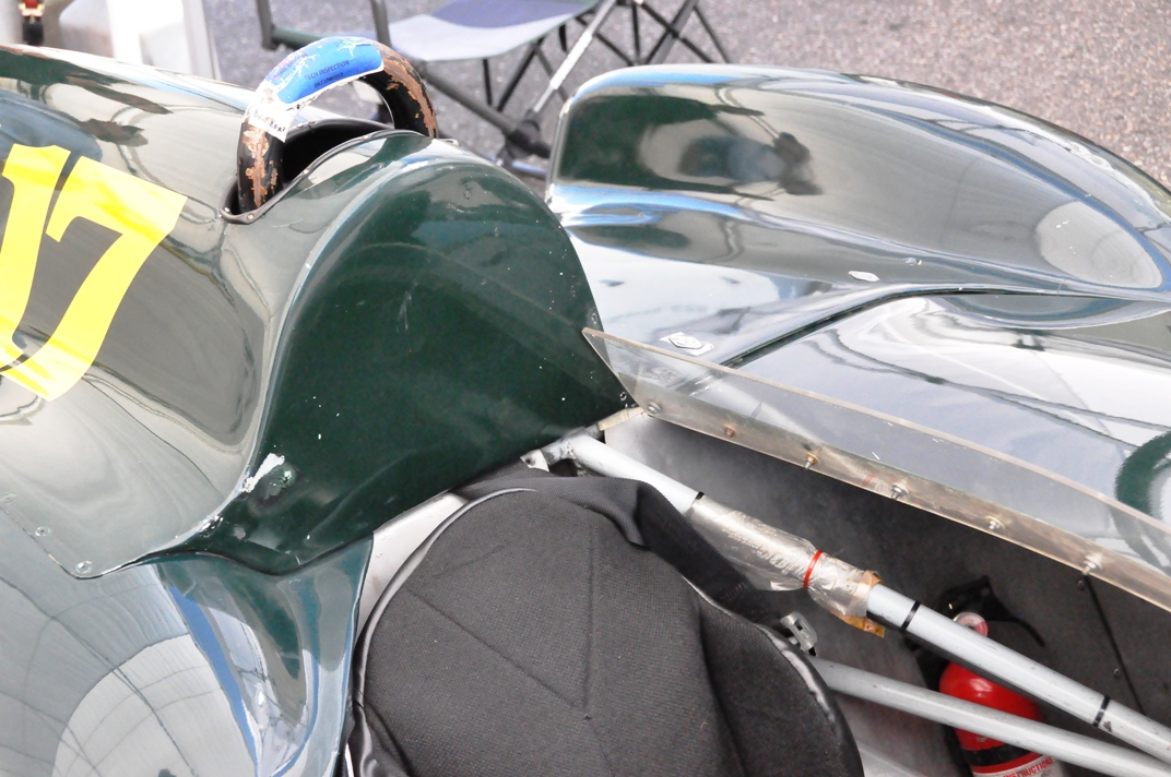

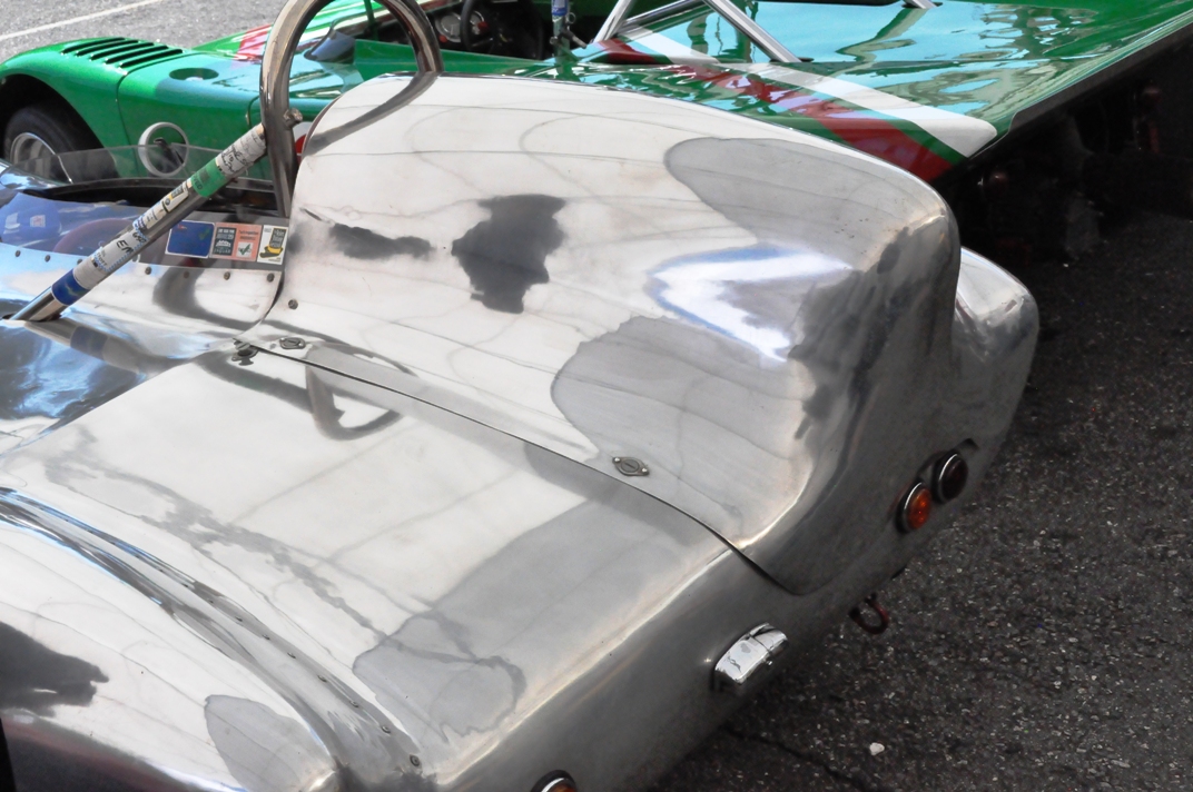

There were quite a few real Elevens racing, and I've added some pictures of some interesting bits (no full shots as the web is full of great Eleven racing pics). I was primarily interested in roll bars, rear fairings, and underhood air management. As my W11 has the non-LeMans rear shell, I'm happy to see that all the Elevens that were racing at Lime Rock had add-on rear humps. I think I'll go with the Dzus method of attachment as shown on the silver car. I also included a picture of a lovely old Lotus 9, as this was the grandfather of the Eleven. It's clearly been thru a lot over the past 60 years, but still soldiers on at the races!

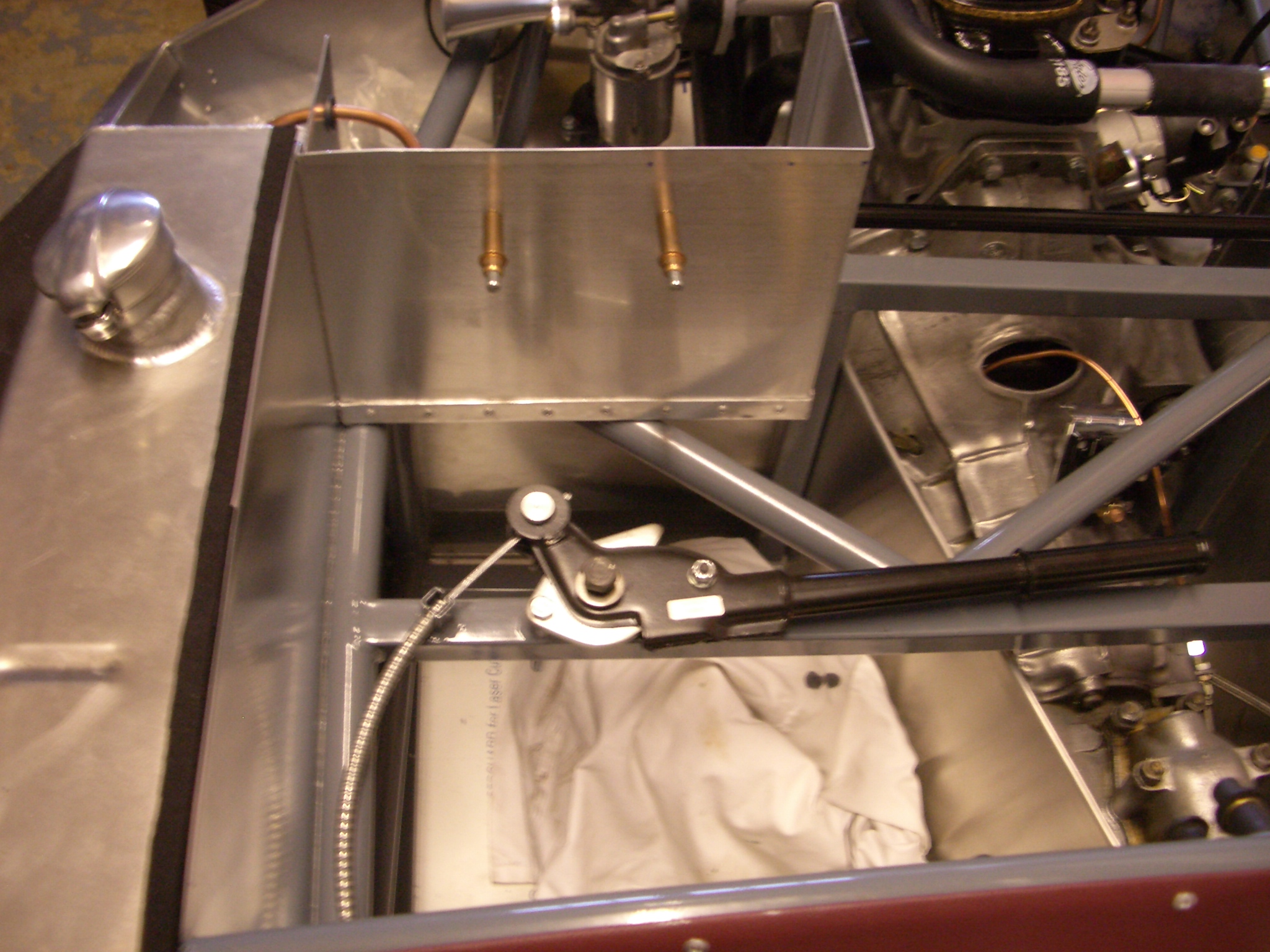

The proper location for the hand brake on a Lotus 11 is beneath the passenger side dash, over the passengers legs. Mounting is the same as it is on the tunnel, but horizontal beneath the dash.
This requires welding two parallel square tubes in place to mount the brake lever, and a longer brake cable.
My original Lotus 7 Series 1 was RHD, and had the hand brake lever mounted horizontally beneath the dash, passenger side.

Re: Lime Rock Historic Festival 2012
The investigation will have to be on your XI. Lotus 11s are all RHD, so the hand brake lever is on the left, under the dash, horizontally mounted.
Take the hand brake lever and place it beneath the dash so you can locate the two elements you will have to weld in beneath the scuttle floor, between the dash lower support and the firewall. Not too difficult, but you will probably have to remove the instrument panel and the scuttle floor. Consider a power riveter for the re assembly. Also, plan your rewiring at the same time, and your new dash panel. Use 1"X1" square tubing, or a steel plate. As I recall, my 7 had two square tubes for mounting the hand brake.
The problem is the routing of the cable, which has to go back into the tunnel. You don't want to bend the heavy conduit too much when you loop it around back to the tunnel from the right side.
This is a really useful modification, so if you do it, take lots of pictures, please.
The US press demo XI had the hand brake installed through the floor for more space, but this caused problems with ground clearance. Rubbing on a speed bump would cause the brake to tighten! I removed it prior to sending the car out for magazine tests, least someone hit the exposed mechanism hard and damage the floor.

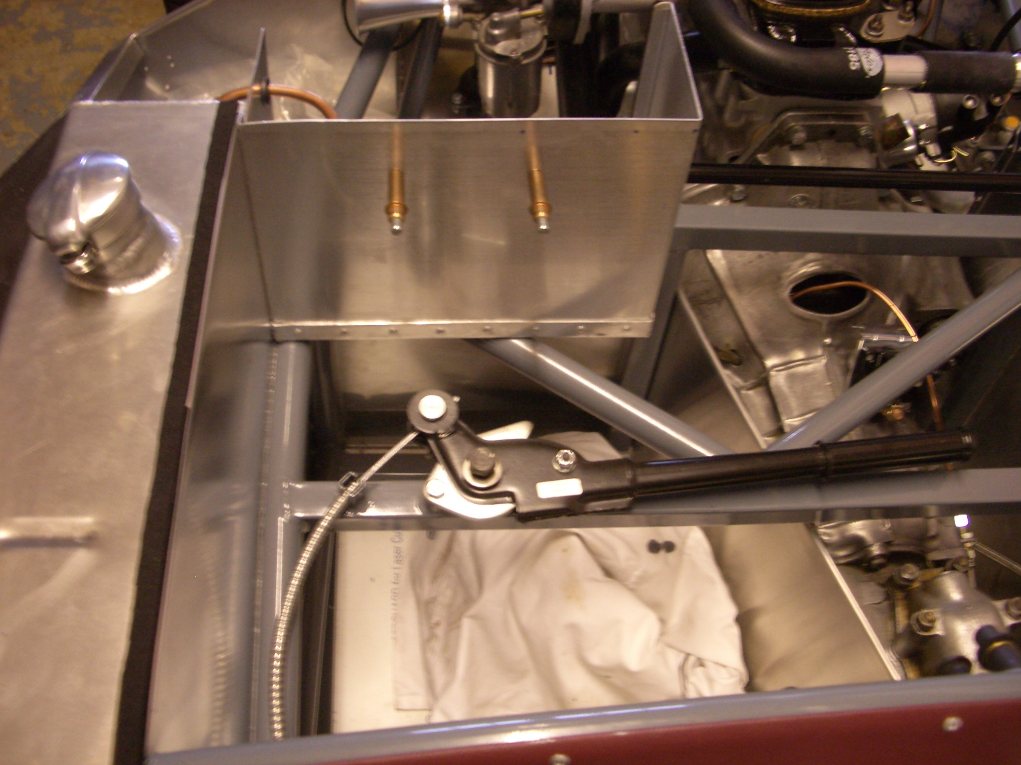

				beng4
 - Posts: 105
Okay this is how the handbrake should be mounted. It is an absolute sod to reach when seated, so wont suit IVA so I have now removed for the moment and used a small trigger handbrake lever by the tunnel. On an Xi the cable runs down the LHS pod. I sourced my cable and lever via Mike brotherwood, Im not sure and nor was Mike of the origin of the original levers.
Ben
