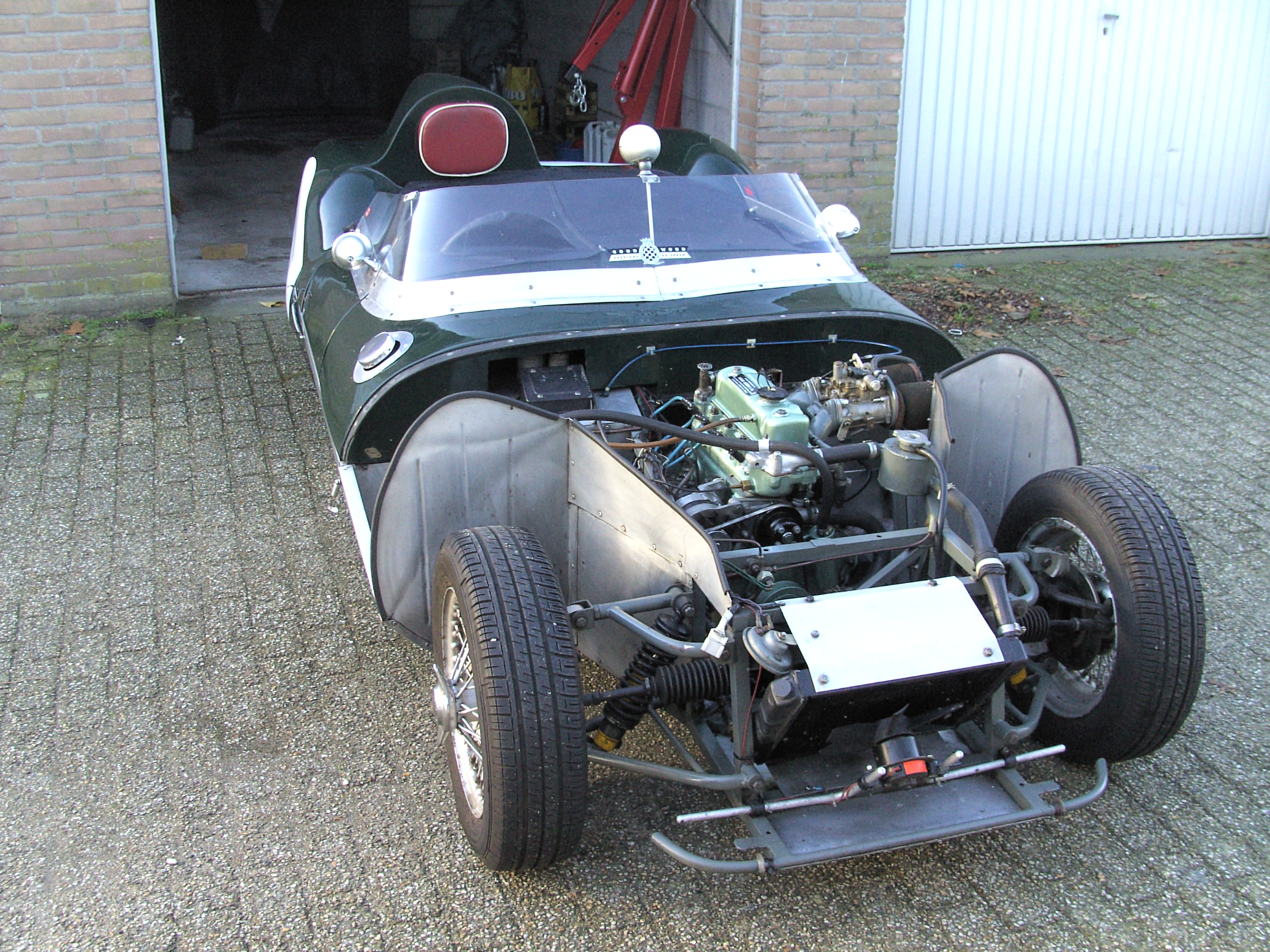

Time for an update on my progress.
Pictures say more than words.........
Charles, can you spot your sump?

Looking good Rene!! :D

" ER LÄUFT!!! " (it runs)
Started up the engine today. Had difficult time getting it started. ( Ig.-timing was way off )
Once it ran, it roard! Two ten minute runs at 1500-2000 rpm, to set the new cam.

one question, is there scope in your front suspension setup to dial out the positive camber or is it intentional?

It is possible to change the camber on my car. The "positive camber" on the picture is due to the picture (wide-angle lens)

Well done Rene! Hope it goes OK once the snow clears...
