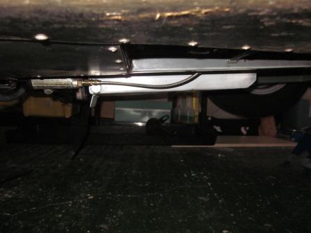

Here's a progress update:
If you think this'll be a 30 min job done on axle stands - think again!! :D
After seven hours of lying on my back on the garage floor with my nose 1cm away from the sump, I can assure you that you will be better off using a car lift and transmission jack (or similar).
I've got the sump dry-fitted with no gaskets. The oil drain needs to move as it will be fouled by the clutch slave cylinder if you wanted to empty the oil, and the backplate bottom bolts will beed to be reversed to allow clearance. Not a huge list for the first test-fit, I hope you'll agree.
I removed the dipstick pipe and anticipate it'll need to be shortened by about 30mm.
I'm going to get the car off the axle stands this morning and clean up the garage - I'm away with work for the next week or so, thus a small haitus.
I'll add some pics so you can see the improvement in ground clearance for yourself.

I would say that you have the same ground clearance there as I have with my dry sump xflow....
