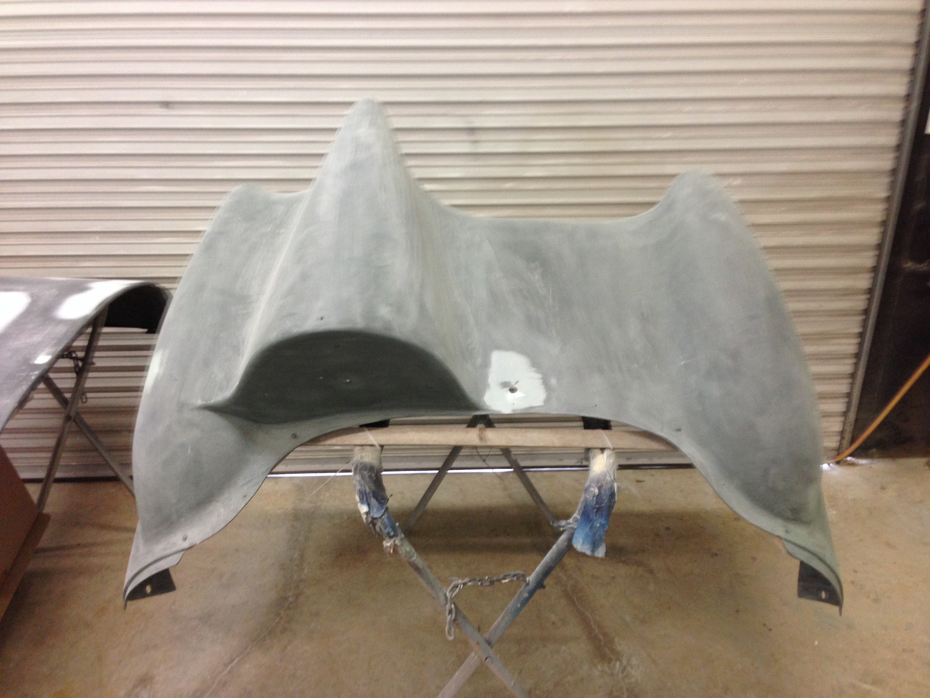

The improvements and repairs on my Eleven are progressing nicely: (PIctures attached)
Body is off and the doors had their first sanding, fairing and primer. This sequence will be done twice before painting. The rear bodywork and scuttle has been repaired and sanded. 1st coat of fairing primer is next. We sourced a small scoop to cover the hole that was cut into it with electrical tape put over it over to clear the fuel injection throttle body.
The seats, dash, headrest are in for re-upholstery. Once out of the car and inspected....well, let's just leave it that it won't be hard to improve on the existing workmanship of the initial installer.
The fiberglass bulkhead behind the seats and all of the plastic wheel well liners are being remade in aluminum. I should be able post some photos of those within the next 10 days.
We are finding a multitude of mechanical issues:
The entire front end needs to be completely re-bushed. I have 3/8" of play in the left front and 1/4" in the right. The bushings were not installed correctly. The ears on the suspension arms should have been clearanced with washers or spacers. Instead they were just bent in until they contacted the bushings, so there isn't even pressure against the perimeter of the bushing surface. Most have distorted and worn prematurely. Until we disassemble the front end, we won't know if the holes in the suspension arms have elongated from the wear. They amount of play we have indicates that's probably the case. I am hopeful we can dodge this bullet.
We pressure tested the cooling system and found four leaks. We found that oil was surging out of the dipstick hole and the breather in the front of the engine. "O" rings solved the dipstick issue and we are re-plumbing the breather assembly. We will be getting to the other leak sources next. We will also be doing a compression test and leak down on the engine this week. The condition of the engine oil gives us some concern about the internals. We have found a solution to the weak motorcycle throttle return spring...that was the only easy part. The wheels have been trued and new Dunlop rubber is mounted and balanced.
We stripped out the carpet kit and removed all possible panels for polishing outside the car. With the amount of double-sided velcro tape that was used in this car, you would think it was a structural element. Goo Gone and lacquer solvents wouldn't touch it. We've resorted to paint remover for epoxy finishes to get it off to avoid scraping and marring the aluminum any further. What a time consuming, pain in the butt this has been.
For your viewing pleasure, I have also put up a few photos of a Jaguar D type that came into the shop since I delivered the Eleven to them. If you look behind the Jag, you can also see my maroon Lola T70 on a lift. We are doing a suspension mod in the front and changing gear ratios out back.

Progress Update:
The interior has been completely polished and seats and dash are reupholstered.
New removable floor mats were made to protect the polished panels.
Fabricated, polished and installed aluminum edge trim.
Installed new aluminum back panel to replace tattered carpet.
Body is repaired, faired, block-sanded by hand twice between primer coats, and ready for paint. Hopefully, temperatures will rise enough in Texas to take that on next week.
Received a new complete chassis bushing set by DHL yesterday from Westfield in UK. They now have them back in stock. Fabricated our own bushing spacers for upper A arms to eliminate deformation of brackets
All coolant and oil leaks have been addressed and new fluids in place.
Wire Wheels are tightened, trued and balanced with new Dunlops aboard.
Exhaust system and muffler is out for new ceramic coating.
New throttle return spring system installed to alleviate hypersensitive throttle on motorcycle fuel injection
Installed clutch pedal stop
New wheel wells fabricated from aluminum are complete and ready for installation.
Single cockpit body work on order from Westfield
Pictures of interior attached....should be done by Christmas.
Glenn

I was never really enamored with the fuel injection on your car, even though it worked better than any of the others I have tried. The throttle body is a little large (hmm, a lot large)... Perhaps a machined venturi behind it would help with the low end, wide open throttle, response. Given that small problem, the thing works pretty well. The A series breathes only two cylinders at a time (less than 700cc total), so a little carburetor goes a long way. The "motorcycle" throttle body is nearly twice the size of the venturis of a 45 DCOE throat, properly sized for the cam and compression of your engine. Great for top end power, though. The system might respond favorably to a longer intake manifold.
The cylinder head could use a bit more port work as well. My cylinder heads from Longman have 37.5mm ports, bored straight through, with smoothing down stream at the bulkhead between the valves. The APT head you have is quite efficient, though. Excellent low end response.
The spring might help with the throttle sensitivity, but the throttle linkage ratio is the real problem. You may have to re work the linkage to slightly slow the response, and then get another joint in your ankle to get full throttle... Most of us just get used to the throttle response. It takes a few miles of driving, but it's not that hard to do. 'Better than corrective ankle surgery...
When you put the chassis back together, you can mount the double adjustable Protechs upside down to ease chassis setup, and keep the adjusters and spring collars clean and easy to reach for adjustment and corner weighting.
Nice job.
