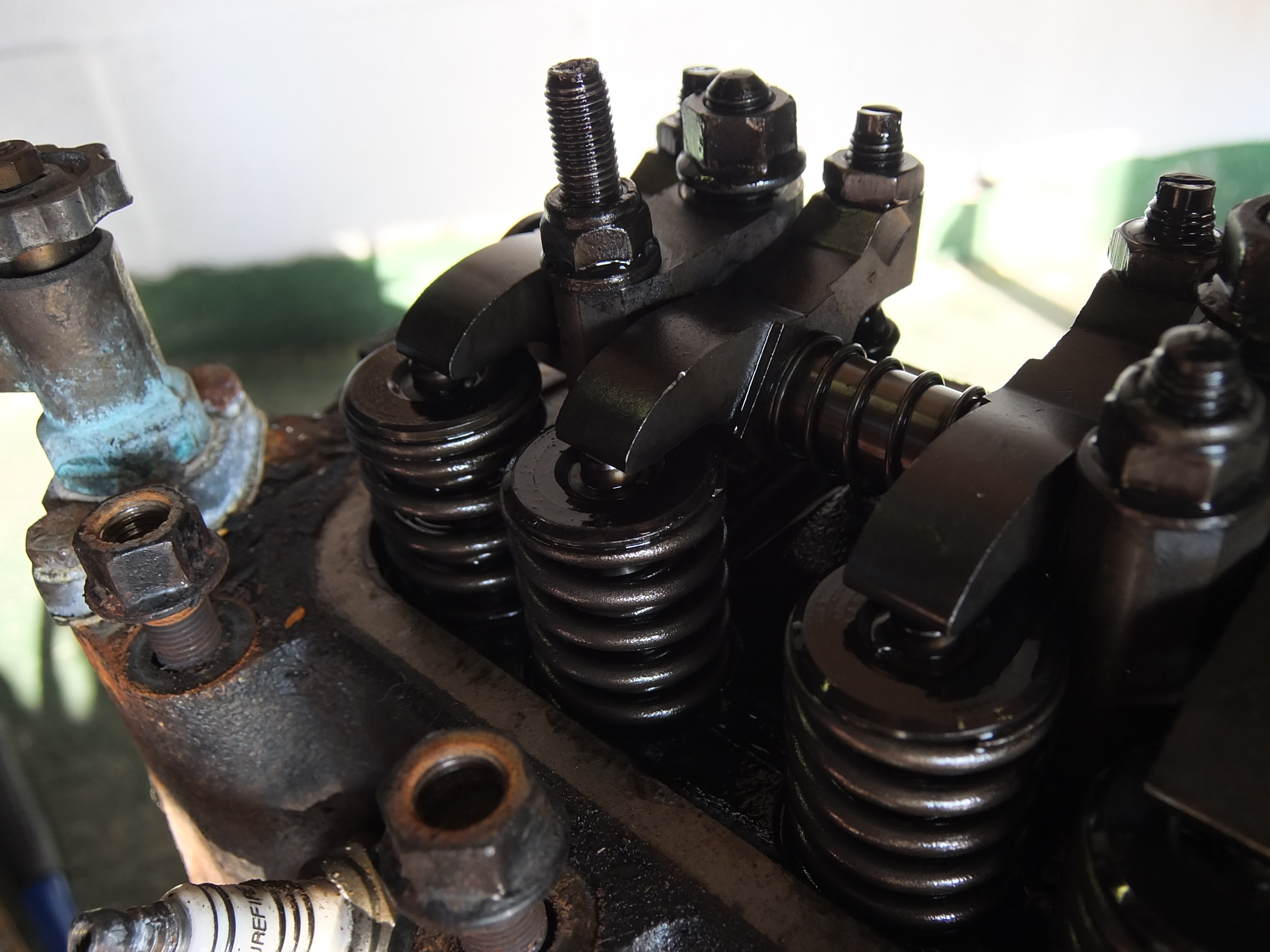

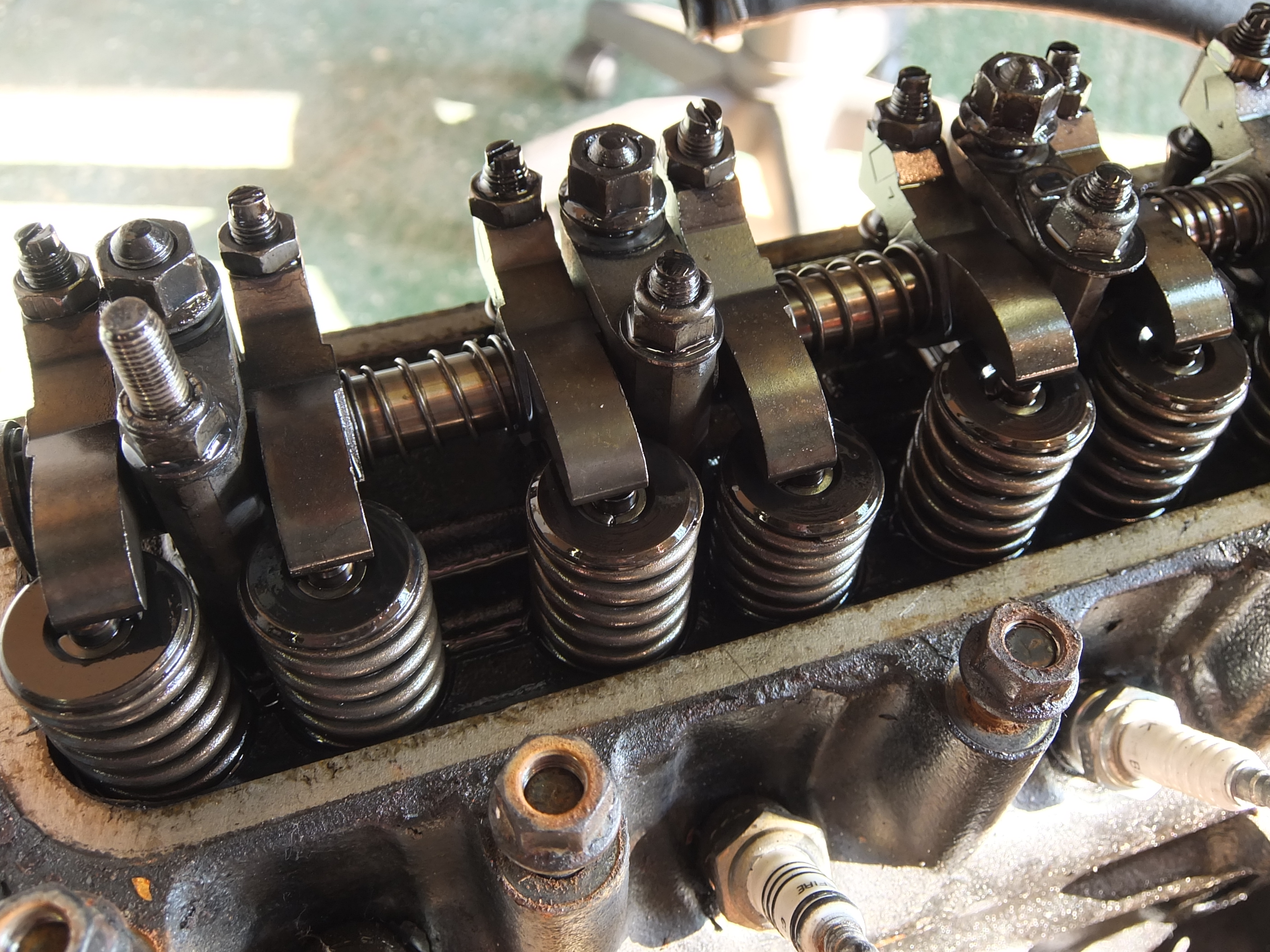

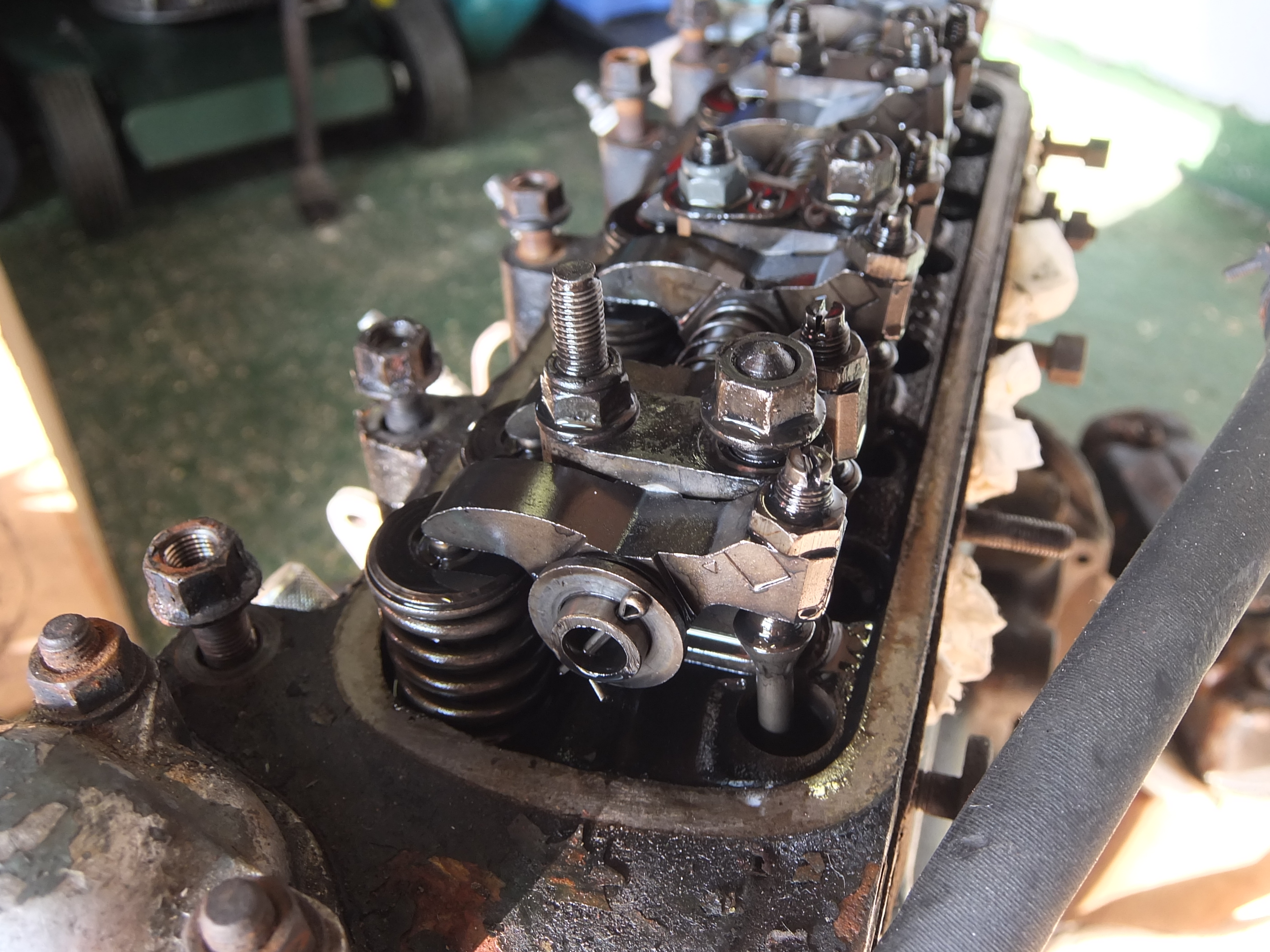

I decided to have a quick squint at my donor engine (the one out of my Project X Midget) and got all excited to see solid rockers under the cover.  All the other rockers I have on my XI engine or spares bits are the pressed steel items.
"Ooooh, forged!", I thought.  "Maybe got an EN40 crank in there - it is a '68 after all...".
But, it is a rebuilt engine (I knew that, and obvious by the engine number), so the chances of that are slim.
Seems I have sintered rockers from the A+ Series (and very late A Series).  Maybe Mini items.  Slightly less than 1:1.25 lift, apparently.
