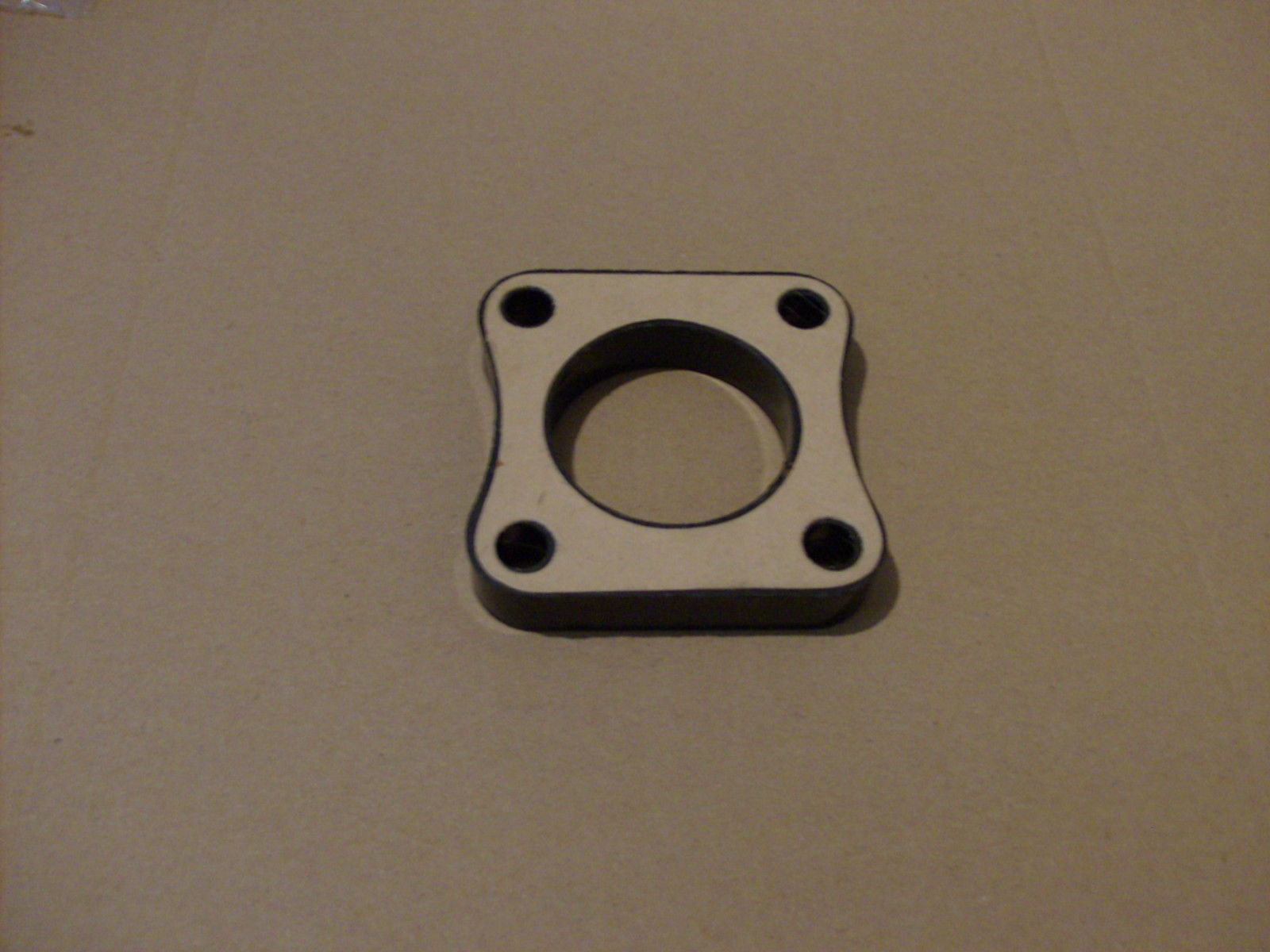

Jon, do you need the spacer betwen the manifold and the carb?
From tne pictures it looks like the fit would be better without it but I don't know what the function of the spacer is so something more important might be worse!
Posts: 1031

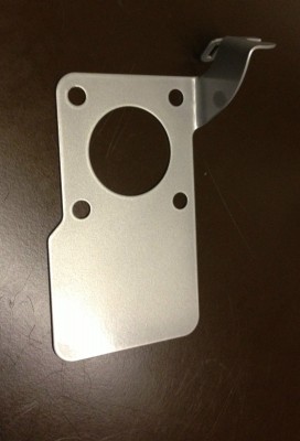

The carb integral float bowl needs to be away from the exhaust manifold. I have a heat shield on the way. I'll try a dry fit without the spacer, but the onger inlet tract = more torque.

Jon, would be great to know if it fits without the spacer as my carb doesn't have the spacer and I am hoping it will fit.
roughly what is the clearance between the bonnet and the top of the cylinder head?

I have around 5 to 10mm clearance with that low profile filler cap. Edit to add that I will check the clearance without the spacer when I have a moment, but the spacer may be necessary for best performance.... and reduced chance of vapour locking! :o

Also to add, Chris, that I picked up my spacer new from eBay. Ditto the heatshield.

You will need the spacer, as the throttle linkages foul on the inlet manifold. I''ll get onto Maniflow and ask them about producing a Westfield XI spec manifold.

I have a new, custom, HIF44 manifold in the back of my car. Plus a repaired exhaust manifold which needed a little blob here and there.
The new model has a slightly longer inlet tract than th estandard Sprite. The straight design just clears the exhaust manifold. Should with with the spacer and heatshield. I'll try to check this out tomorrow AM. :D
