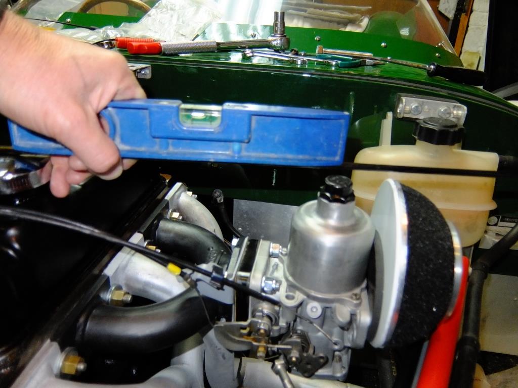

Hi All,
I have a heat-shield/abutment plate as pictured.
Good news is that the flat manifold gives around 10mm lower height than the filler cap (that misses the centre of the bonnet now).
The bad news is that the K&N oval filter just snags the chassis rail by atound 5mm. Solution? A conical filter will work, but the K&N ones are offset (the wrong way!). I'll call K&N to see if they do a non-offset filter. Either that or try the Pipercross filter.
Finally, and more economically, I have a Pipercross rampipe. It's anodised ally and will probably be perfect with an ITG foam sock over it. The total for that set up is around £25.
Edit: got to be a shorter ram pipe. Photo later....
Run out of time.
Taraaa
Posts: 1022
Answer: Yes!

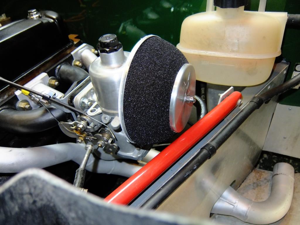

I've been tied up, what with an impending house move and conversion course. However, I have persevered and I present to you the Maniflow Westfield XI custom manifold with Pipercross filter. A K&N cone should also fit, but I haven't tried it.
Pics tell the story. Exhaust will be bolted on tomorrow. Bloody hell, it's getting close and I hope it works!! :D
Posts: 1022
The filter foam needs to come of if I'm to use the extending bonnet stay. It's a minor detail...
I think I have around 15mm clearance. My blu-tac telltale certainly didn't get squished!
There is also sufficient clearance from the abutment place and manifold.
Top tip - assemble the carb to the inlet manifold first, then install. Saves a lot of fiddly work. I also used a 10mm heatshrink on the bolts to make then snug with some compliance through the inlet and carb mounting holes.
What do you reckon? 600bhp?? :D

Posts: 1022
Hi Daggers,
There is no specific reference. It's a "flat" Spritget HIF44 item. Though if you imagine the mounting plate hinged at the bottom and swinging out to vertical, rather than hinged at top and swinging in. That means the inlet tract is slightly longer, but this ensures it clears the exhaust manifold OK. The Maniflow guys reckoned that they could use mine to set up a jig if there was a run of orders, but it's a simple alteration....
