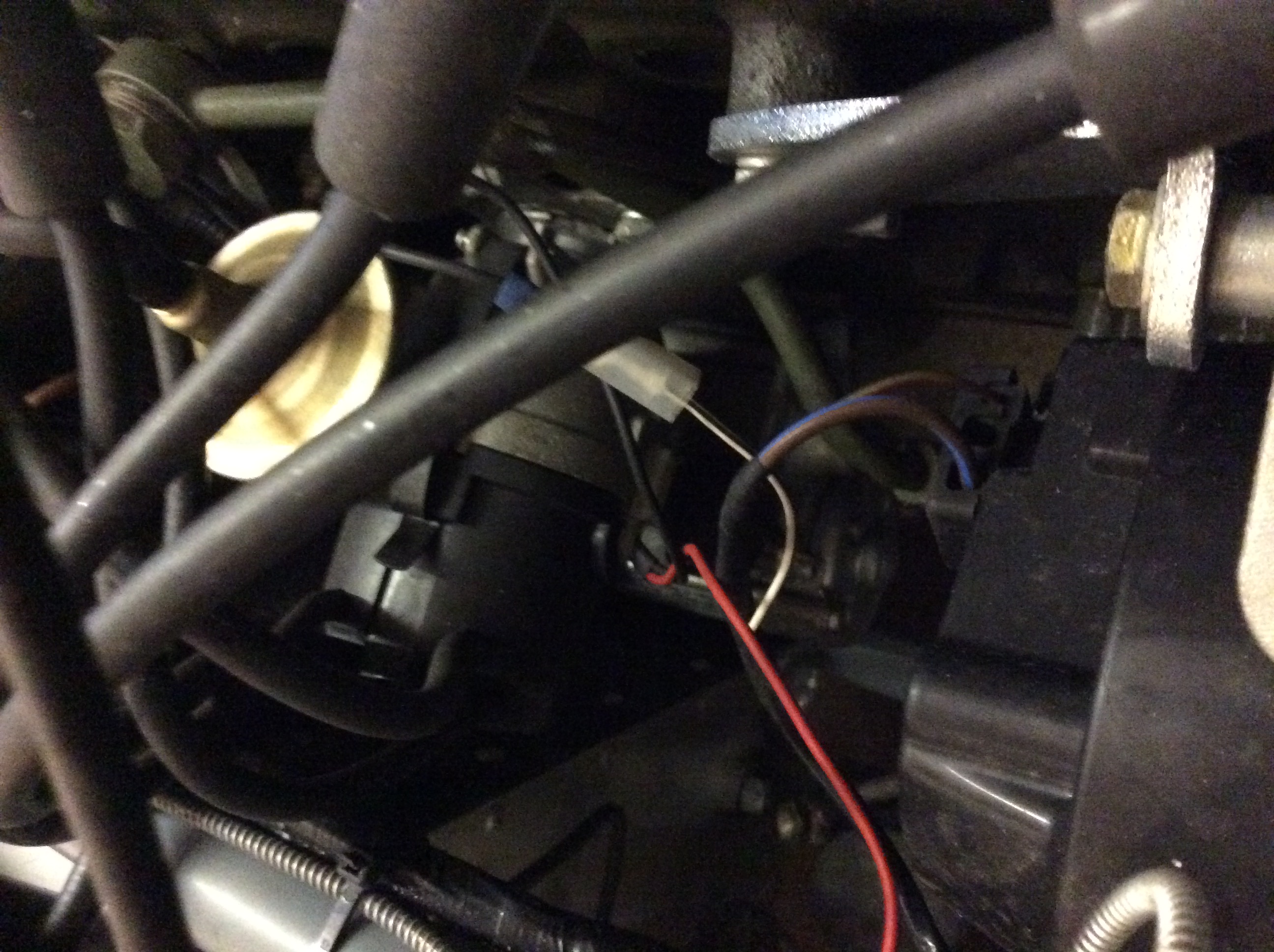

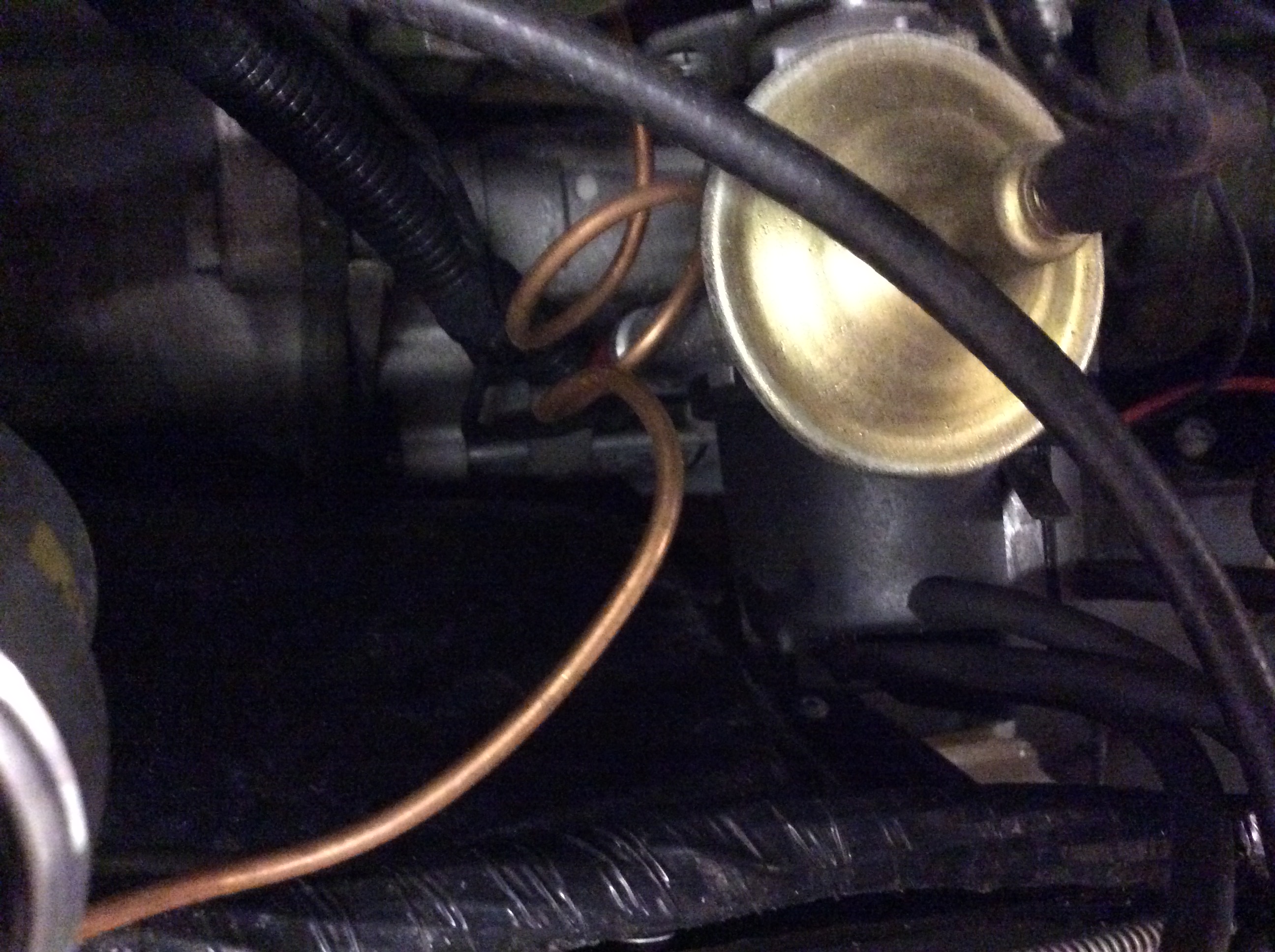

distributor cap fitting - did you have t cut the footwell?

Do you want a pic of mine we moved engine forward slightly
M400too

Re: distributor cap fitting - did you have t cut the footwel
This is mine but as I said my engine has been moved forward a smidge
looks like you managed without cutting the footwell but your cap is different with the leads out one side where as I have leads out both sides ( looks like mine is from a montego or something ). how tall is your cap ? If yours is taller than mine I don't think I have the space but if it is the same or lower than you have found the solution and I won't have to start cutting again.

You dont' have to cut the footwell.
I have built 3 RHD chassis and have had sufficient clearance for a side exit distributor cap for all of the late chassis examples which have the plastic footwell side panel. It is a tight fit, for sure. but the cap does fit, without any contact, and wont be knocked off the distributor on a hard shift. Remember, the cap has to be fitted to the distributor AFTER the engine is in the car. You should be able to remove the cap, rotor and remove the distributor from the engine with the engine installed. It's a tight fit, but it does come out with the clamp. I fit the distributor to the engine after I put the engine in the car.
Check that the distributor clamp is fully engaged on the distributor body (as far up as it can go), and that the distributor is fully home, as well as the distributor drive gear properly installed into the engine.
I selected a non vacuum distributor, as I run a big Weber, and there is not enough vacuum to even make the vacuum advance work. This gives a bit more clearance around the distributor. I also eliminated the main oil line between the block and the oil filter mount by connecting my oil cooler to those lines. This gave a much cleaner installation, and a lot more room to adjust the timing or to R+R the distributor.
USE A SIDE EXIT CAP, ALL LEADS ON ONE SIDE. This will help with clearance. Your current cap has leads where you need space.
Also, make sure that the timing mark is at TDC on cyinder #1, and that the distributor rotor is aligned with cylinder #1 in the cap (this could be any of the contacts. You just have to know which one). All this helps to get the cap in place, and make it relatively easy to remove. It is important to check the position of the distributor drive gear with the engine at TDC (both valves closed). The correct position is shown in the engine manual. Note that the gear notch is wider on one side, so that the distributor goes in only one way. This is important.
Of course, given the difficulty of removing the distributor cap, it is imperative that a Pertronix Ignitor or other magnetic trigger is installed to replace the points. This eliminates distributor maintenance and re adjustment of the timing once it is properly set.
Make sure that the engine is where it is supposed to be. Rock it into position (you might be surprised as to how much extra clearance you can find). Check to make sure that you don't have a washer in the wrong place (a washer under the engine mount can cause all sorts of distributor cap fit problems).
looking at it again it might be better to re-order the leads on the cap shifting them one place so the body of the dizzy is 90deg different and my leads come out top/bottom not side/side as current. It looks like the "one side" entry caps are taller and I don't think I have the space I certainly can't get the dizzy out with the engine in place (my brake pipe routing turns out to be "unfortunate" and takes up space that it turns out you need) and i can't yet work out how to put the cap on with the rotor on and i can't get the rotor on with the cap on so it will be cap in place and dizzy in before the install and engine out for any ignition work.
That's the wrong dizzy cap! The distributor body should drop into its hole when the engine is in place, but not with it's cap on. The cap then clips into place with no modification of the footwell side wall, albeit with only about 10mm clearance and can then be rotated to the correct orientation. The correct Midget cap has all five leads exiting on one side only. Looking at your first post, it appears that you have a 45D distributor (the later type) and need one of these:
http://www.ebay.co.uk/itm/Classic-Mini- ... SwLN5Wl5Zp
As the seller states, you discard the securing screws and use the original spring-clips to secure it. It'll fit straight on instead of what you have and should cure your woes with no further work required.........
i will order up a new cap and see. bit worrying that i don't have the space to take the dizzy out in car when others do. I will give that a more serious go too.
