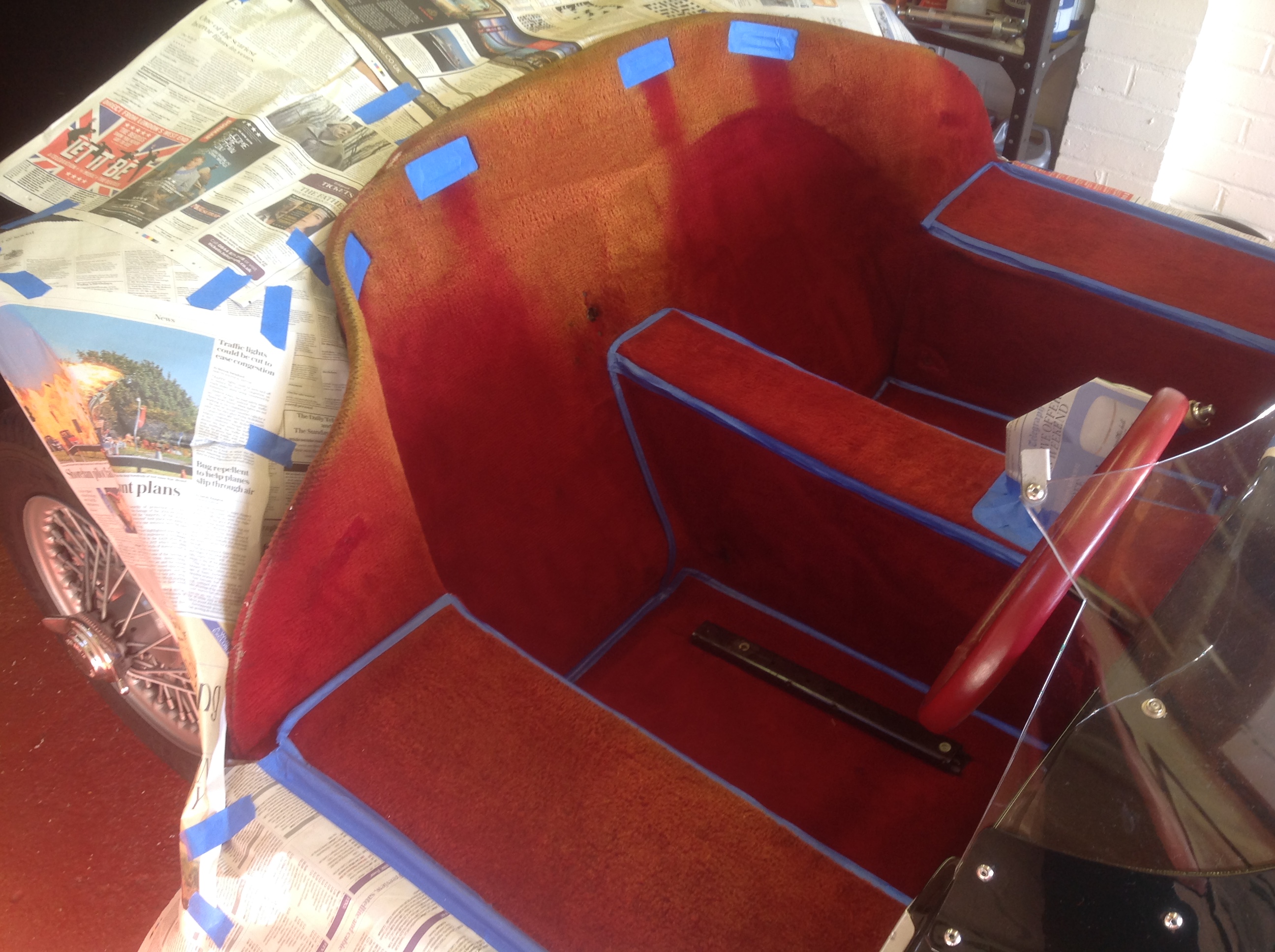

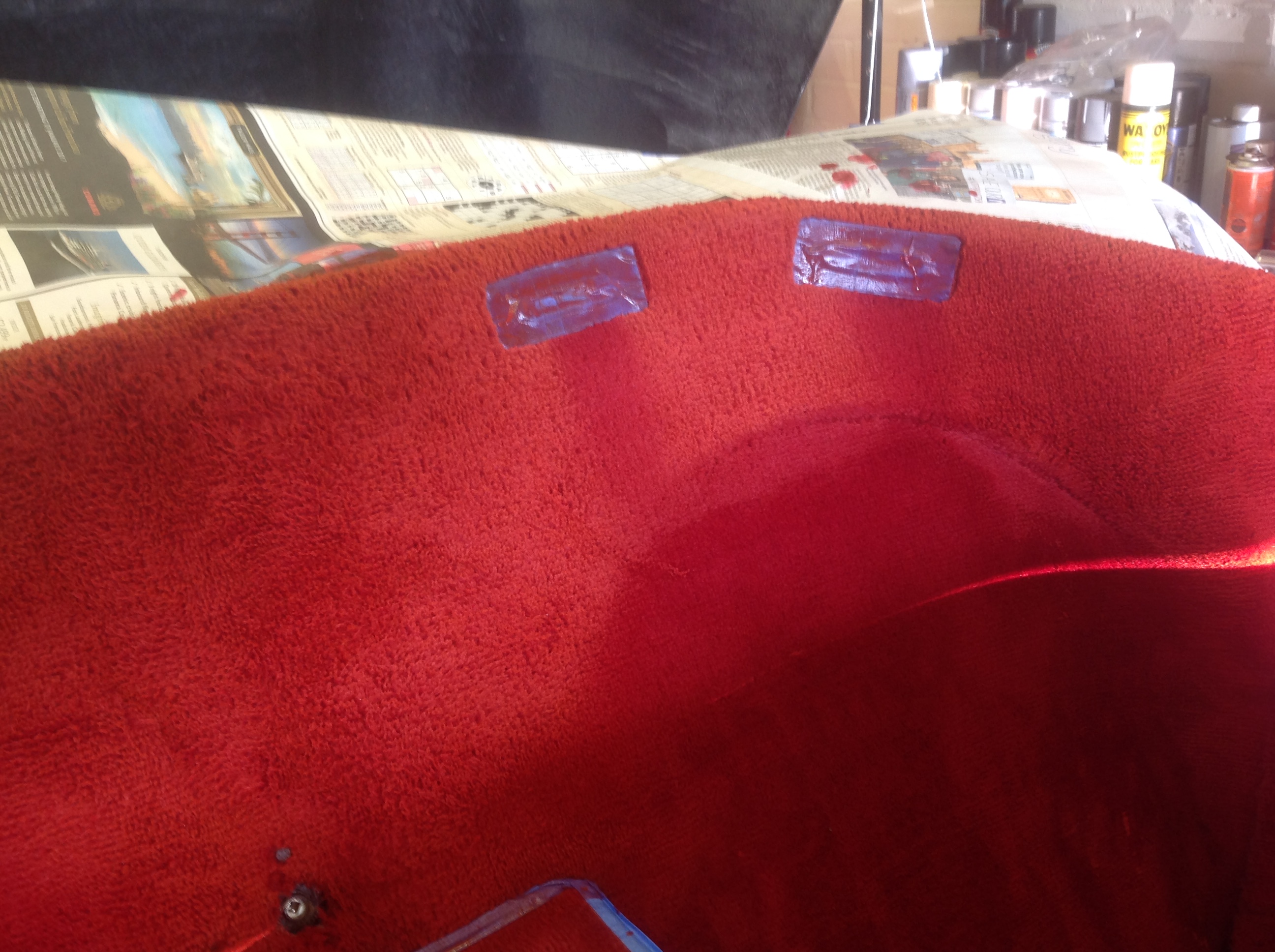

You might note that it's not just the rear bulkhead that's in poor shape. All of the horizontal surfaces had been bleached to some extent or other. So I thoroughly washed the carpet and masked all of the vinyl in preparation before applying dye:
Re: Polishing my tiny............car!
The initial results were highly encouraging:
.....and I used all 1.5 litres of product (1 litre of dye and .5 litres of wetting agent) on the faded rear bulkhead and the horizontal surfaces:
The water soluble dye took a day or so to dry, eventually leaving the carpet well covered, but "crispy". So I decided to give it a light "Vax" to soften it up again:
Yup, it washed straight out. You can dye both wool and nylon, but not acrylic fibres. Guess what Westfield use? So.......

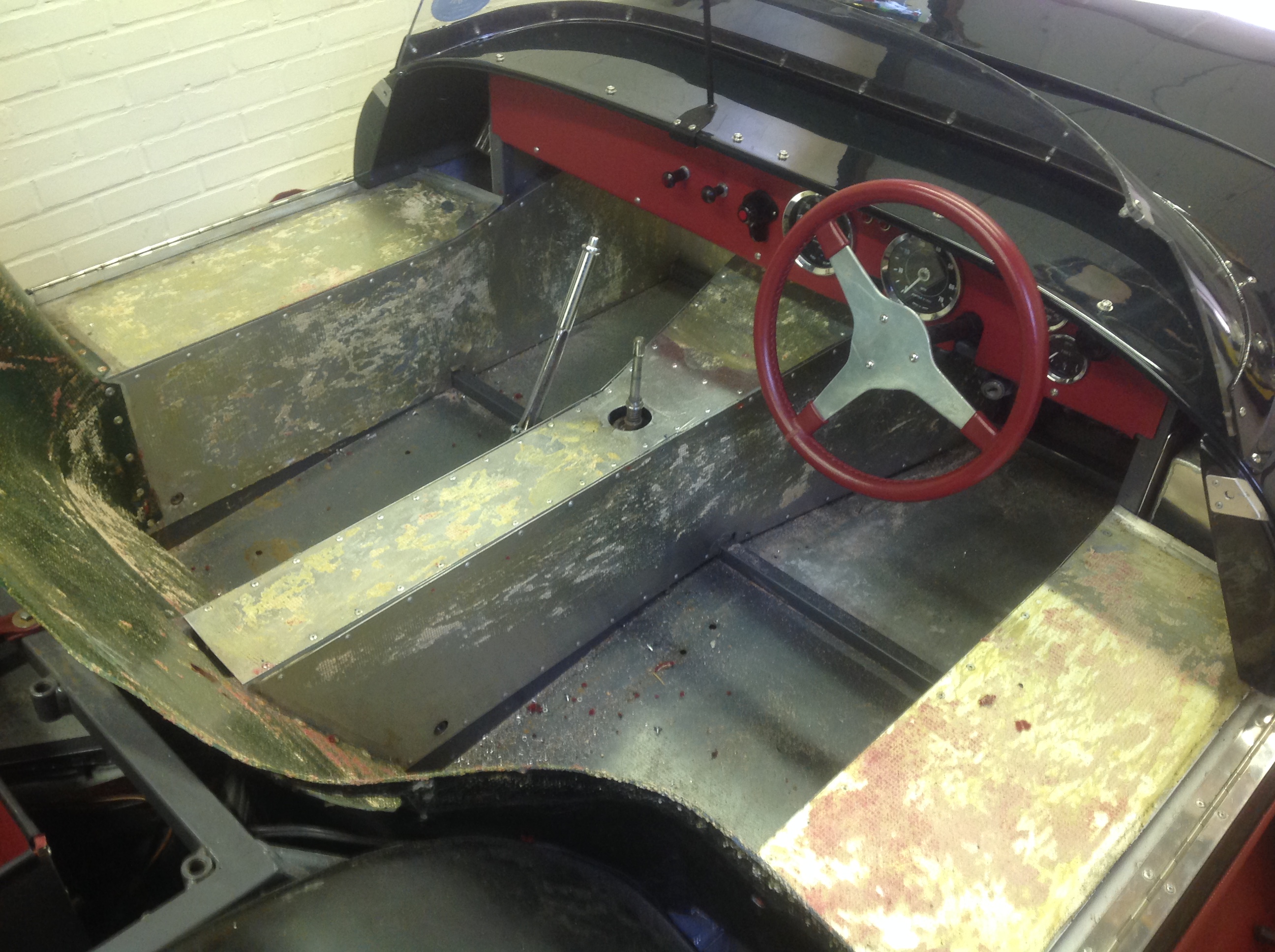

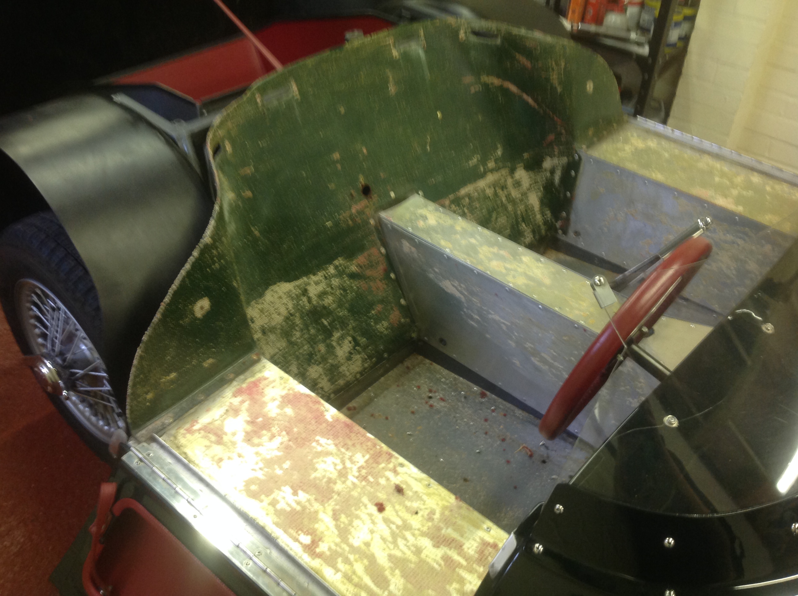

I wasn't going to glue the new carpet directly over the old glue, so I set-to with Nitromors paint stripper:

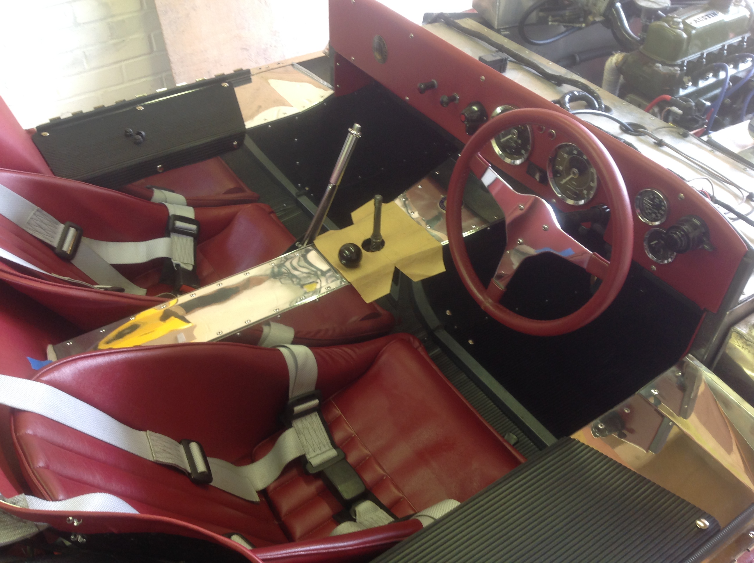

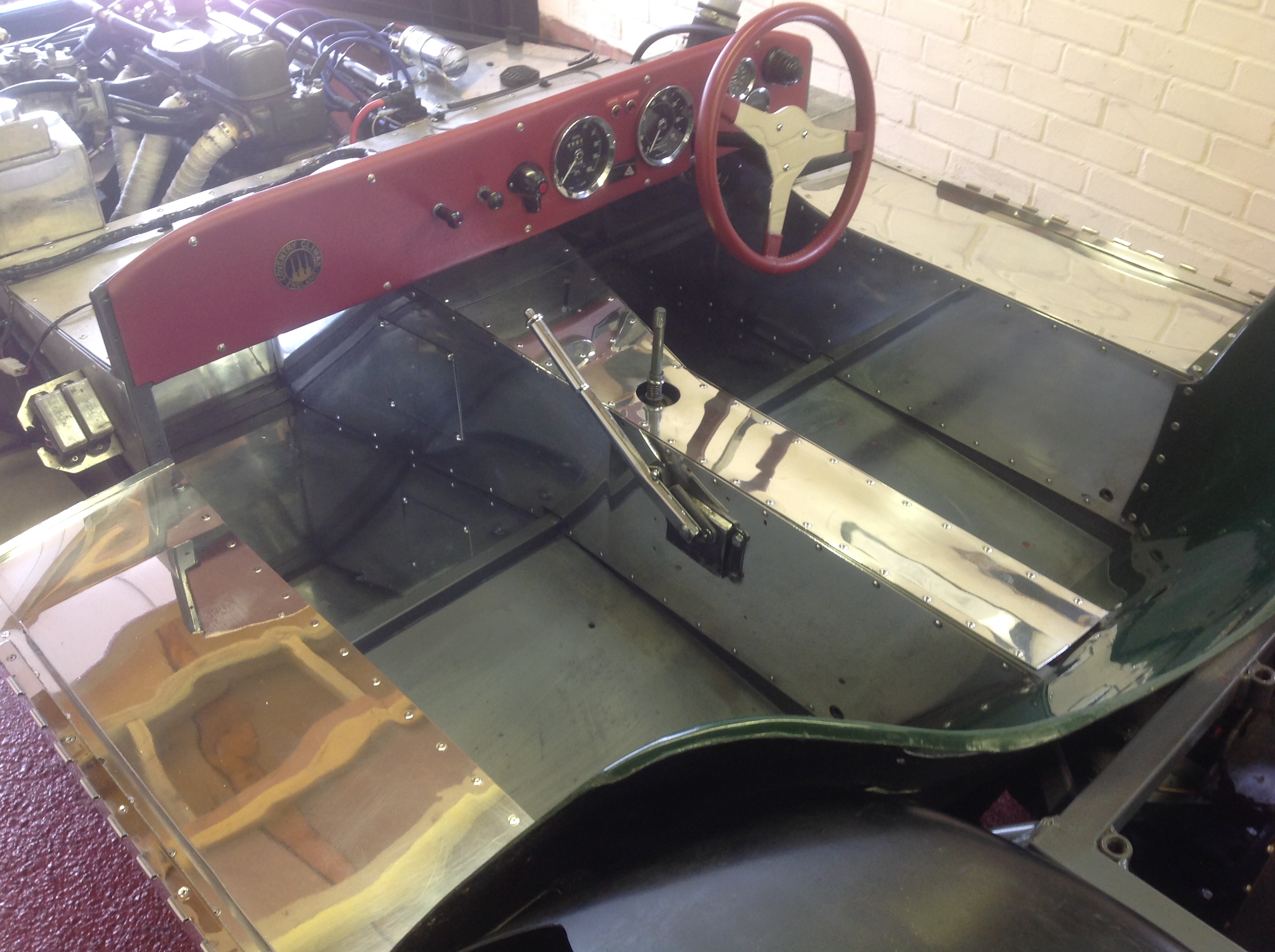

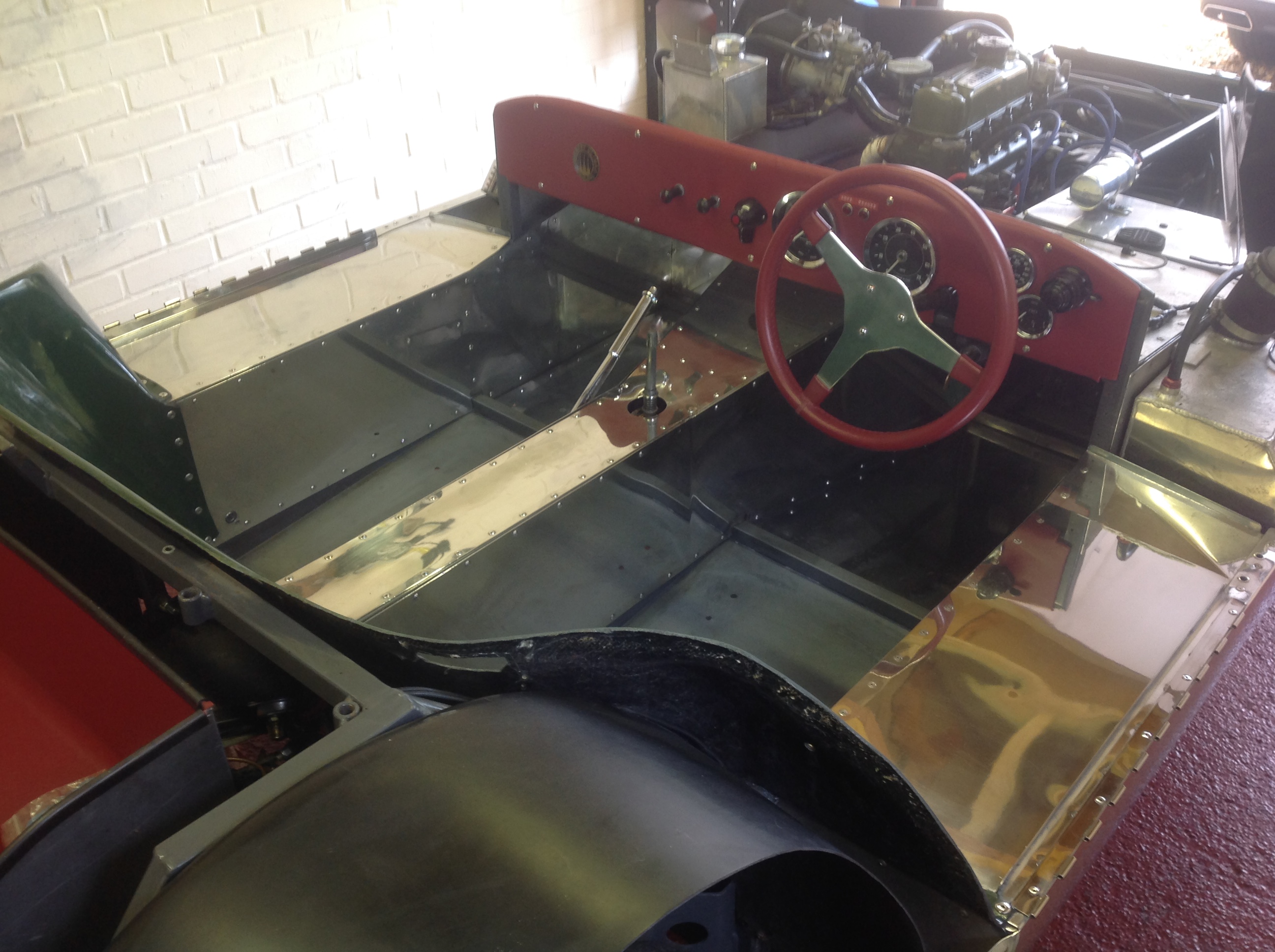

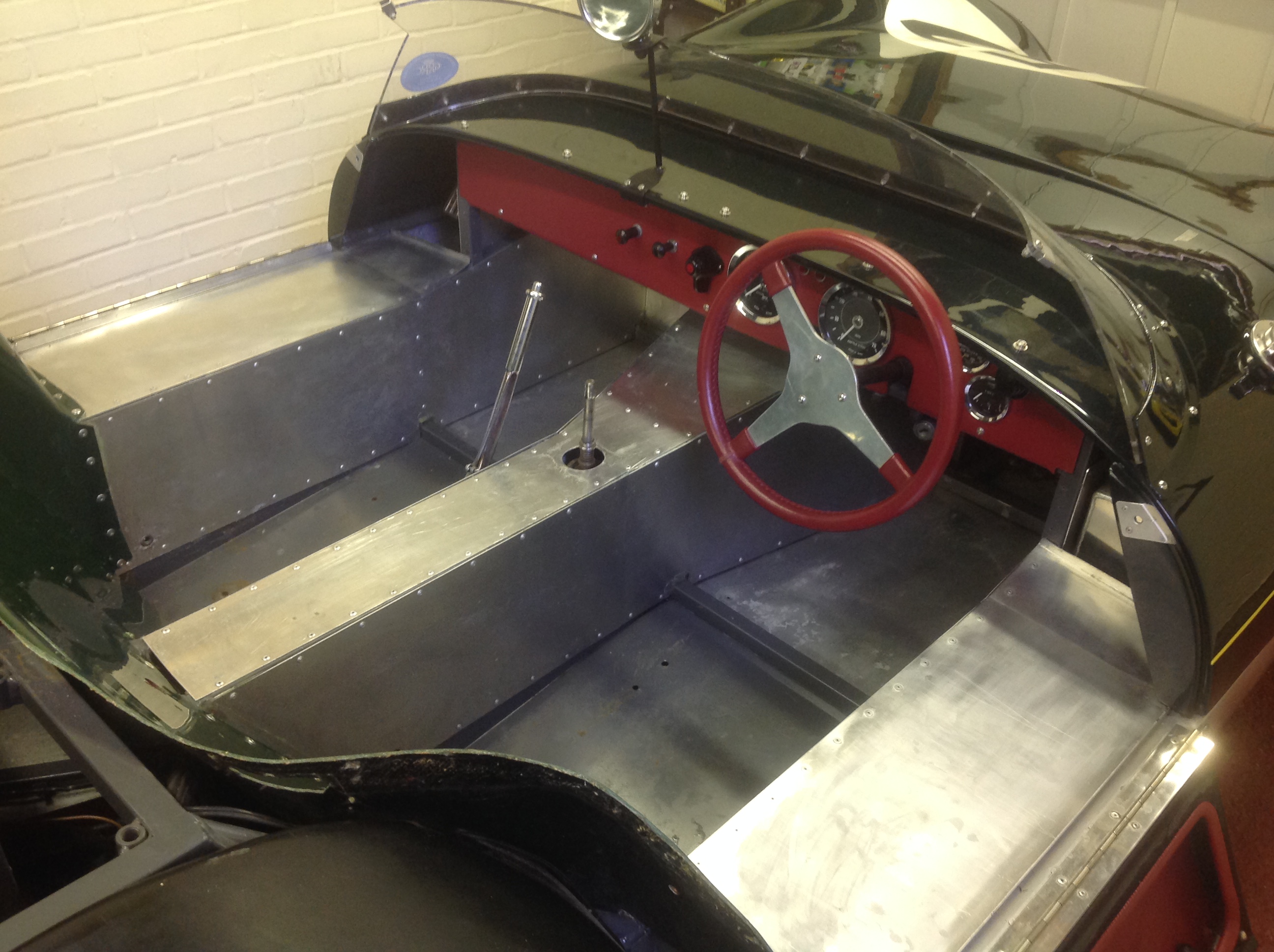

Hang on a mo. That's not looking too bad, is it? Lots of hard work with steel wool removed the worst of the scratches and I did a bit of research into aluminium polishing using power tools. Namely a household drill. Four full and very exhausting days in the garage later (thankfully in three stints separated by days at work to allow muscle recovery) and I had this:

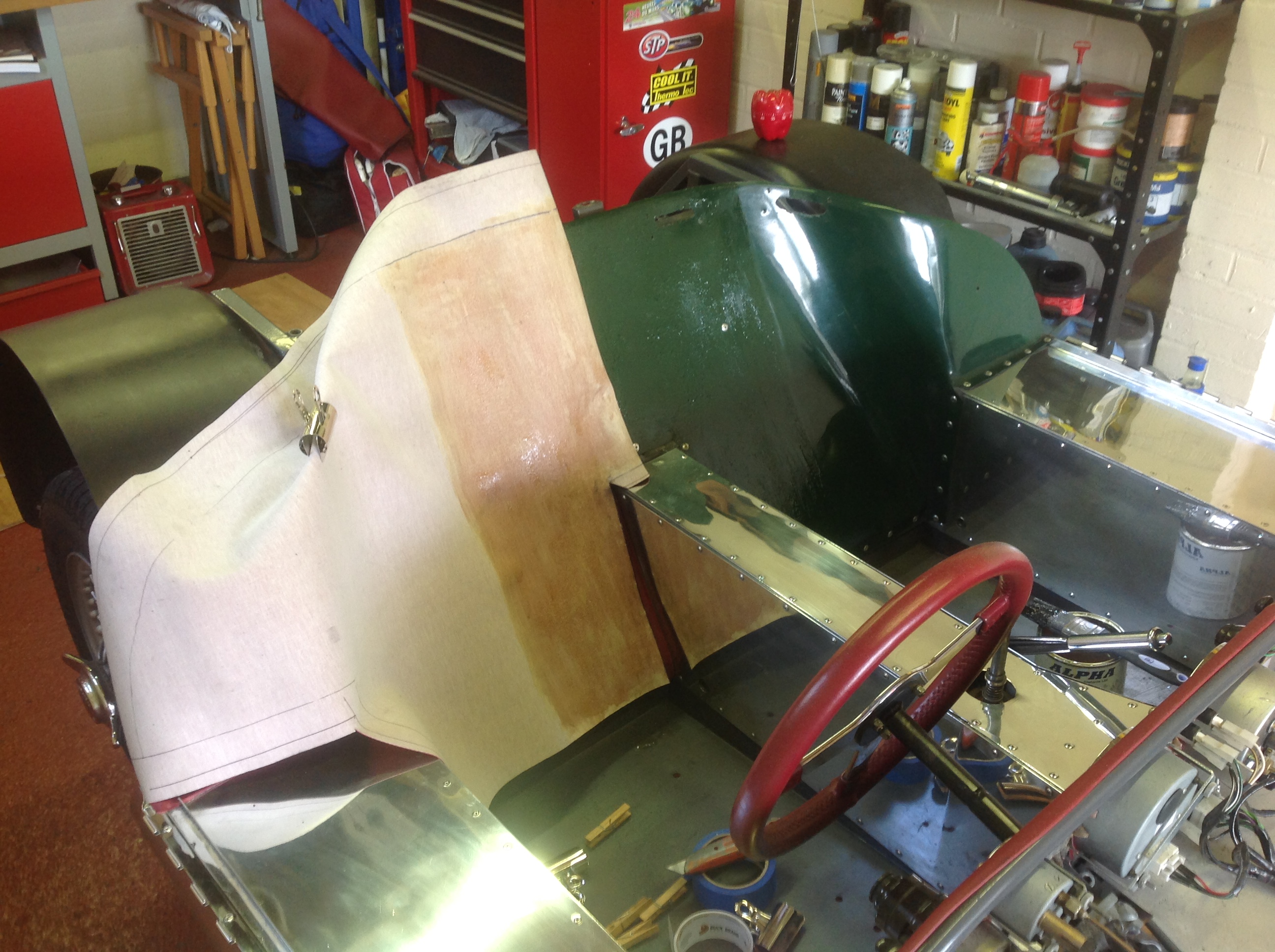

As for the re-trimming, that came together remarkably quickly. The rear bulkhead I covered in the same vinyl as the dash, seats and door cards:

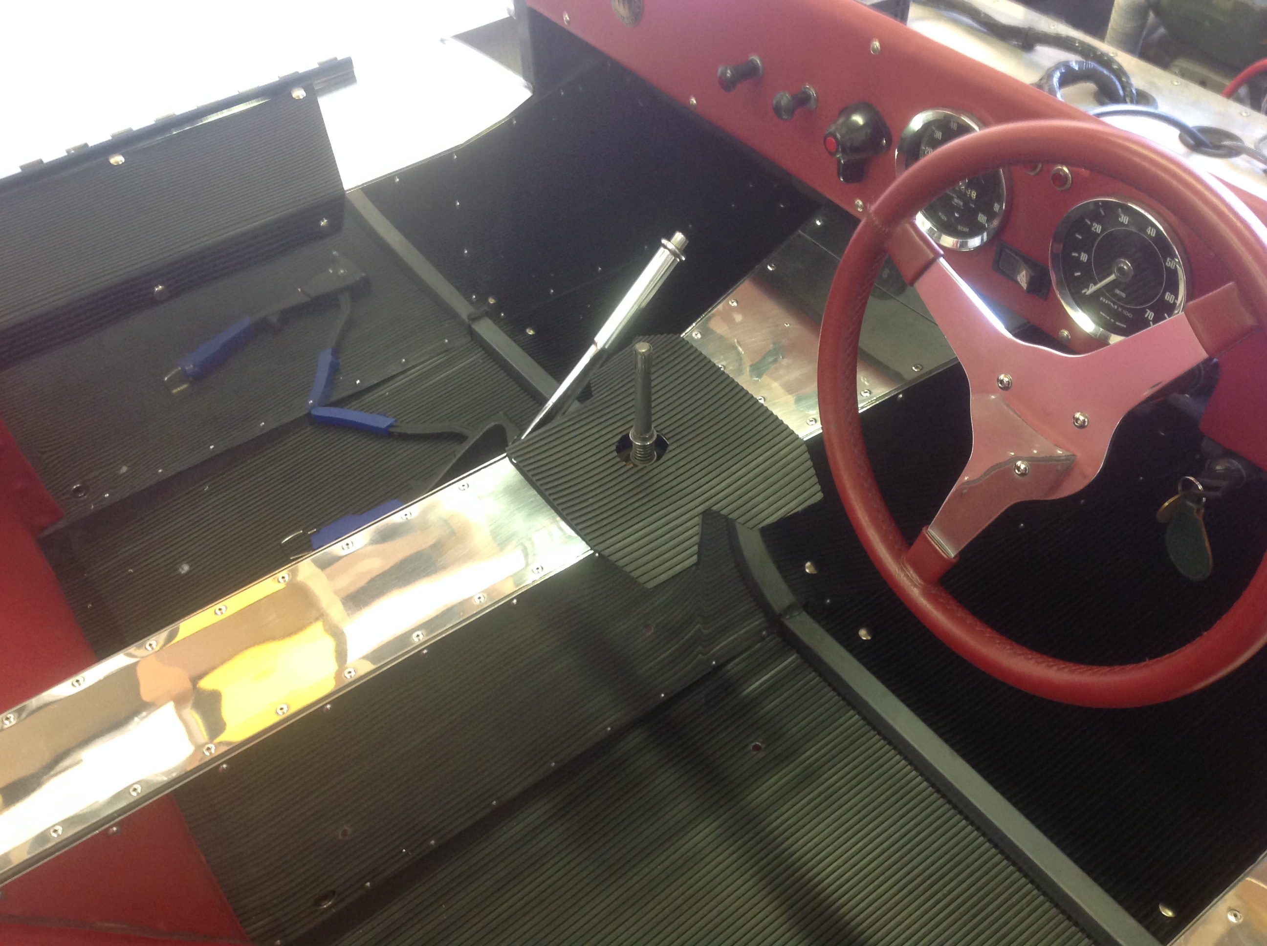

The floors, passenger footboard, sills, handbrake mechanism and gear lever surround are ribbed-rubber matting from Woolies, held down (and easily removable) with press studs:
