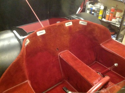

You might note that it's not just the rear bulkhead that's in poor shape. All of the horizontal surfaces had been bleached to some extent or other. So I thoroughly washed the carpet and masked all of the vinyl in preparation before applying dye:

.....and I used all 1.5 litres of product (1 litre of dye and .5 litres of wetting agent) on the faded rear bulkhead and the horizontal surfaces:

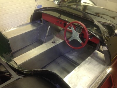

I wasn't going to glue the new carpet directly over the old glue, so I set-to with Nitromors paint stripper:
Re: Polishing my tiny............car!
Hang on a mo. That's not looking too bad, is it? Lots of hard work with steel wool removed the worst of the scratches and I did a bit of research into aluminium polishing using power tools. Namely a household drill. Four full and very exhausting days in the garage later (thankfully in three stints separated by days at work to allow muscle recovery) and I had this:

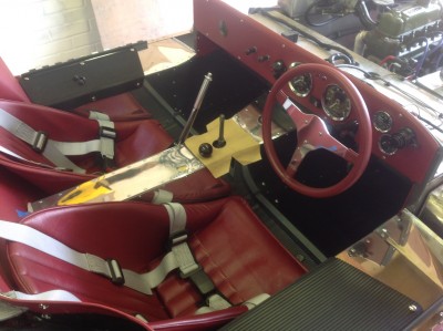

As for the re-trimming, that came together remarkably quickly. The rear bulkhead I covered in the same vinyl as the dash, seats and door cards:

The floors, passenger footboard, sills, handbrake mechanism and gear lever surround are ribbed-rubber matting from Woolies, held down (and easily removable) with press studs:
