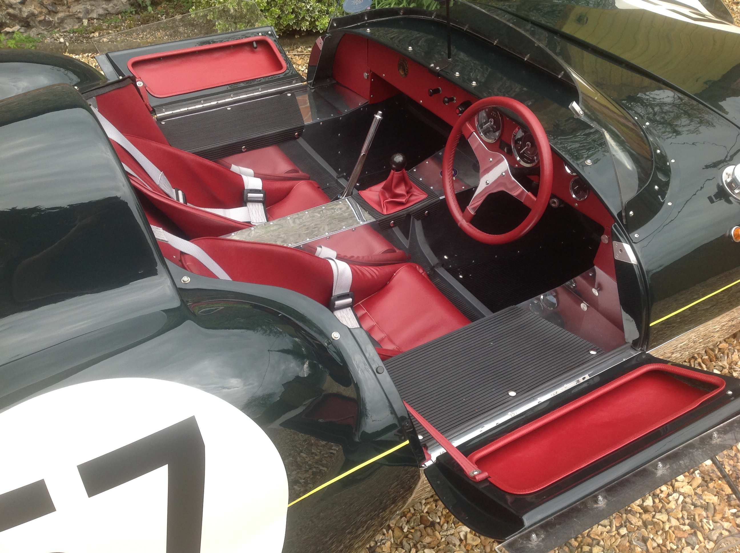

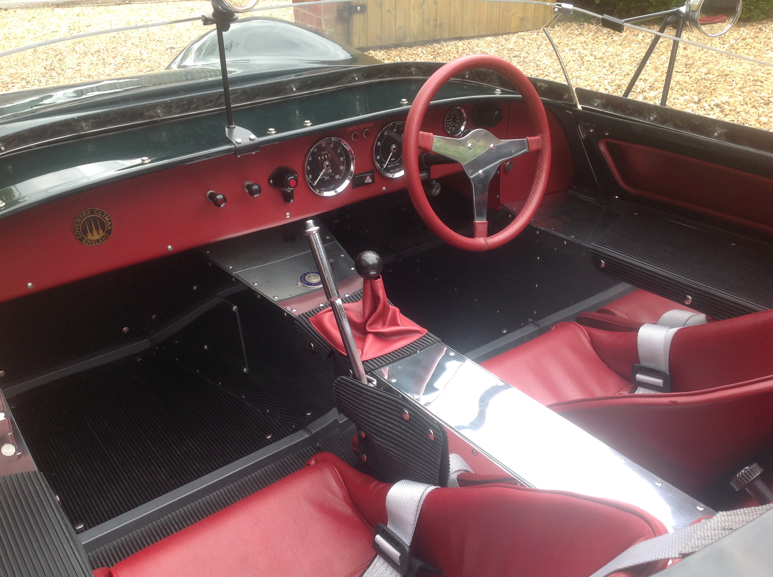

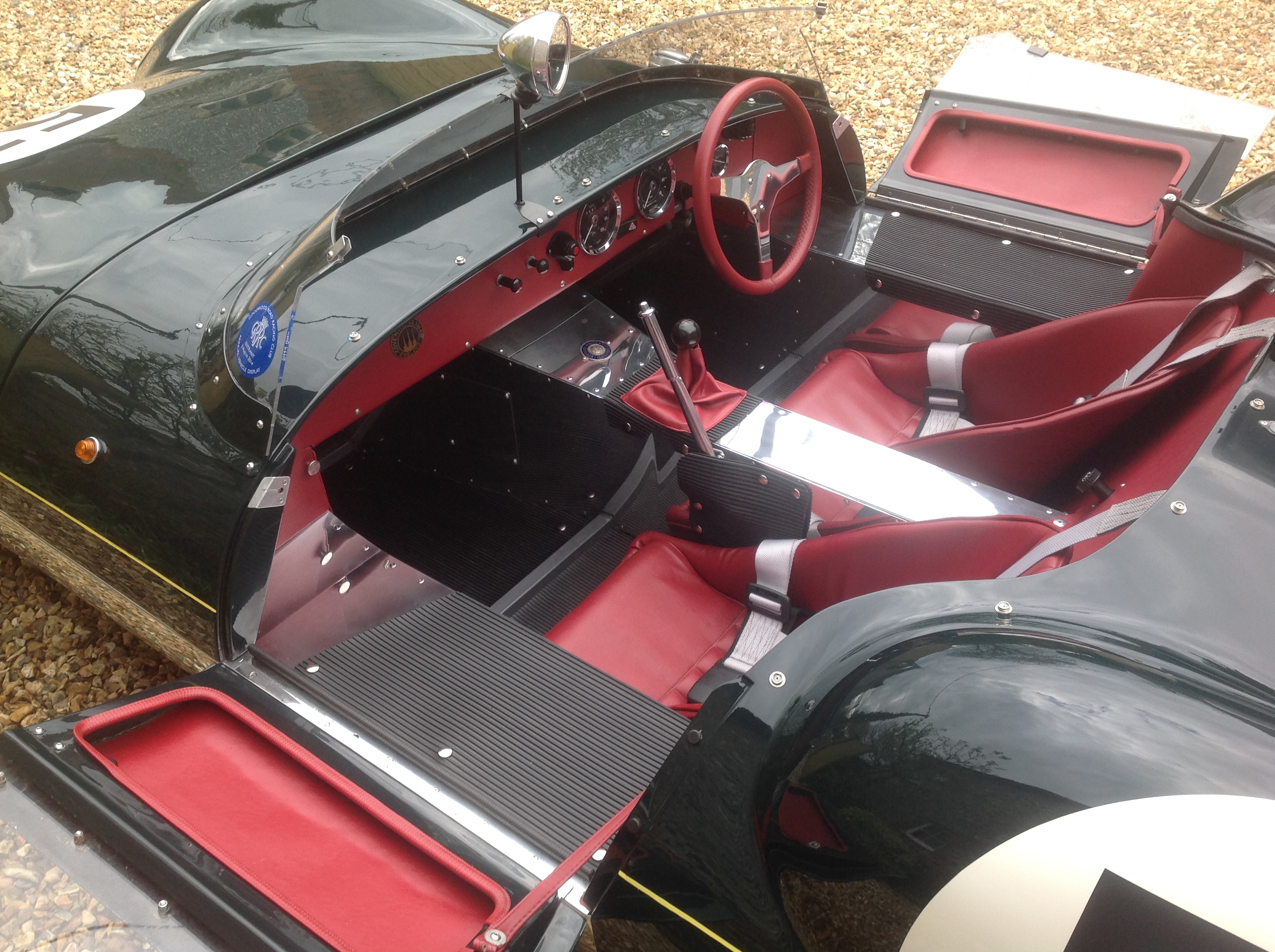

The only thing that I had to farm out was the gear lever gaiter, which was turned around in 24 hours by a local upholsterer. Hard, metal lined trim covers the carefully re-profiled lip of the bulkhead to prevent the fibreglass from chaffing through the vinyl. I hope that you like it.....
Re: Polishing my tiny............car!

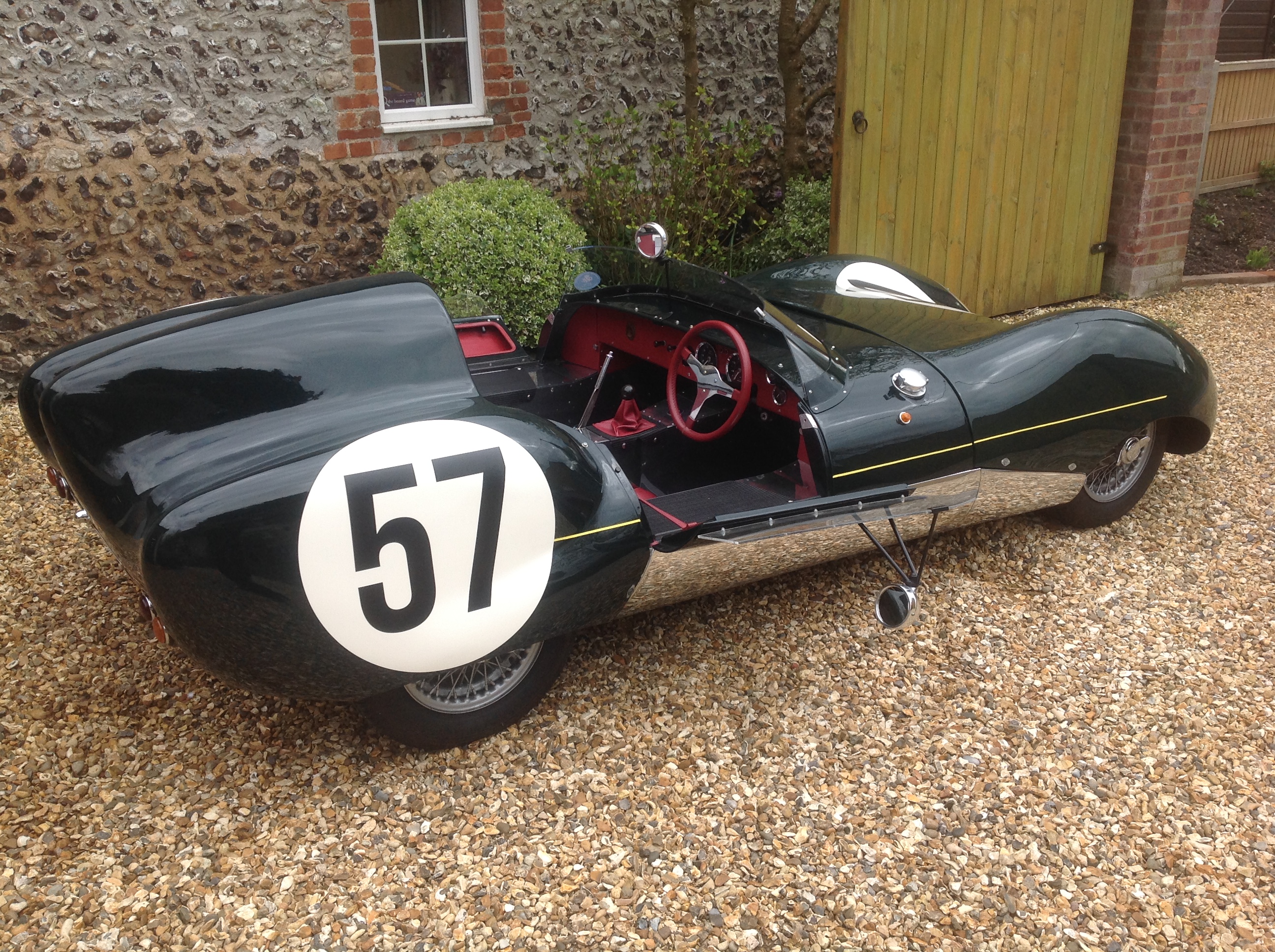

(You might have also noted that I polished the outer sills whilst I was about it!)
