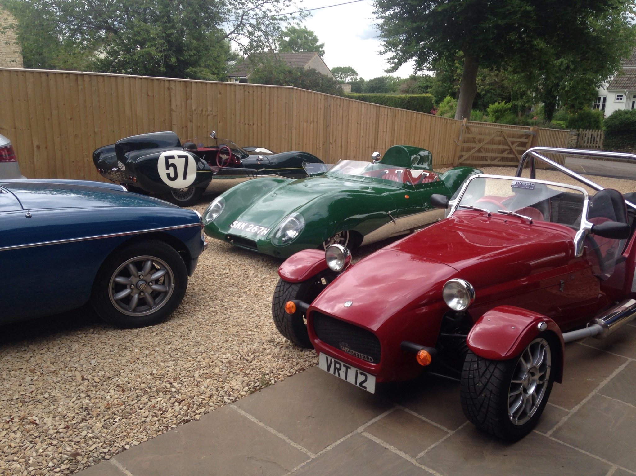

We took the four cars (that we're taking down to the LeMans Classic) for a spin last week. One hundred miles in rather changeable weather! Even without the cloudburst it was comical how period-correct Jon's lighting was. Both his tail lights and indicators were almost unnoticeable. Of course, when I commented on this, I was informed that mine were exactly the same! Ken, with his recently rebuilt MGB, was running with LED bulbs in all his secondary lights, and most effective they were too.

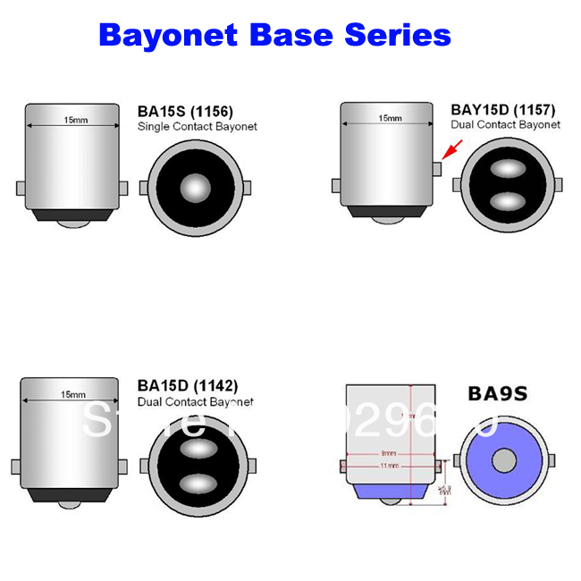

The Eleven (or, at least my later car with hazard lights) uses a slightly unusual flasher relay. Whilst looking like a common 3-pin relay, one is earth. The pins are labled 31, 49 and 49a. It's not so easy to find a regular relay in this config, let alone one suitable for LEDs. After a bit of hunting around, I found just one supplier in the UK. I also bought most of the bulbs from him. His diffused amber indicator bulbs and red tail/brakelight bulbs are really bright and "smooth", by which I mean that the light output is cohesive, appearing to come from a single conventional bulb, rather than an array of LEDs. Basically, it looks "standard" but much brighter! To help decode the bulb nomenclature see the attached diagram at the foot of this post. Indicators are usually BA15s, and tail/brake lights are usually BAY15d.

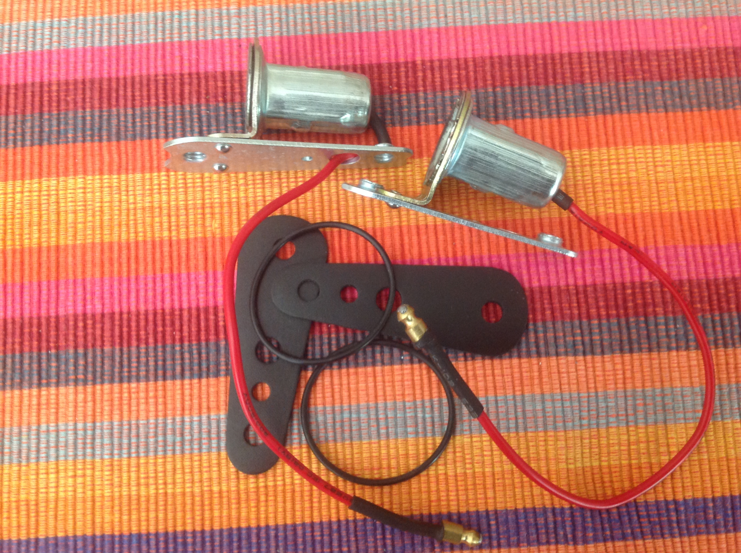

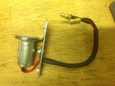

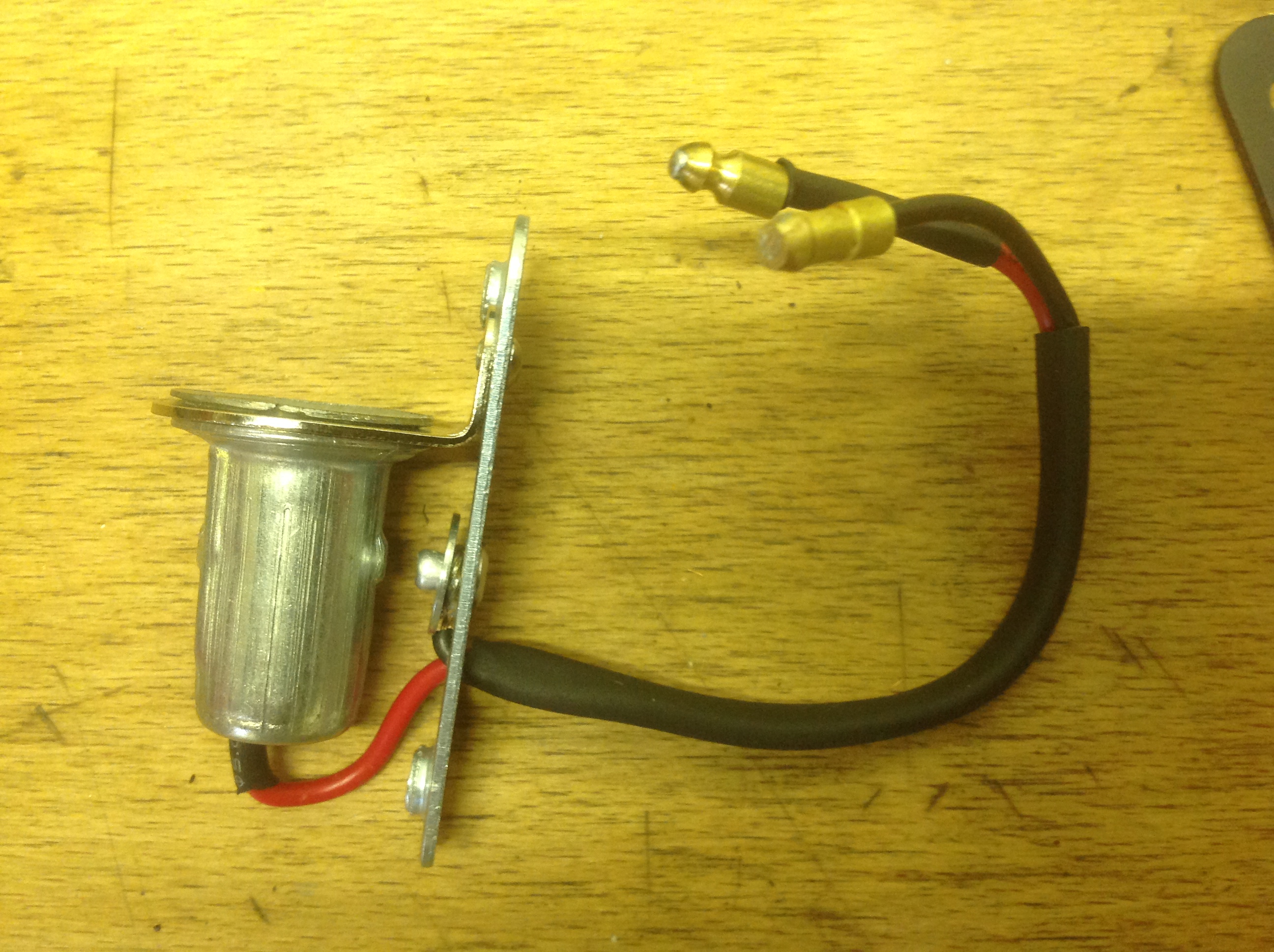

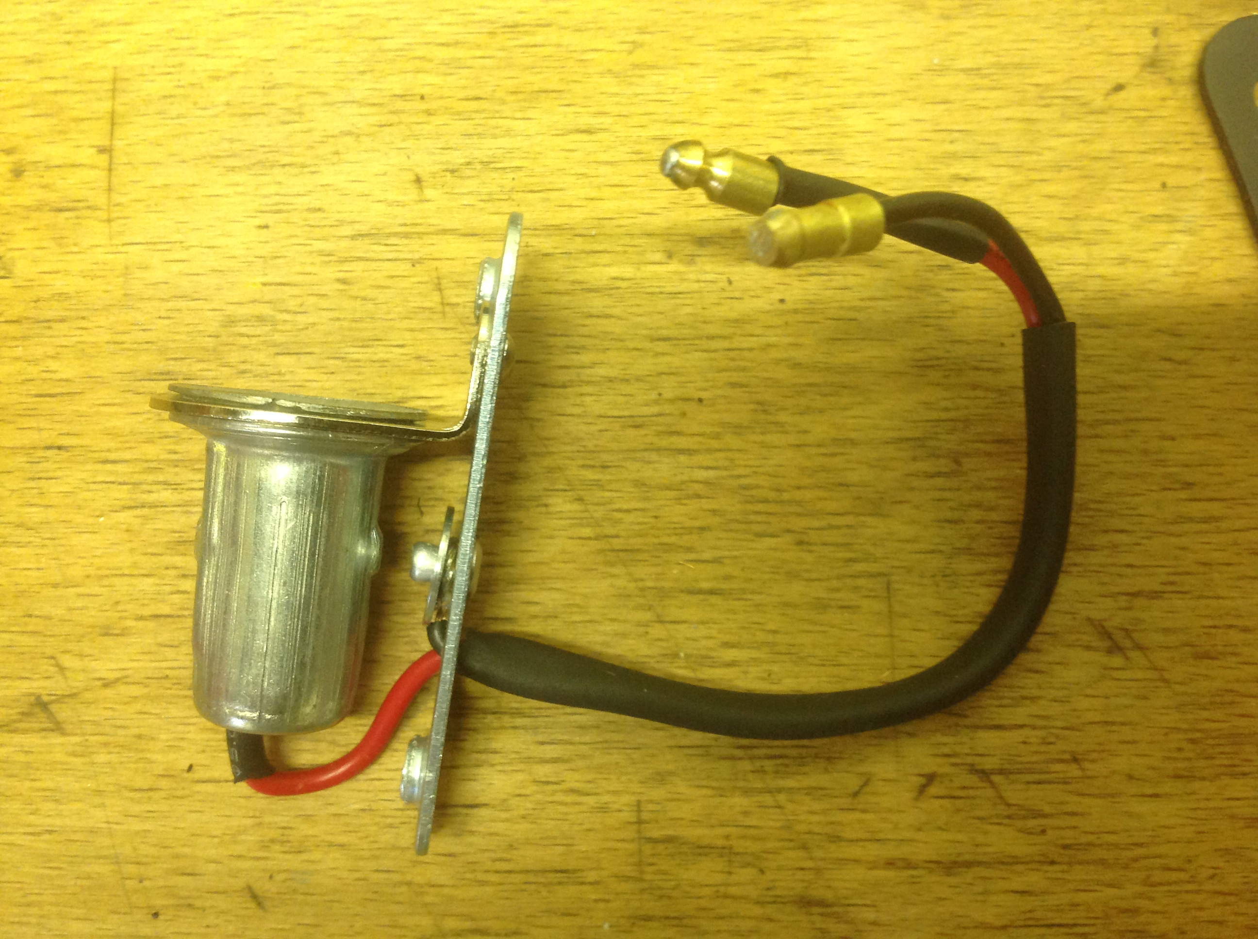

Because my front indicators are mounted in Lucas 1130 sidelight units, originally designed to be combined sidelight/indicator units, the standard bulb is a 21w filament bulb with a BA15d fitting. Diffused amber LEDs are simply not available in this fitment. In fact, the only LED bulbs that I could find with BA15d fitment were SMDs, and once fitted behind the amber lens they looked quite wrong.
The recourse was to change the internal bulb holder of the 1130 unit to BA15s. They're available, but I couldn't find many stockists. I bought mine here (and not only was he the cheapest, but delivery was next-day):
http://www.vintagemotorspares.com/page6.htm
They only have a positive lead, but fitting an earth return was very easy. They're now installed, with diffused bulbs from the source in my first post. Once again, it looks totally original but much brighter.
