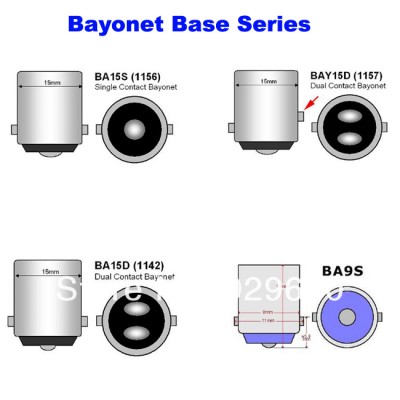

The Eleven (or, at least my later car with hazard lights) uses a slightly unusual flasher relay. Whilst looking like a common 3-pin relay, one is earth. The pins are labled 31, 49 and 49a. It's not so easy to find a regular relay in this config, let alone one suitable for LEDs. After a bit of hunting around, I found just one supplier in the UK. I also bought most of the bulbs from him. His diffused amber indicator bulbs and red tail/brakelight bulbs are really bright and "smooth", by which I mean that the light output is cohesive, appearing to come from a single conventional bulb, rather than an array of LEDs. Basically, it looks "standard" but much brighter! To help decode the bulb nomenclature see the attached diagram at the foot of this post. Indicators are usually BA15s, and tail/brake lights are usually BAY15d.

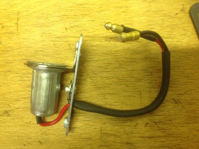

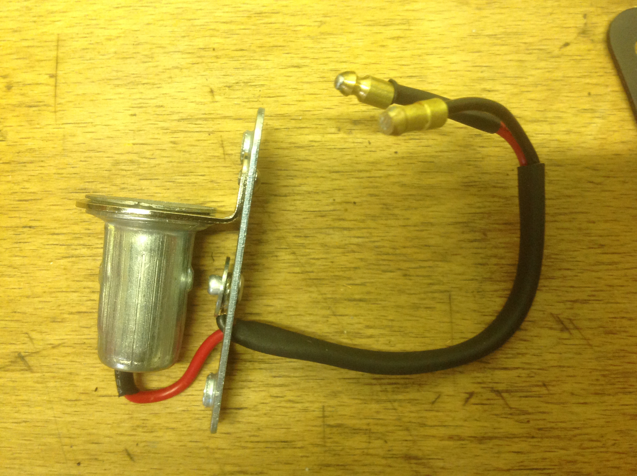

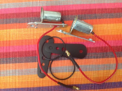

The recourse was to change the internal bulb holder of the 1130 unit to BA15s. They're available, but I couldn't find many stockists. I bought mine here (and not only was he the cheapest, but delivery was next-day):
http://www.vintagemotorspares.com/page6.htm
They only have a positive lead, but fitting an earth return was very easy. They're now installed, with diffused bulbs from the source in my first post. Once again, it looks totally original but much brighter.
