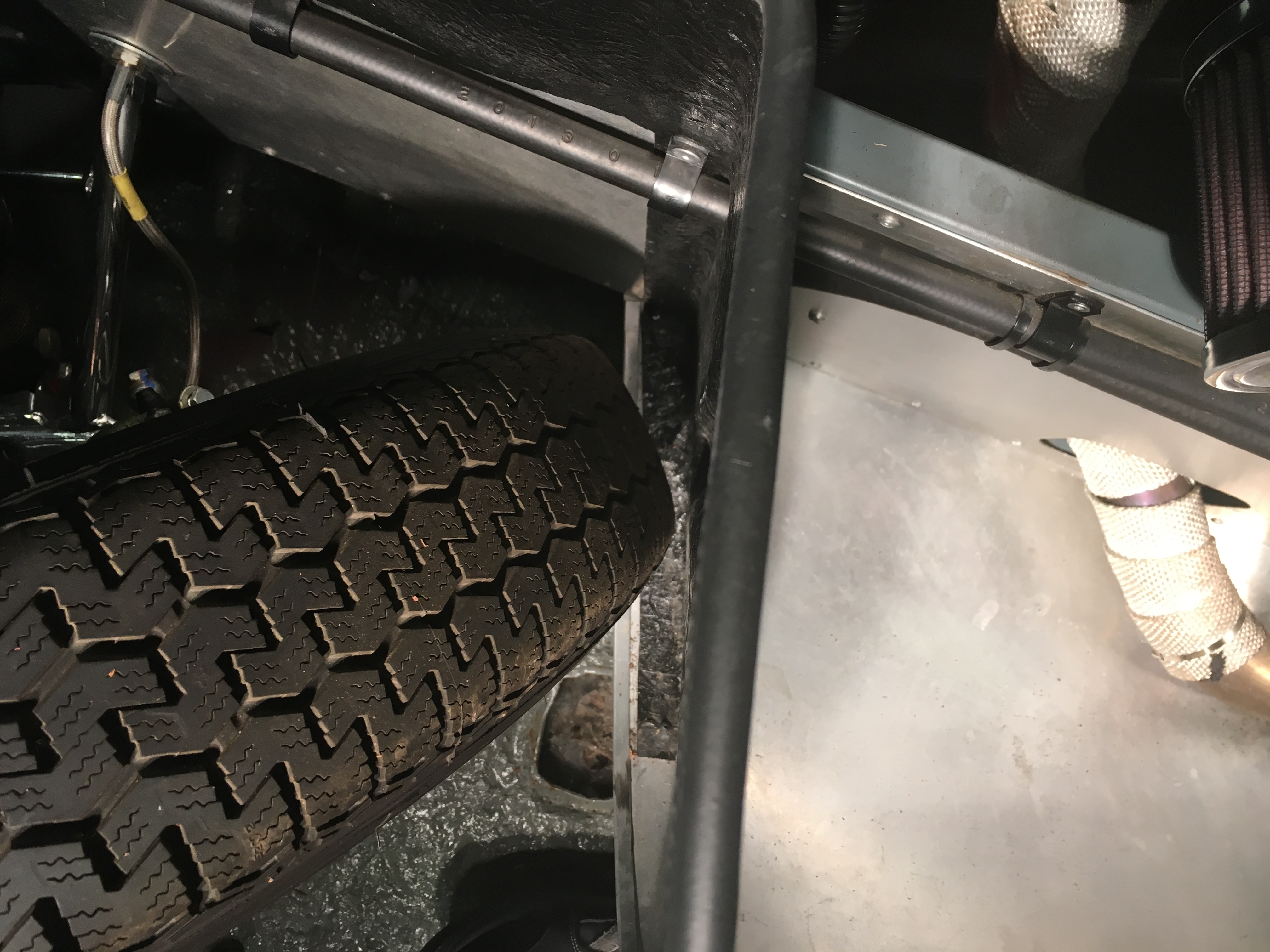

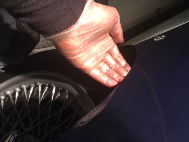

Two Michelin XZX 145SR15 tyres were delivered to me on Thursday. I was visiting friends in High Wycombe this weekend, so I dropped into MWS in Slough on my way there. Craig fitted my tyres to two of his "trial fitting" wheels; the 48-spoke, 4 inch-wide rim that was OEM for the MG TF and MGA (the XW450) and the 72-spoke, 5 inch-wide rim (XW459) and I was able to test fit them to the car this afternoon.
Firstly, the fit. Almost no issues whatsoever! There is LOADS of room between the front tyre and the back of my headlights. Remember, I have the old bonnet moulding with it's short, integral headlamp bowls, with LED bulbs, heat sinks and drivers fitted. (If that's news to anybody, there's a separate thread on it!) Great (so far)!
All good to the front of the front wheel. Not so perfect to the rear of the front wheel. With the car up on axle stands and the front suspension at full droop, clearance between the tyre and the aluminium sill is at its most limiting. With any steering lock applied, the wheel impinges on the metalwork. The photo below shows the gap with the steering at neutral. This is the front/right wheel; with the wheels steered to the left, the back of the tyre moves to the right (outboard) and the gap INCREASES significantly. But with the front wheels steered to the right, the back of the tyre moves inboard and jams on the sill. It's the INBOARD front of the sill that'll need cutting back a little, but not by much; probably about half-an-inch off the forward edge of the sill from the chassis rail, outboard for about six inches. (This will not be a visible alteration!)
At the rear axle, clearance should be OK. I'll be fitting 165-section tyres which are slightly taller, having an overall diameter 30mm greater than the 145-section tyres that I've offered up. I may well have to reposition the fibreglass inner wheel arches, but that's the work of only a few minutes per side!
