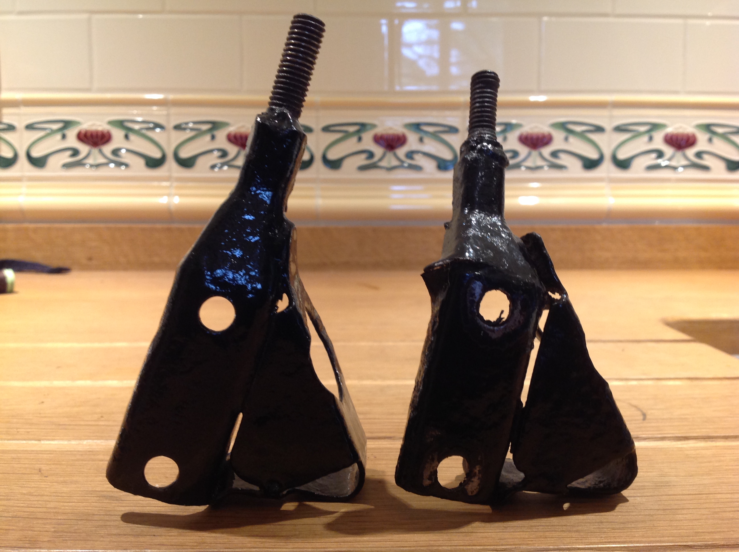

(The absolutely eagle-eyed may think that the handbrake balance-mechanism bracket looks a little short? It's actually bent! Fifty-year-old bent sheet-metal, with a pre-introduced crease (have a look at yours to see what I mean) constantly being pulled on by the handbrake cable. I noticed it a couple of days ago when I put the car up on stands to start playing around with 15" wheels. My spare bracket is painted up, ready to fit!)
