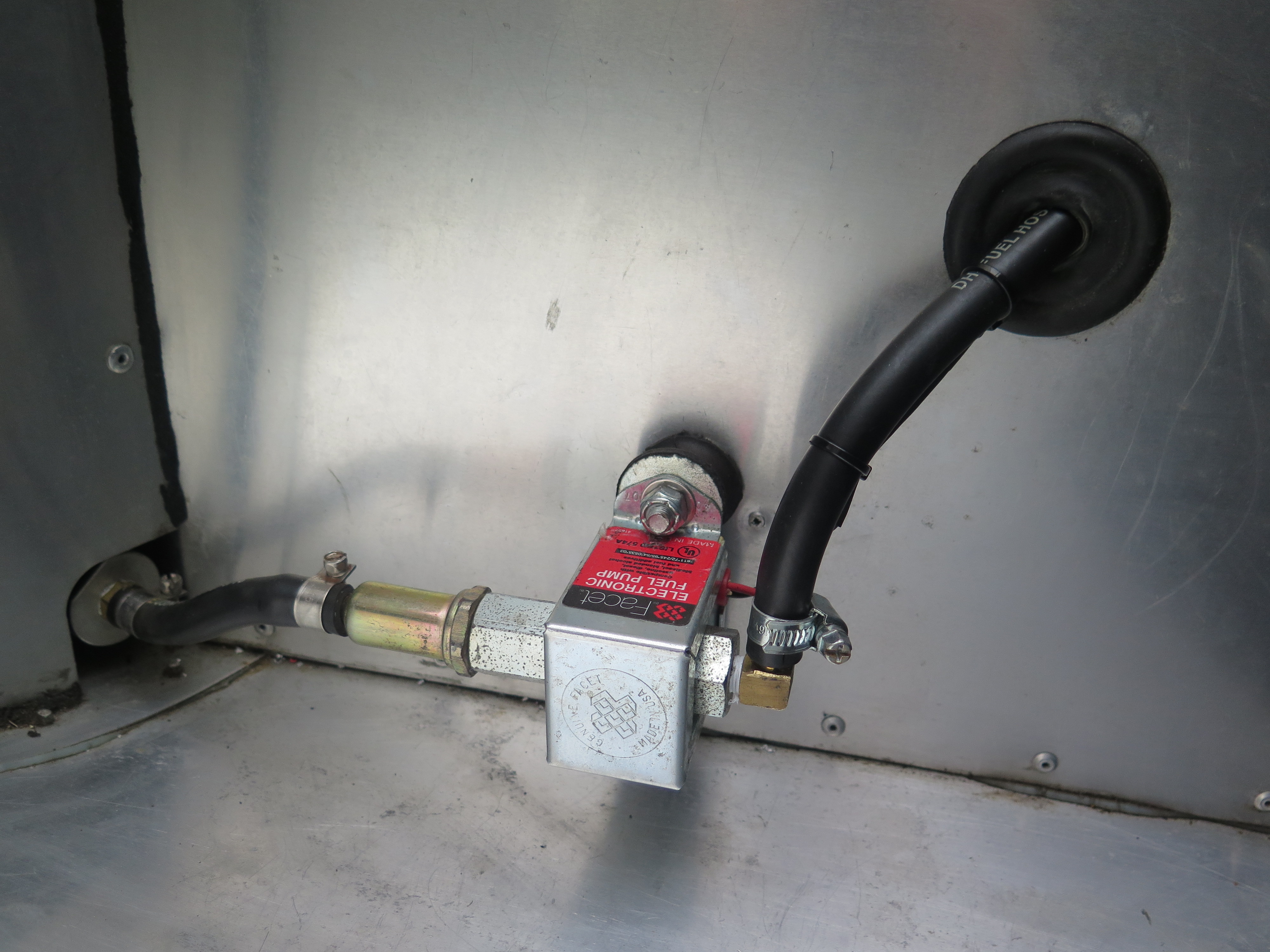

I had sited the pump as suggested in the build manual but the under-bonnet temperature was obviously getting very high, exacerbated by the pump being at the top of the engine bay and, I am assuming that this was allowing the fuel to froth so that it would not pump, despite the tank being over half full at this stage.

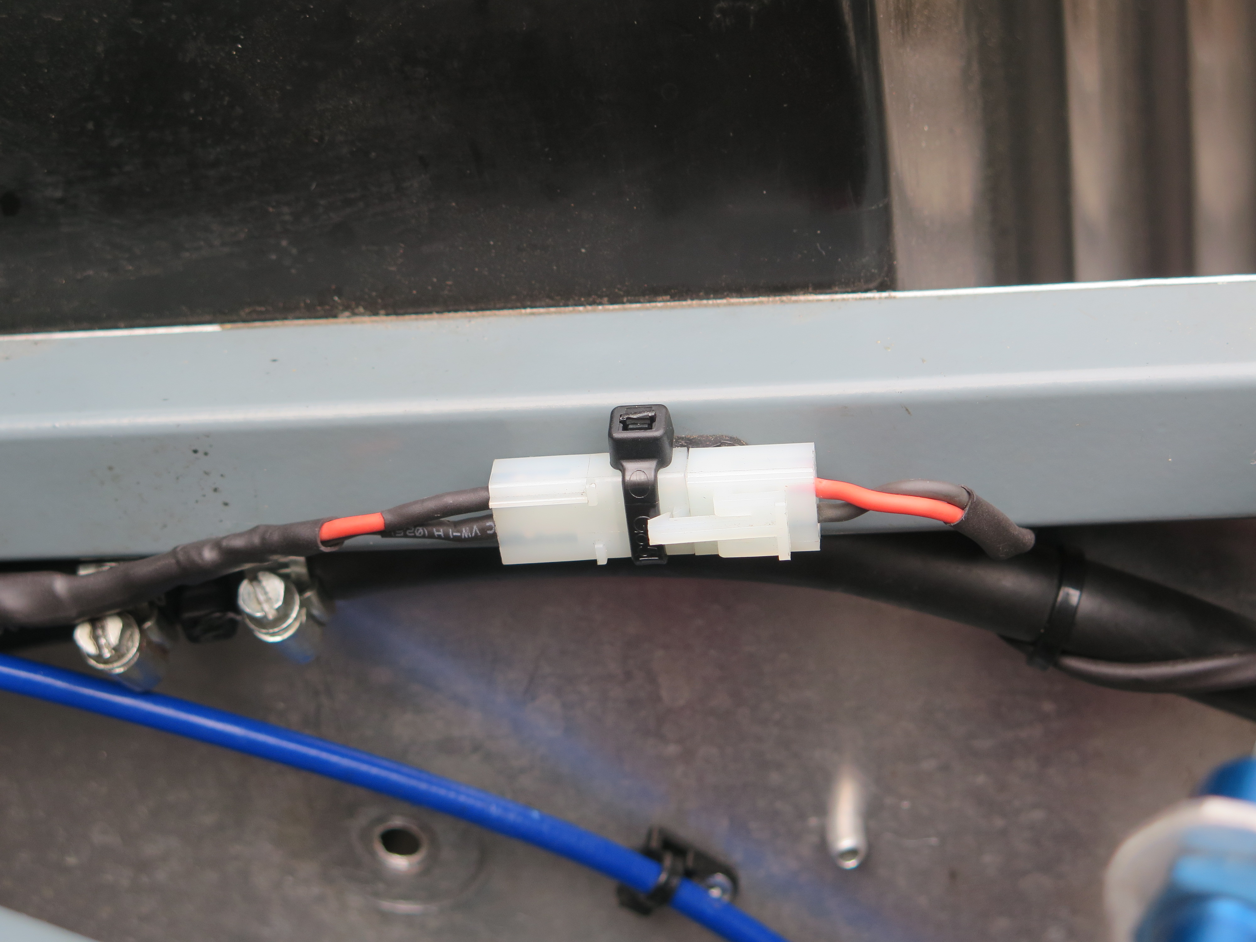

In the Demon Tweeks catalogue, it says that this type of fuel plump should be mounted close to the fuel tanks, so I took the decision to remount it low down in the pontoon just in front of the fuel tank. Doing this was straightforward (particularly after having fitted an elbow outlet on the pump that directed the hose towards the existing hole in the wing), the most involved operation being to extend the wiring. I have left a plug/socket on the top off-side chassis rail (the original fuel pump location) so that I can isolate the pump if fiddling with the car. With the pump now being outside the engine bay and being lower should appreciably reduce the temperature of its operating environment.
The pump fired up straight away after I filled the tank and turned the key and it was noticeable that it was shifting fuel much quicker than before (when it seemed to be priming for a few seconds before the tapping note deepened). I need to pick up a couple of grommets to seal the old pump mounting bolt holes and wait for another hot day to test it thoroughly. I'll report back when I have done this.
