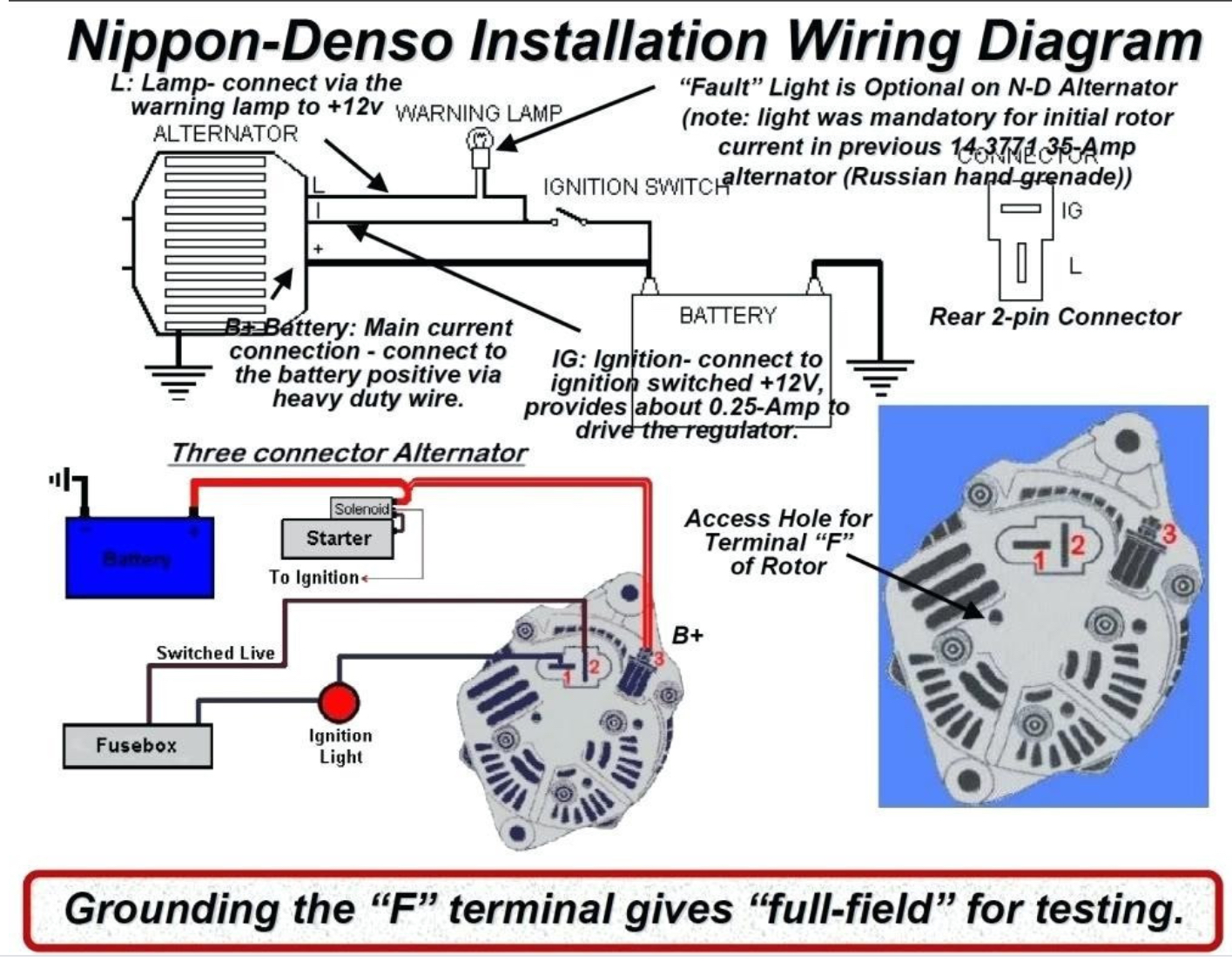

The old Lucas alternator was connected with a three-pin plug. Two of these pins were thickish brown (positive) feeds to the same terminal on the starter solenoid as the battery feed. The third pin was the thinner brown wire with a yellow trace that is the ignition warning light. The Denso unit is connected in much the same way, but has a two-pin plug holding the ignition warning wire and just one of the former two thicker brown wires. The second brown wire is replaced with a very thick, battery cable-style wire from a separate terminal on the side of the alternator back to the same terminal on the starter solenoid as before (ie, the positive battery feed). With me so far?
I assume that the formerly two thickish brown wires connecting the Lucas alternator to the starter solenoid (and hence, effectively the battery) served two purposes. Before startup, they would take 12V DC from the battery to the alternator in order to excite the alternator. Once running, their combined thickness was enough to handle the rather low output of the alternator, feeding current back to the battery terminal of the starter solenoid to both recharge the battery and also to run the car.
With the higher-output Denso, one brown wire is retained to excite the alternator at startup, but the other is replaced by the thick, battery cable-style wire to handle the much greater ampage put out by the modern unit?
When I turn on the ignition, the ignition warning light (triggered by the thin, brown and yellow wire) comes on as it should. When I start the car, the alternator spins and the ignition warning light goes out. I appear to have got that bit of the wiring right.

If you are getting a discharge from the alternator, make sure that you have the post going to the battery (usually attached at the solenoid/battery, and the SWITCH wire from the alternator's plug going to the ignition switch accessory post (off when the ignition is switched off, on when it is, well... on) and you won't have a problem with discharge.
The alternator SENSE wire can be disconnected and the alternator should work normally. If not, connect it to the switched power as well. Usually, the sense wire is not used at all and is clipped out.
This battery discharge problem is not uncommon when the alternator is not properly attached to the switched power. This is often an effort to make a three wire alternator into a "one wire" alternator by paring the battery and the switch wire. Then... the fix is to put in a second switch, but the real problem is not getting the alternator wired into switched power to start with. As I recall, the white wires are switched power.
This is not a big problem. Just attach the switch wire to the proper post on the switch, or a switched power output from your fuse box.
