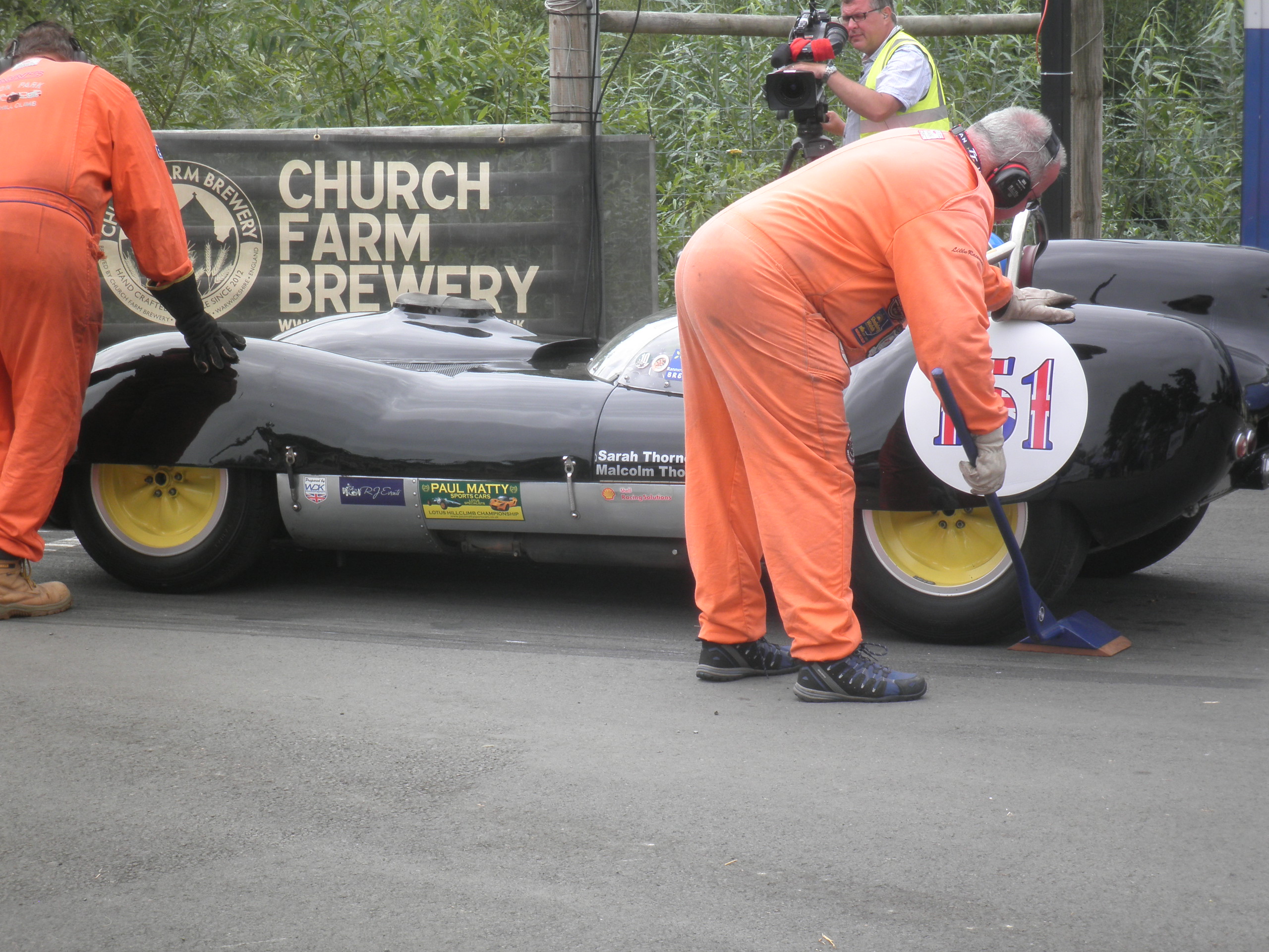

My own motivation for looking at this is based on having seen a Lotus 15 equipped with a Buick V8 at the Hillclimb at Chateau Impney, in Worcester, England. The car was competing against similar period cars and driven my Mrs Sarah Thorne, was "Up there" in the top times throughout the entire meeting. The car was in the open paddock and I was able to take a few photographs of the general arrangement. I believe that the car had previously held to track record for the event in the hands of Mrs Thornes husband. This had been recently eclipsed by a rear engine big block "Lola" Can-am car.

This was the car that got me thinking.
