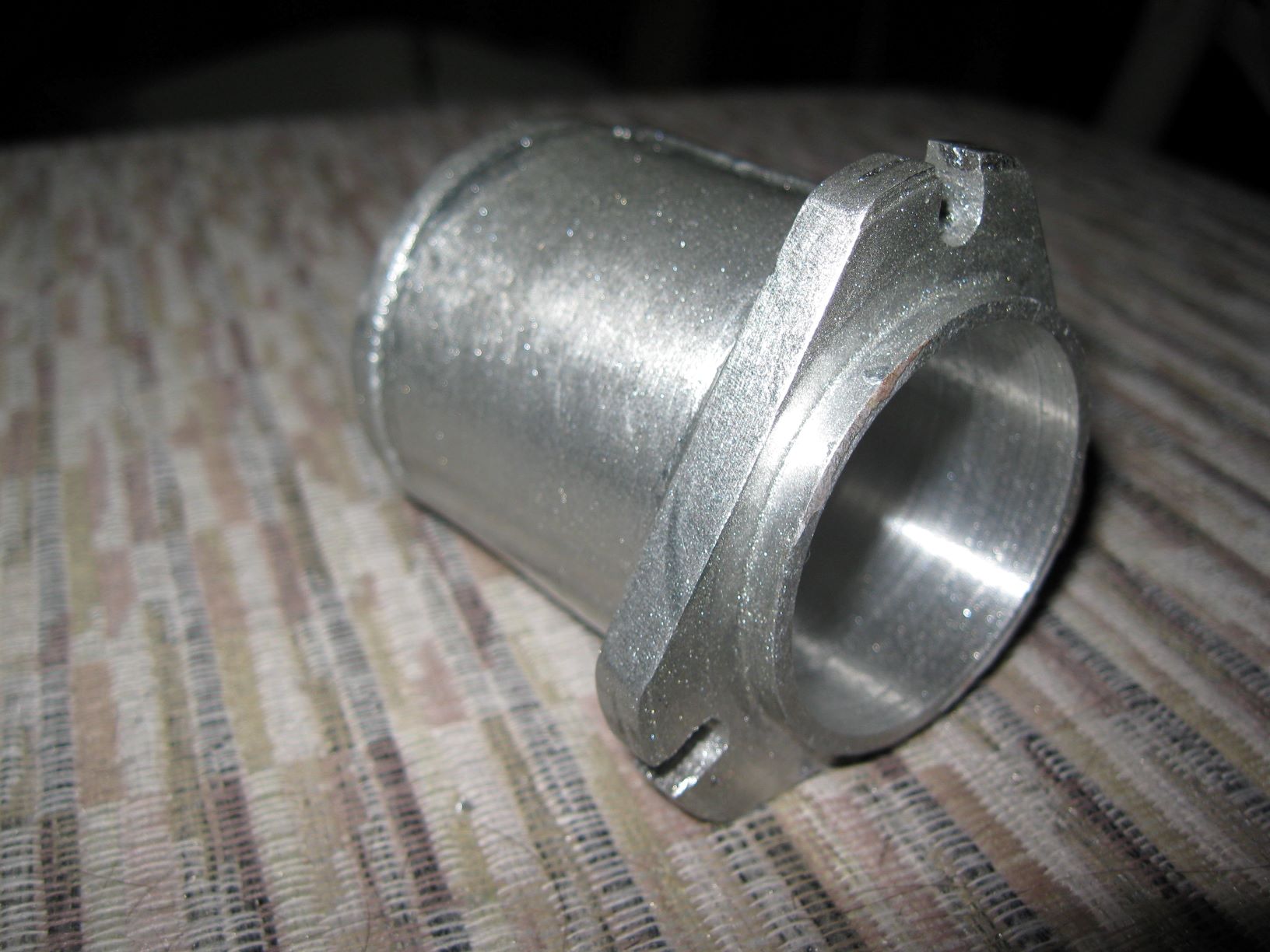

Unfortunately no instructions come with the T9 conversation kit, but those from 'Frontline Developments' say to remove the Bendix cover from the MG bellhousing, then to use it as a template to drill the three attachment holes into the new bellhousing.
Covers by themselves are like hen's teeth, with only one available separately here in the UK and one in the US. I've now machined my own from aluminium (also saving myself a rediculous £30 for one of the used items!).
I've seen that some builders have had to cut away some of the starter pocket, but a trial fit of mine in the car doesn't show any clashes with the chassis. I wonder whether WSC has adjusted the engine mount position to sort this (my chassis is almost 2 years old now). I'll know for sure once I re-assemble the parts and lift the engine back in.

The bellhousing in my Westfield conversation kit came with a 45 mm diameter hole at the end of the starter pocket that the (Bendix) pinion pokes through (by about 40 mm). I can't leave it open as mess from the road is sure to get in and jam up the mechanism.
There are no photos in particular that I need to refer to. They were good for inspiration when it was an effort to go into the cold garage to get some work on the car done .

I was put off the high torque starters by the high prices (£220) so I'm staying with the Bendix at least for the meantime.
In the end I turned a couple of ends (one with a flange) and welded them together with some aluminium sheet. I've drilled and tapped 3 off M5 holes into the bellhousing for attachment.
