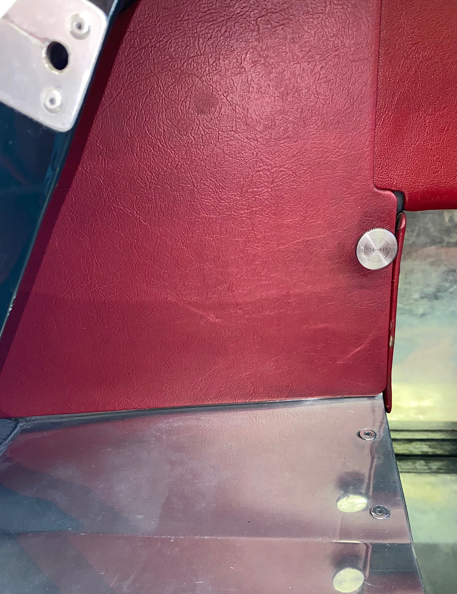

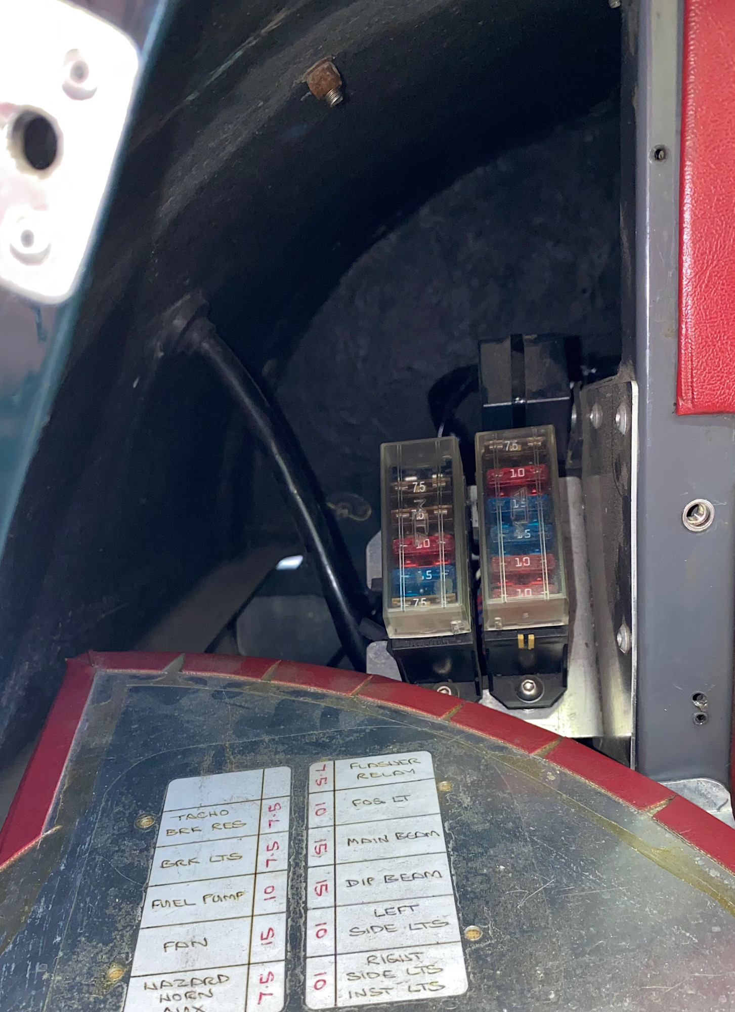

As part of my own rebuild and upgrade program, I’d moved the fuse box and single relay (for the headlights) from under the scuttle to the left hand side of the instrument panel, behind the triangular panel. And both of those dash “wings” I’ve altered so that they’re each secured by a single knurled thumbscrew, screwing into a Rivnut in the frame. So accessing the fuses and relays take five seconds!
The left hand instrument panel “wing”, secures with a knurled thumbscrew
The fuse box and headlight relay
Putting an ammeter across the fusebox’s radiator fan position, I was able to read a maximum instantaneous current draw on startup of 13.5A and a steady draw, once running, of 5.5A. I don’t know what the switch can take, but it’s probably designed for much less than that. If I wasn’t to be replacing it ad infinitum, then I needed to add a relay to the fan circuit. But how?

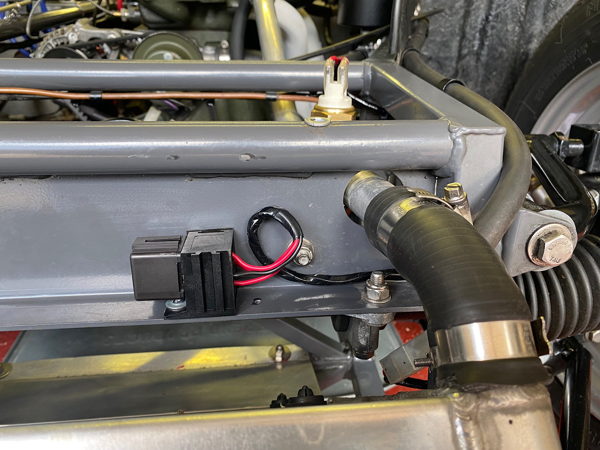

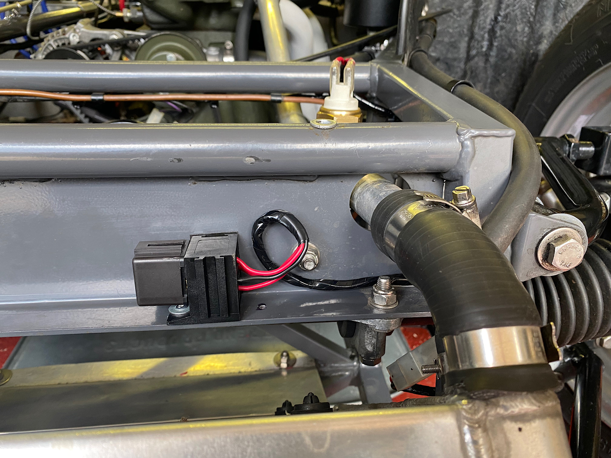

The alternative would be to install the relay close to the switch itself. But I was absolutely NOT going to have flying leads and a generic relay hanging in space. Nothing screams “badly built kit car!” to me more than a rat’s nest of wires under the bonnet!
No rat’s nest of wires in here!
So I spent about seven hours after the MoT test, puzzling it out and installing my solution. I drew a wiring diagram, identifying the positive feed, switched feed and earths required, identified where those leads were in the vicinity of the fan switch and sought a suitable position to mount the relay. I wanted it to be accessible (to make replacement easy), yet as unobtrusive as possible. I also wanted it to be in a dry position in an engine bay that’s almost completely open to the elements and which I regularly clean with soapy water.
And I’m pretty pleased with my solution!
What’s more, there is absolutely NO sign that it’s fitted. And, whilst the fan still draws a peak of over 13A on startup and a continuous 5.5A when running, the switch only draws 1.5A.

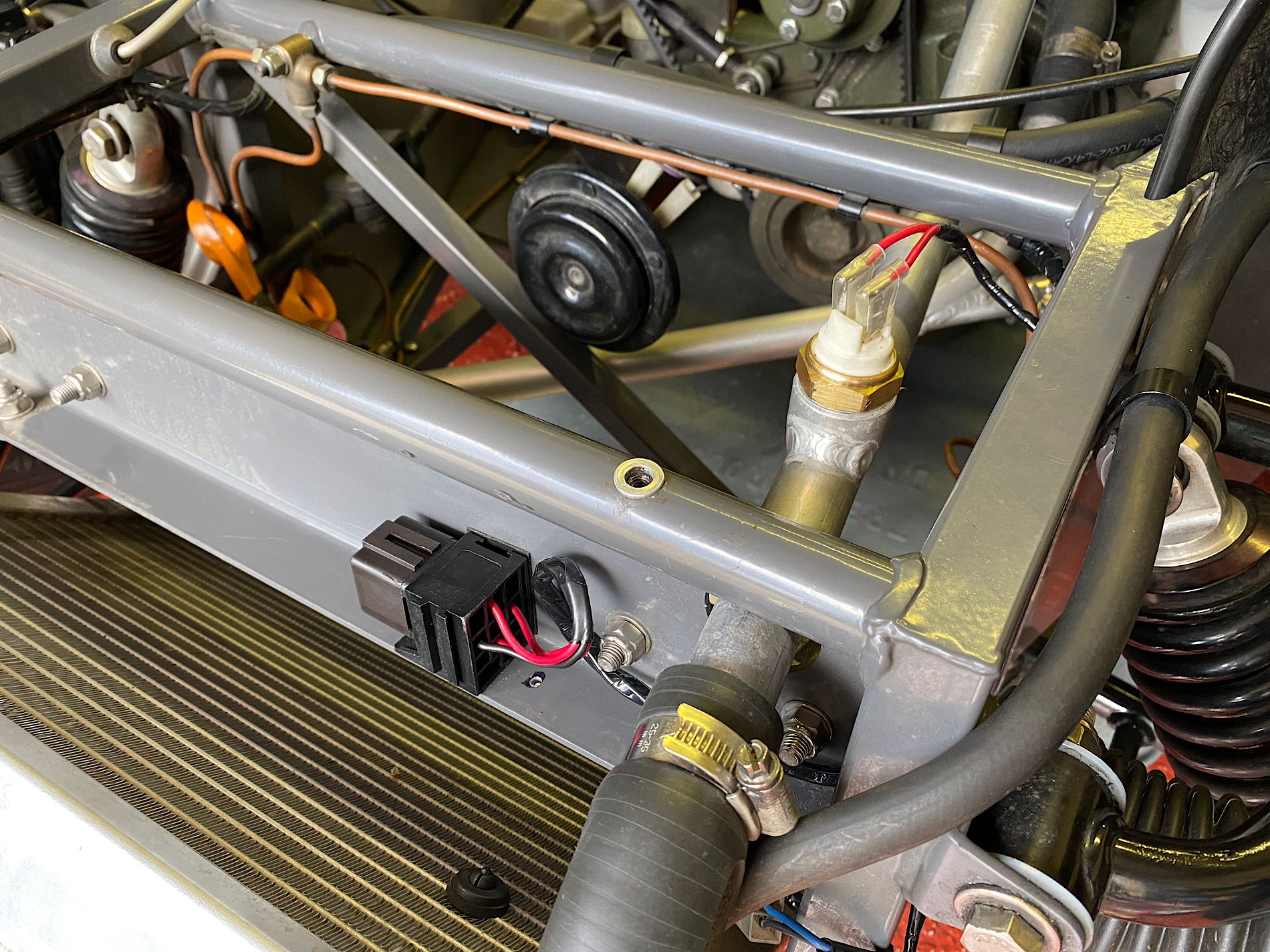

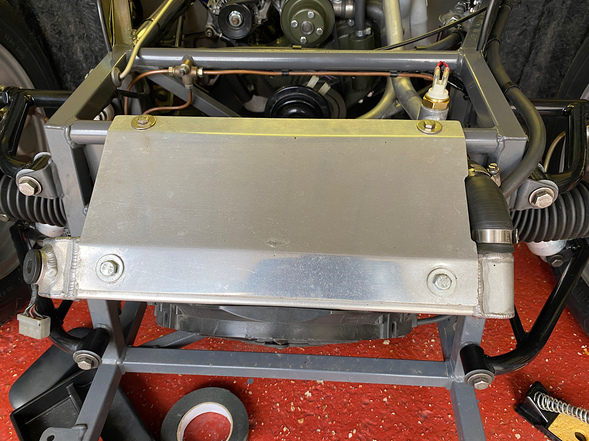

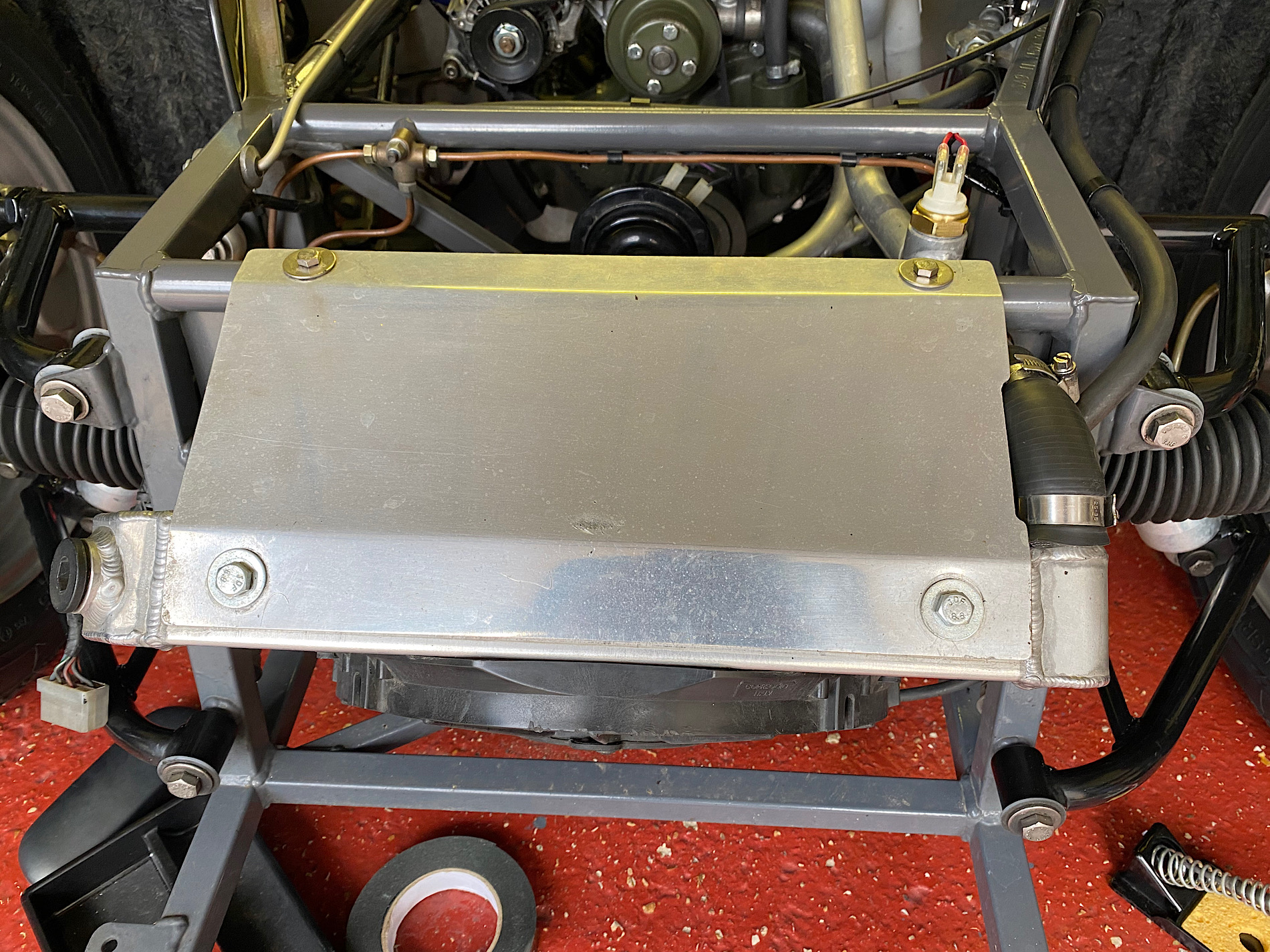

The relay, hidden on the crossmember behind the radiator
And from another perspective
And with the top radiator bracket reinstalled

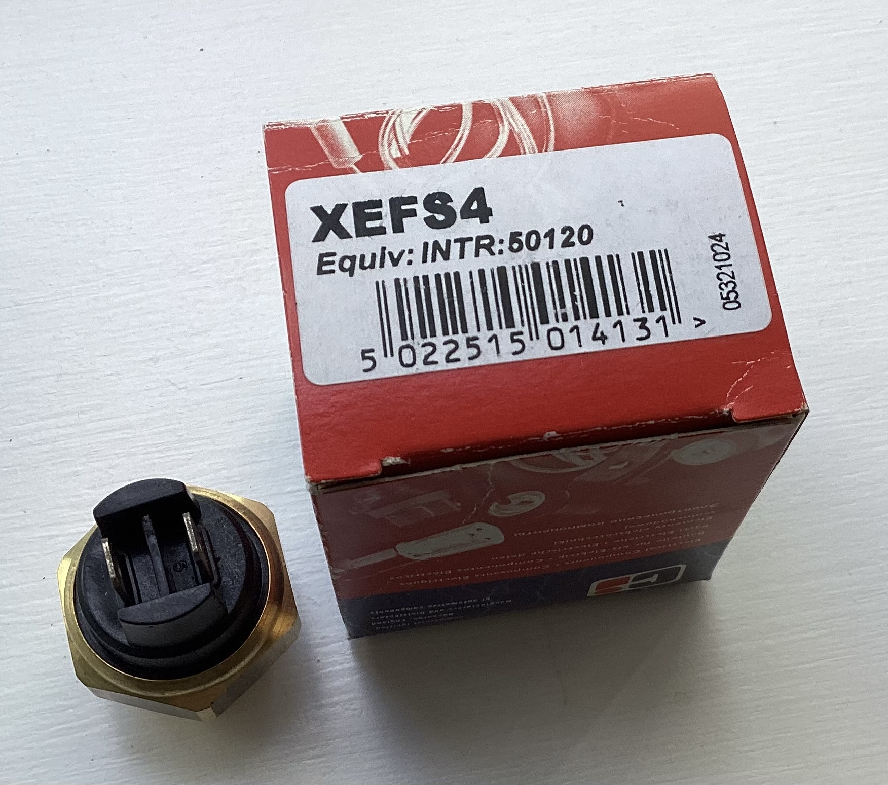

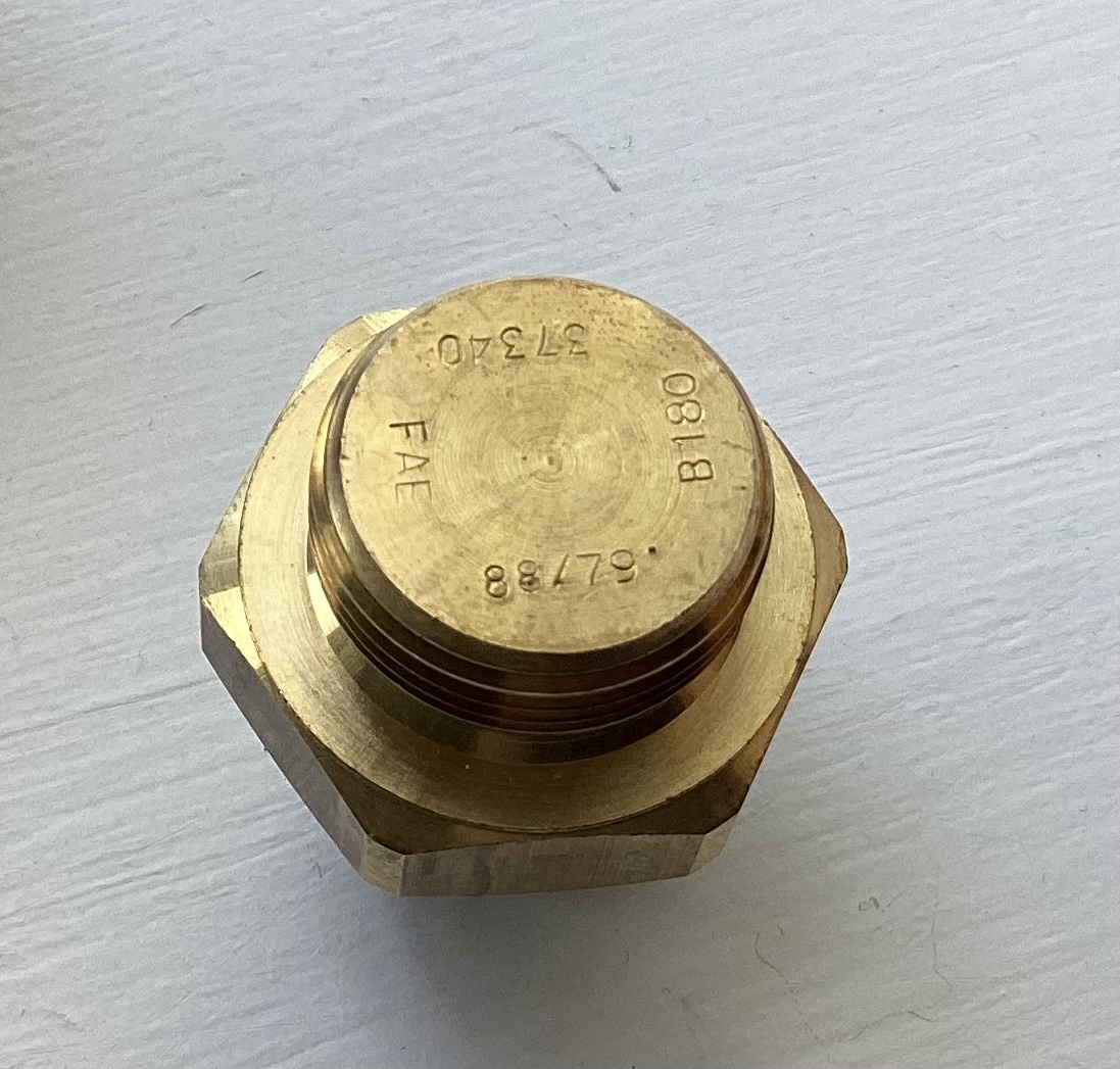

Always check the rating on your fan switch. The switches are all pretty much the same, and available on eBay etc for well under a tenner.The first one I fitted turned out to be a 98/92 deg unit. Waaaaay too hot for our cars. A quick repurchase, paying more attention, got me the correctly-rated switch.
