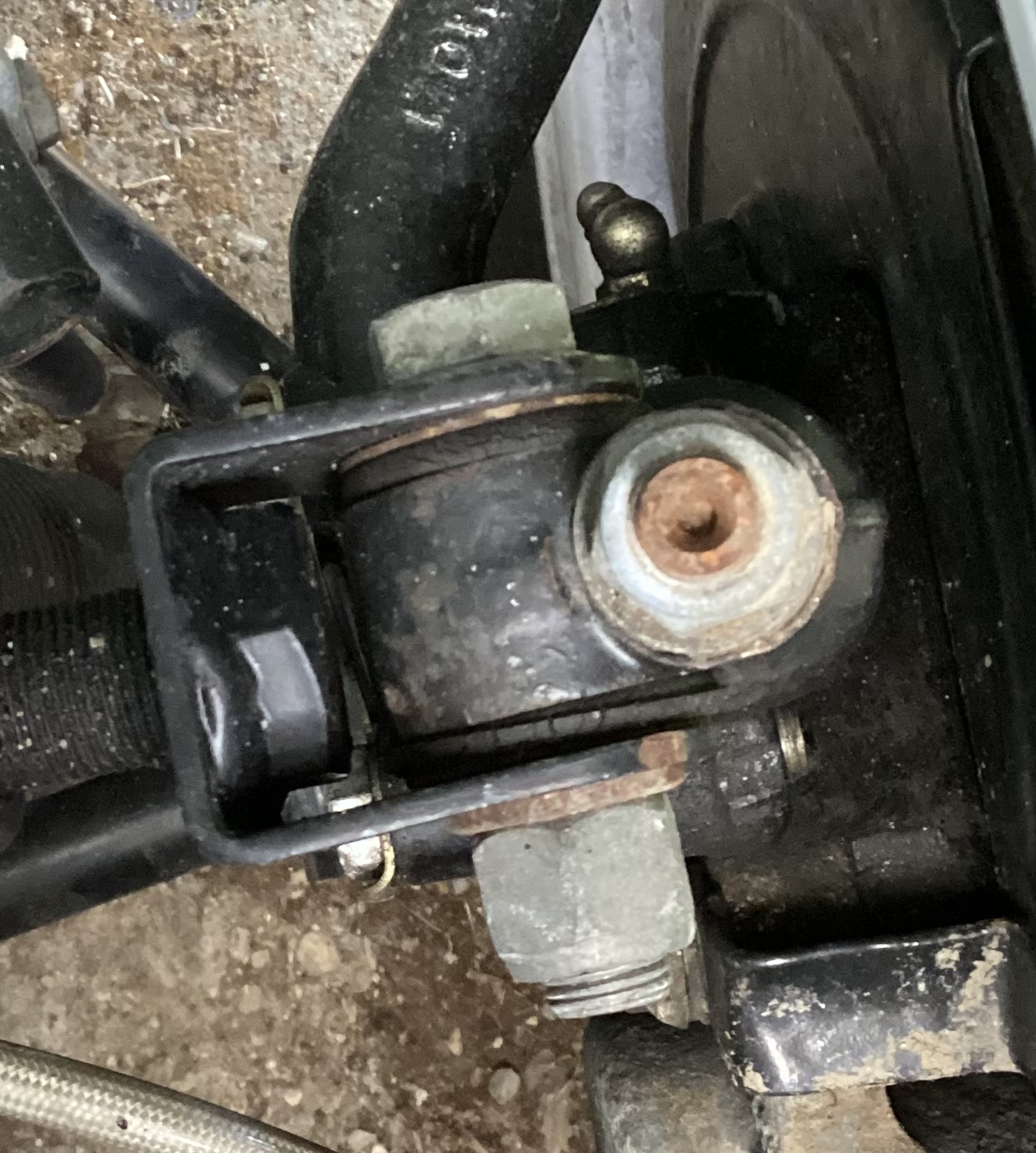

Thanks for the heads up. I’ll check mine when I’m next under the bonnet. This sort of distortion is rather obvious…. And worrying.

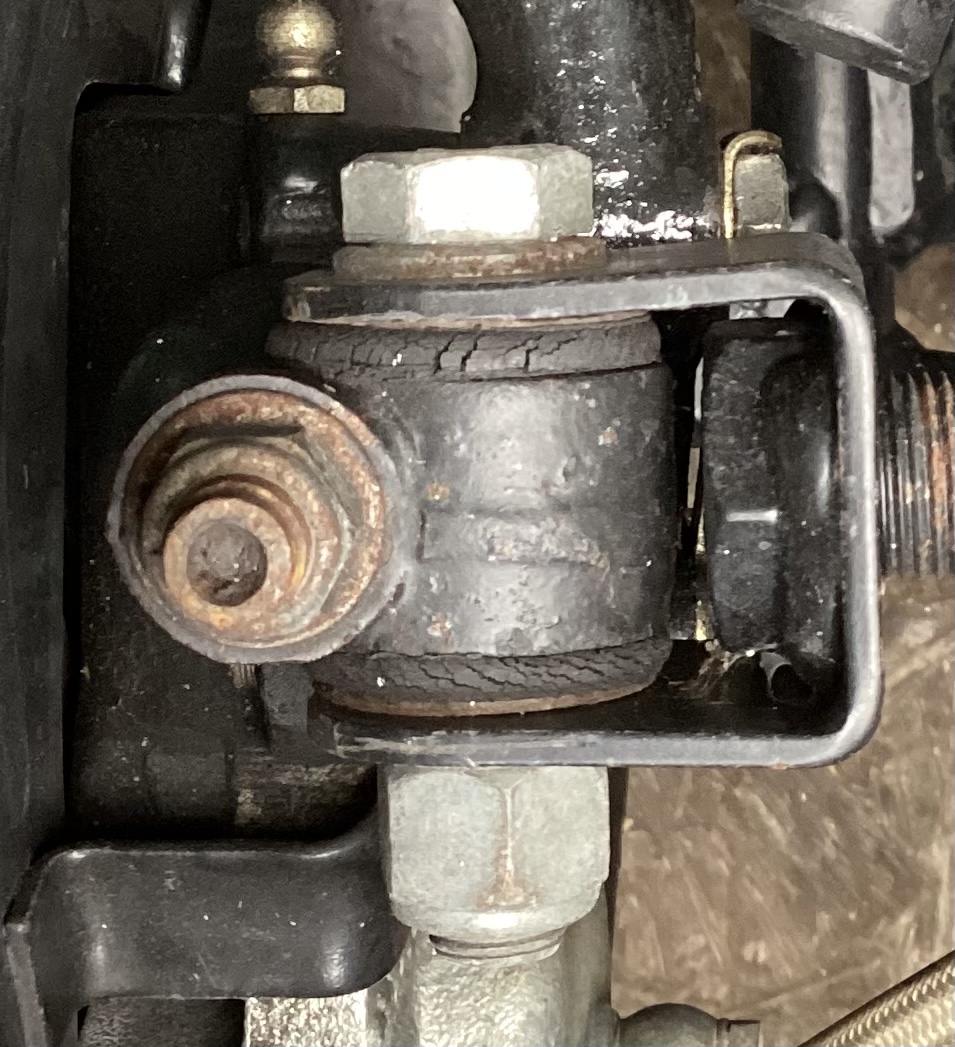

Looks like the same gauge of metal. Mine is slightly compressed due to the tightness of the fasteners versus the width of the bush.
Maybe the other car is over-braked for the top mounting? Dunno - not thought too deeply about it. This part would probably be better made from billet, I think.

Yes, mine look like yours in that they are compressed in by the bolts (although cleaner due to not being in a serviceable car yet!).
This appears to be an isolated case and rather bizarre.
If the trunnion bolt wasn't tightened sufficiently then that might apply a bending moment to the bracket under a braking force?

I find this curious. I have about 55,000 miles on my car, and no such bending has taken place, nor has this taken place on any of the 6 cars that I have been directly involved with, or built personally. This is an area that I am often involved with, as all of the cars that I have seen needed front suspension alignment. I had to physically remove the upper trunion and adjust the "fork".
Braking could not cause such distortion, but a misalignment of the upper and lower control arms might. The arms are Left and right for the lowers, as I recall. Putting the arms in the wrong location, or upside down (also possible) would put a bending moment on the upper mount and force it forwards.
I would take a good look at the installation of the upper and lower control arms for proper up/down alignment. You can also do a caster check to see if the correct amount of caster is present. Very light steering or jumpy, imprecise steering response can be caused by both the caster and toe being way off.
The only way that caster can be off would be to install the lower arms incorrectly. Correctly installed arms should have the king pins slightly angled aft of the lower mounting point at the top. This may be hard to discern, so it may be necessary to measure the camber to ascertain the caster number, which, as I recall, is around 4.5º. Incorrect toe (always toe out, due to setting toe without the driver installed, and not cutting the steering arms short enough) is a common problem that I have seen in EVERY W11 I have worked on, save the ones I built myself, and the very first one I purchased, my own #129.
The upper mount will distort somewhat if overtightened. The tube inside the bushing should just contact the inside of the mount when tightened. I like to run the pivot point bolts a bit looser than recommended, to keep the suspension supple. I am also using urethane top bushings as well. These last longer, and don't crack. If you run the 5~10 lb.ft. I recommend, check the free movement of the suspension and the tightness of the bolts on a regular basis. I have not found any problems in the decade or so that I have been doing this, but it is always a good idea to check. You can also drill your suspension bolts and cotter pin a castle nut in place. I have not done this yet, but I did do this to another car with success using Aircraft AN fasteners.
