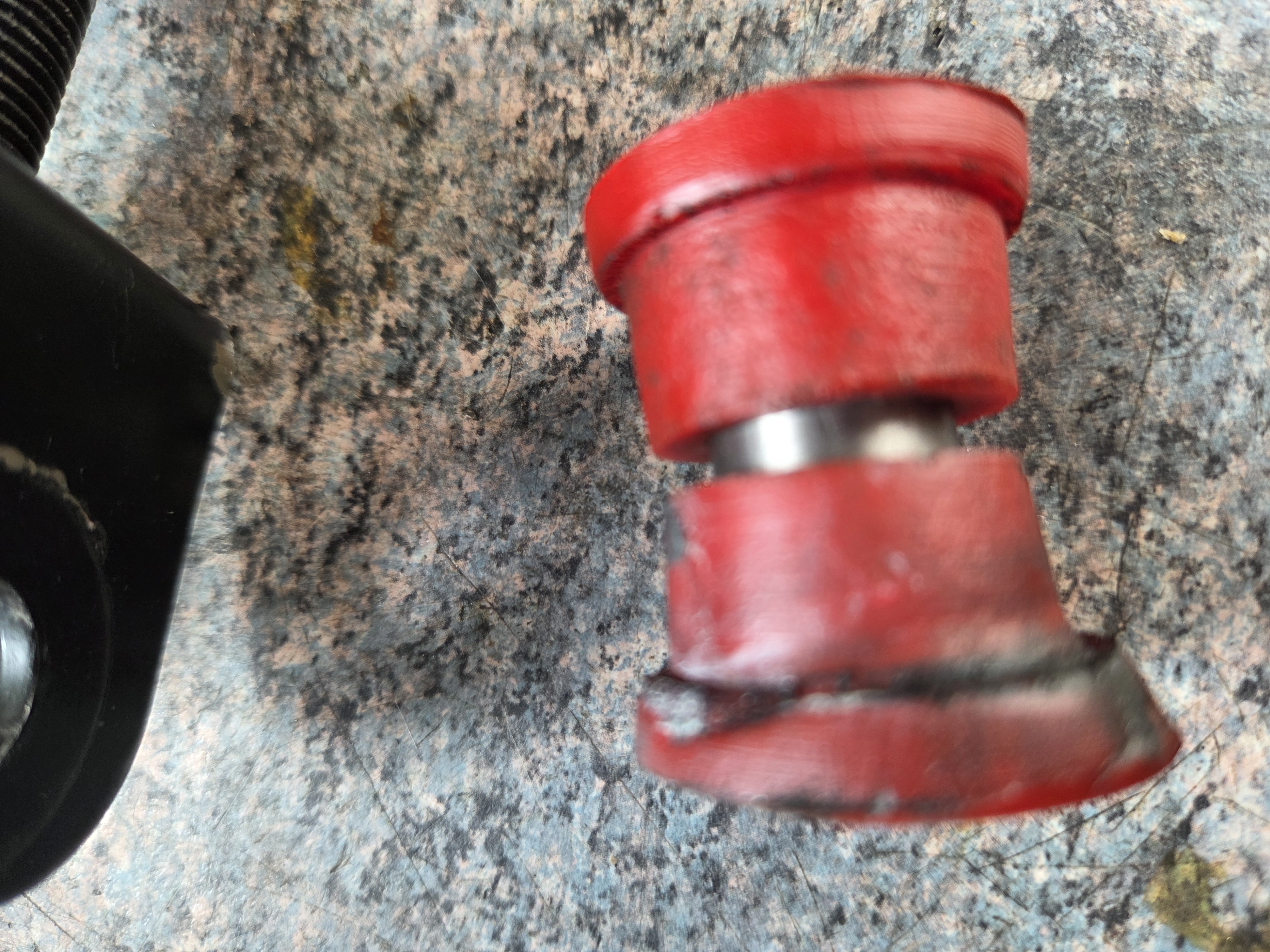

I had to do some maintenance of my front hub bearings. In taking off the the upright, I noticed that the U bracket was bent in quite a lot and that the poly bushes were badly squished. I thought I would get some new bushes and sort it out. I ordered new MG midget bushes from MGOC (here in the UK), but they are the wrong size. The originals on the car have a 5/8" OD crush tube for a 1/2" bolt (ID in the poly bushes 5/8"). The MG midget ones have a 1/2" ID.

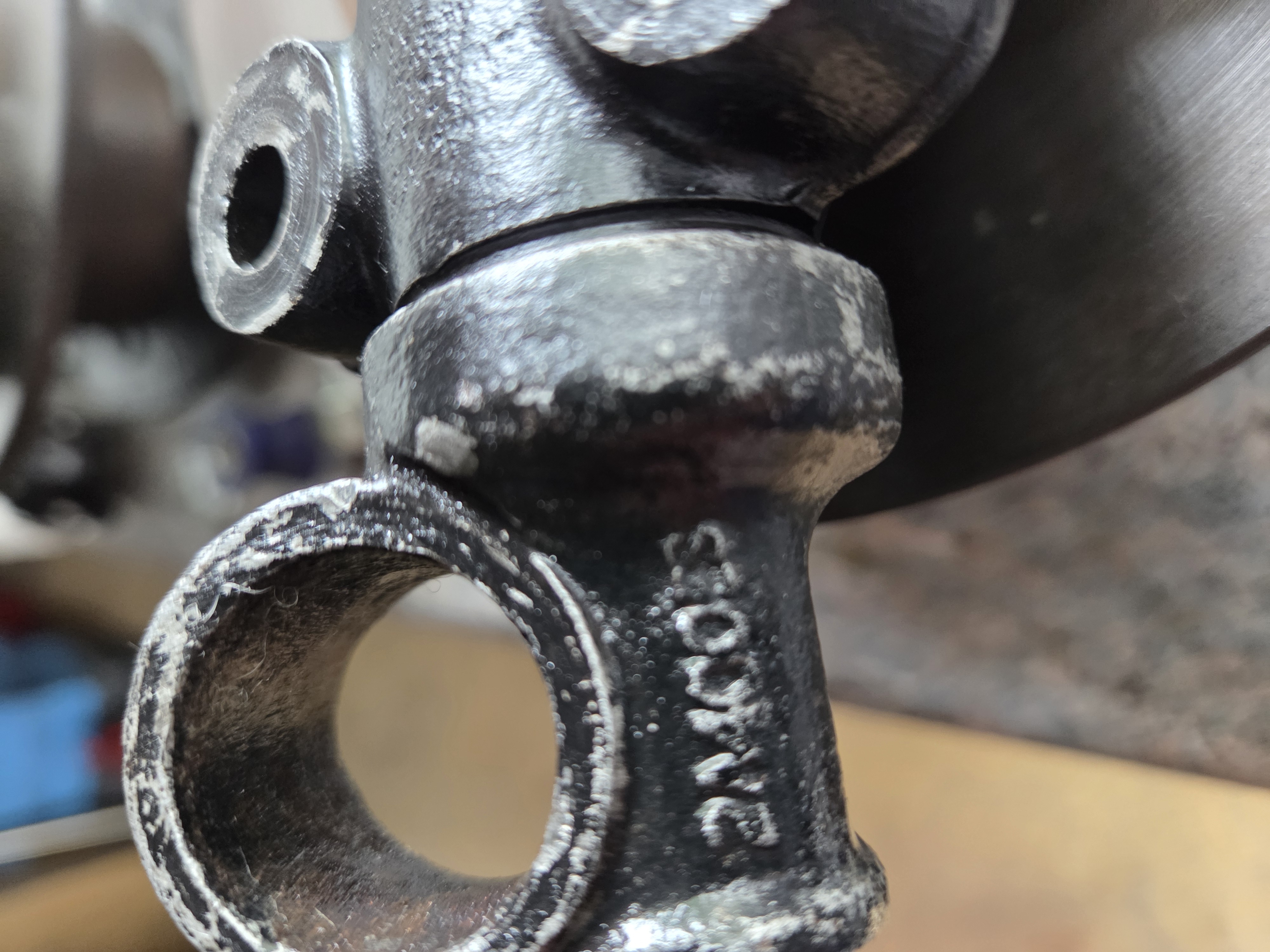

So now I notice that the top trunnions are different dimensions. The original is a bigger (tapered) ID than the replacement MG Midget one.
So there's clearly stuff going on that I don't understand! I can't ask the factory for the obvious reason. Is it something like an MG Midget upright assembly with a different top trunnion - MGB maybe?

Re: Top trunnion confusion
Looks the same as a standard one, just a bigger internal taper
I have a solution that will work. A fabricator friend has turned down a standard set of MGB polybushes to fit the MG Midget trunnions so I'll get a standard MG Midget trunnion and put it all back together. If I ever solve the mystery of the bigger trunnion, I'll restore to what it was.

A quick question: do your trunnions have different part numbers cast into them, please?
Just wondering if there is a (significant) difference li.e. as there is with the BTA 648/649 Fat Rack steering arms, and the later AHA Thin Rack Triumph items).
I see you have 2A4005 in the pic.
