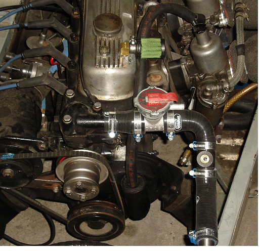

When I got my XI the cooling system was standard Sprite radiator mounted just in front of the engine, standard impellor on the water pump and an electric fan on the front of the radiator. The heater take off was blocked.
It didn't work very well so I move the radiator to the front and tilted it about 45 dgr., removed the impellor, got a lot of Samco silicon tubing and an aluminium pipe with a radiator cap. Expansion tank was mounted behind the radiator.
One of my freinds have welded the stainles pipes.
With that setup I got an air pocket at the cap as it is the highest point in the system and I allways had to bleed the system. The heater take off was still blocked so no circulation at the back of the head.
[attachment=1]First layout cooling.png[/attachment]
[attachment=0]First layout cooling front.png[/attachment]
So back to the drawing board.
New custom/tailor made 3 core cross flow radiator made as big as would fit in the front, is fitted.
I have had a watertank made (like the original Lotus 11), placed it on the firewall just behind the engine as high as possible. Inlet is from heater take off and outlet taken from bottom centre of tank goes to the top hose just after the thermostat. I had a T-piece made with a cap, but it will be changed to a T-piece with a bleed screw instead of the cap. The T-piece holds the probe/feeler for the electric waterpump I might fit later as well.
Now the tank is the highest point and I have cirkulation at the back of the head. It works OK (95%) so there are still room for improvement.

I ordered a take-off pipe to fit the back of the head - as soon as it arrives I'll plumb it back into the header tank return circuit.
Re: Cooling
Well, that's a lot of improving.
You could have just put a standard swirl (with a radiator cap) pot where your cap is (coolant in the top, out the bottom) and taken care of your air bubble problem. I have one that just sits in the top hose. It doesn't need any support. The swirl pot gives a good, high, fill point, and eliminates the bubbles.
If you put the fan behind the radiator, and get rid of the mounting plate, you gain 30% in radiator area, and the engine cools much better. This simple mod made every overheating US Westfield cool very well, even in the canyons, behind a slow truck, on a 40C day. Sure, it hit 95C, but it did not overheat.
Putting the fan, with its large hub, and the mounting shroud that blocks off several square inches of radiator, really causes a lot of problems when it comes to cooling the engine.
My personal XI has a stock cross flow radiator, with a rear mounted fan, and a 45º forward slant. It runs cool here in the Southern California Deserts. My new construction will use a double pass racing radiator, slanted back, aft mounted fan, with the air exiting beneath the car. The entire system will live in a duct, as it does on the original Lotus 11. I am using a Harrison alloy surge tank from an early Corvette, slightly modified to handle the return line from the engine. This will act as the fill point and surge/header tank.
The racing rad is thin, very light. Single core, but extremely efficient. A big advantage is that both the inlet and outlet are on the same side. At 16X11", if fits between the frame rails. Typically, these radiators are run about 30% blocked off when racing, as they do too good a job. I am running a fan and a thermostat. It should be just fine.
I also run an oil cooler.
