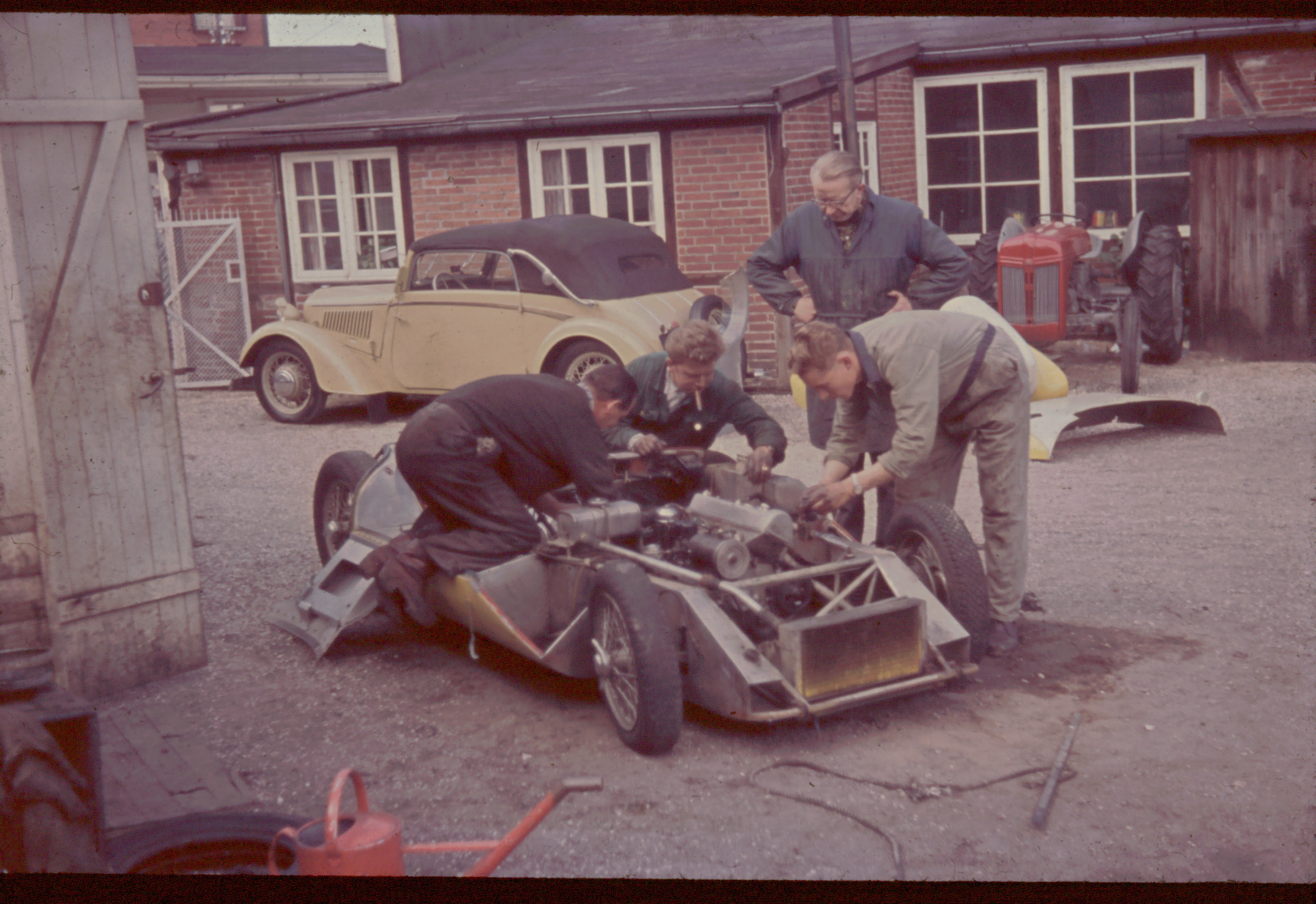

Here you see how they got the Danish champion 1959 and 1960 ready to race
[attachment=0]Lotus 2001.jpg[/attachment]
Low tech workshop 1960
