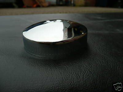

Folks,
After quite a bit of legwork and contribution from all over (thanks to all), I have solved the problem.
I got one of these from eBay!
http://www.ebay.co.uk/itm/50mm-2-Inch-B ... 231c4b500a
Nah, I got one of these:
http://www.ebay.co.uk/itm/290967669401? ... 1439.l2649
Job done - loads of room. Cost? £6.50 to my door.
