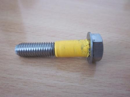

It appears that M8 x 40, part-threaded bolts are a good starting point for fitting the alternator lug to the engine.
I used a couple of layers of 8mm heatshrink to sleeve the bolt to the mounting hole. The attached pic was taken after a trial fitting, so there is a small amount of scraping to the outer layer of heatshrink. Use a non-aggressive lubricant to fit (silicone or similar) and it's snug, yet the bolt turns fine.
Just need to finish off the alternator body and work out the turnbuckle size/mounting points. And re-jig the wiring.
I reckon you could complete this job in an hour or so if you get your ducks in a row.
Edit to add - there is around 15mm from the back of the waterpump lug to the square boos on the cylinder head. This is what I'm aiming to thin the alternator lug down to. That's 7mm above the cast flashing line on my alternator (Denso).
Having remeasured, it looks like M8 x 45mm would get the nyloc into safety, including a washer.
Parts are on order...

I use the closest fit fractional bolt, (3/8" fine) which may require a slight drilling of the alternator and the water pump tab eliminating any need for tape that will loosen and the water pump tab in some cases. That way, you only need to carry a 9/16" and 1/2" wrench out to the car if you want to do a general adjustment or bolt tightening on the engine. All fasteners match. Also, I would go with fine thread. I have been running this for many years, without problems. The water pump tab is very robust. It wont crack. Remember,the alternator is half the weight of the old unit, and is nicely balanced and stabilized when mounted.
While most of my cars here in the US are metric (and it is my favored system), I went to great trouble to make everything on the new Westfield kit fractional (My early car was already metric free), so that I would not have to carry a second set of tools, and so that fastener choice would be simplified on that particular chassis.
I also drilled and tapped the lower mount tab so that the fractional bolt would thread in, eliminating a fastener (lock nut) in the installation.

If I could get hold of a part-threaded 3/8 x 1.3/4" bolt, I could use that. Trouble is it's a limited size on eBay here.

Bolt size: 3/8-24. 3/8" diameter. .37" Take any standard bolt gauge with you as this will have thread and diameter, speeding your search (some bolt companies will give these away for free).
This is a pretty common size in automotive use, and available in "Grade 8", which is better than the usual "Grade 5" automotive type. Wrench size is usually 9/16".

Jon I have a bolt for you if you want it. 1 3/4 long 3/8 part threaded with washer and nut. Not a nyloc as the bolt was probably made before nylon had been discovered!
PM me if you want me to post it.....
