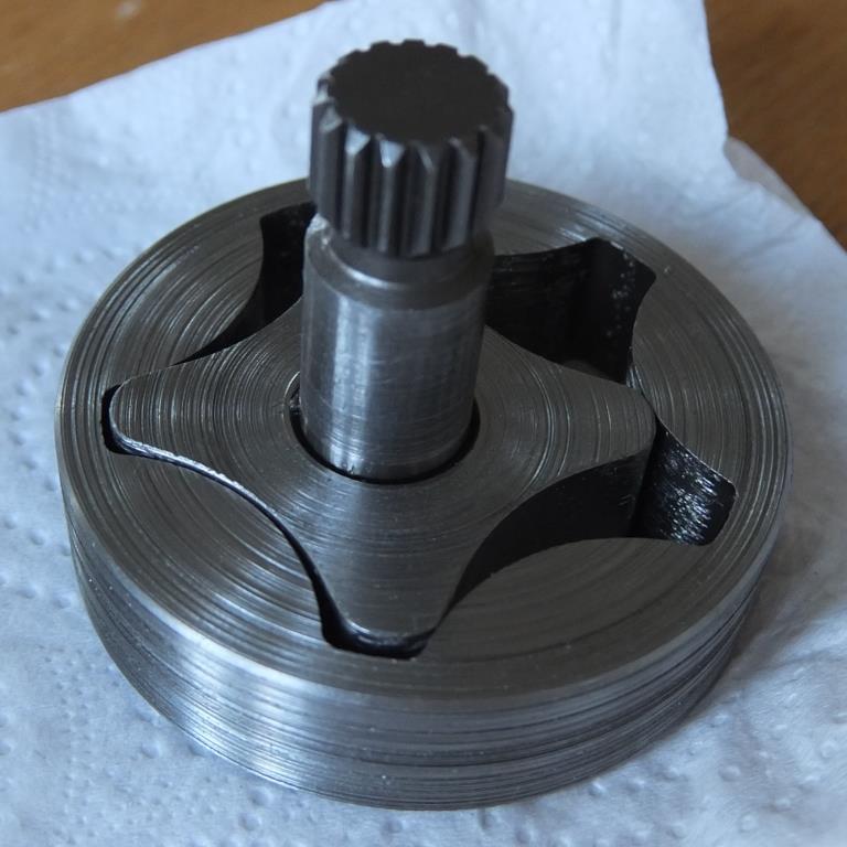

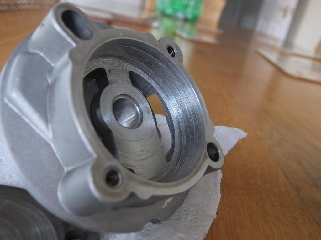

The oil pump is utterly destroyed! I'll post a couple of pics later, but it's a sight to behold. The rest of it looks pretty damned good, considering. Anyway, I'll be taking it all to be checked and rectified next week - diary permitting.

Here we are...

Those pumps are usually pretty stout. It must have ingested something...

My oil pump looked similar when my last cam wore away the first two lobes to practically nothing. Last time I use a re-profiled cam! Recommend you choose a cam on a new blank for your rebuild Jon (I'd guess you owuld anyway). And lots of assembly lube on the lobes and the followers. I used Graphogen last time and it seems to have bedded in fine (touch wood).
