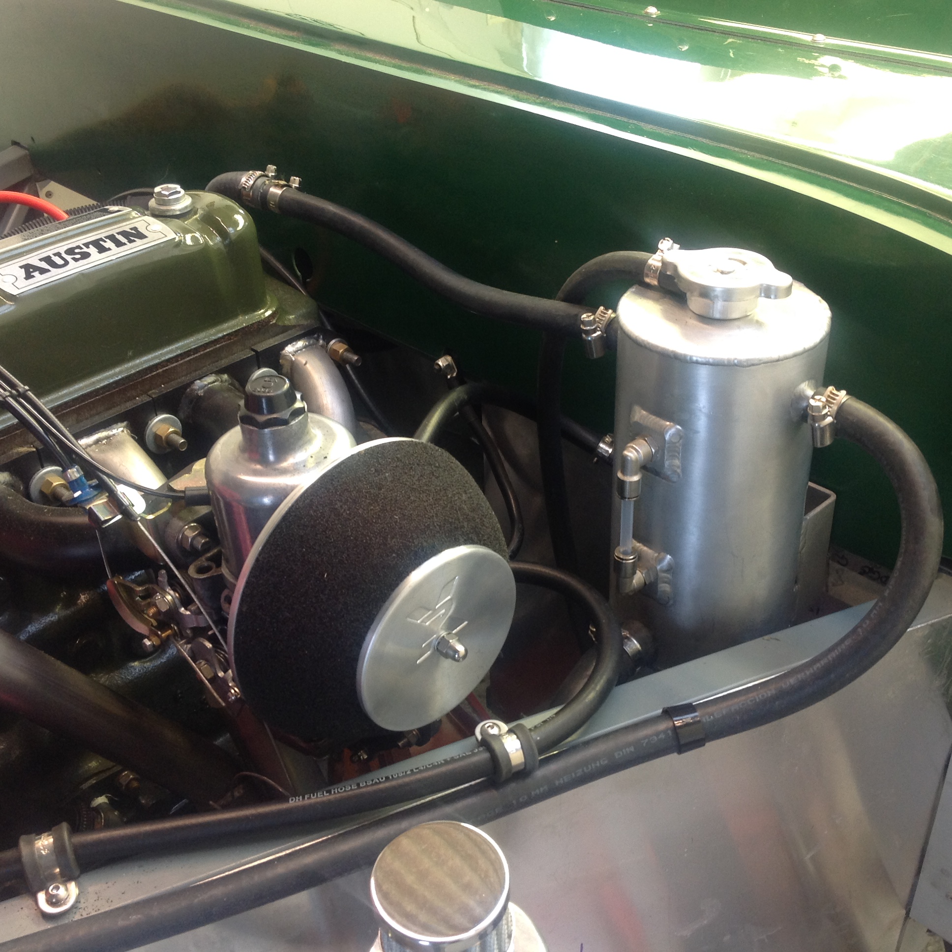

Re: Expansion Tank Placement and fixing
The sight tube's neat!
- Posts: 1030
Yes, very!
Is that a Westfield tank, Daggers?
P.S. Very neat carb install!
Could you tell me who made that tank for you, it looks just what I need
Sorry to be a pain but excluding the overflow you seem to have 4 inlets could you tell me where all those hoses come from
Tank was custom made be Tigweld4U "www.tigweld4u.com" it's his universal header tank with a couple of mods to a sketch I provided.
The sight tube is part of his standard tank, took about 5 days to turn round including posting, he's a good lad.
The four inlets/outlets are:-
1.Bottom from rad -Std Westfield
2.Inlet r/h from top of rad - std Westfield
3.Inlet l/h from cylinder head (ex. heater takeoff)
4.Overflow from pressure cap.
The other rubber pipe in picture is the carb petrol overflow vented via a metal pipe that is just attached to the header tank bracket but not part of the tank.
