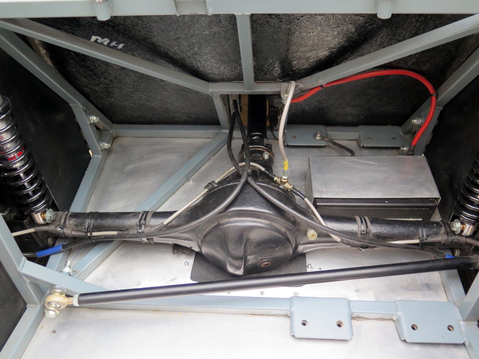

I have had a fruitful Easter weekend in my garage with my Westfield Eleven. Apart from changing the brake fluid and fitting a "puller" fan to the radiator (and thereby losing the large, restrictive to air flow, laser cut front mounting of the factory supplied "pusher" fan), the main task was to fit longer Protech dampers and springs to match.
I have read much about the benefits of doing this and have bought 400 series 1.9" o.d., single adjustable (which controls bump and rebound), bearing mounting top and bottom to suit 1.25" bracket width and 7/16" mounting bolt. The fronts are 12.5" long, the rears 14" long. Springs to suit Front 7" x 300 lb, Rear 9" x 150 lb. Many thanks to Ian (Elva 11) for his help in arranging the purchase and collection of these items.
Westfield supply 11.5"/12" shock absorbers and 350/200lb springs - quite a difference.

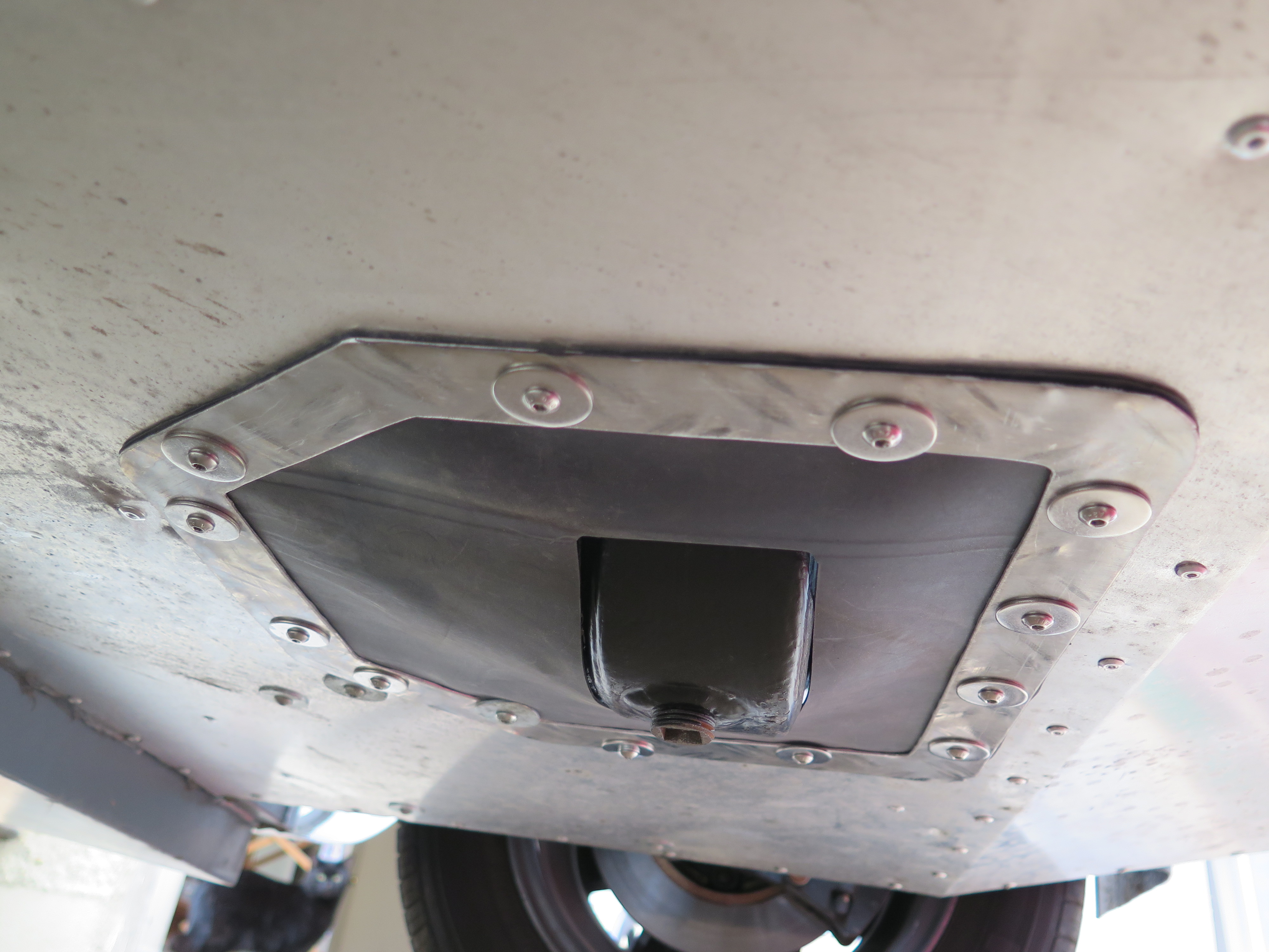

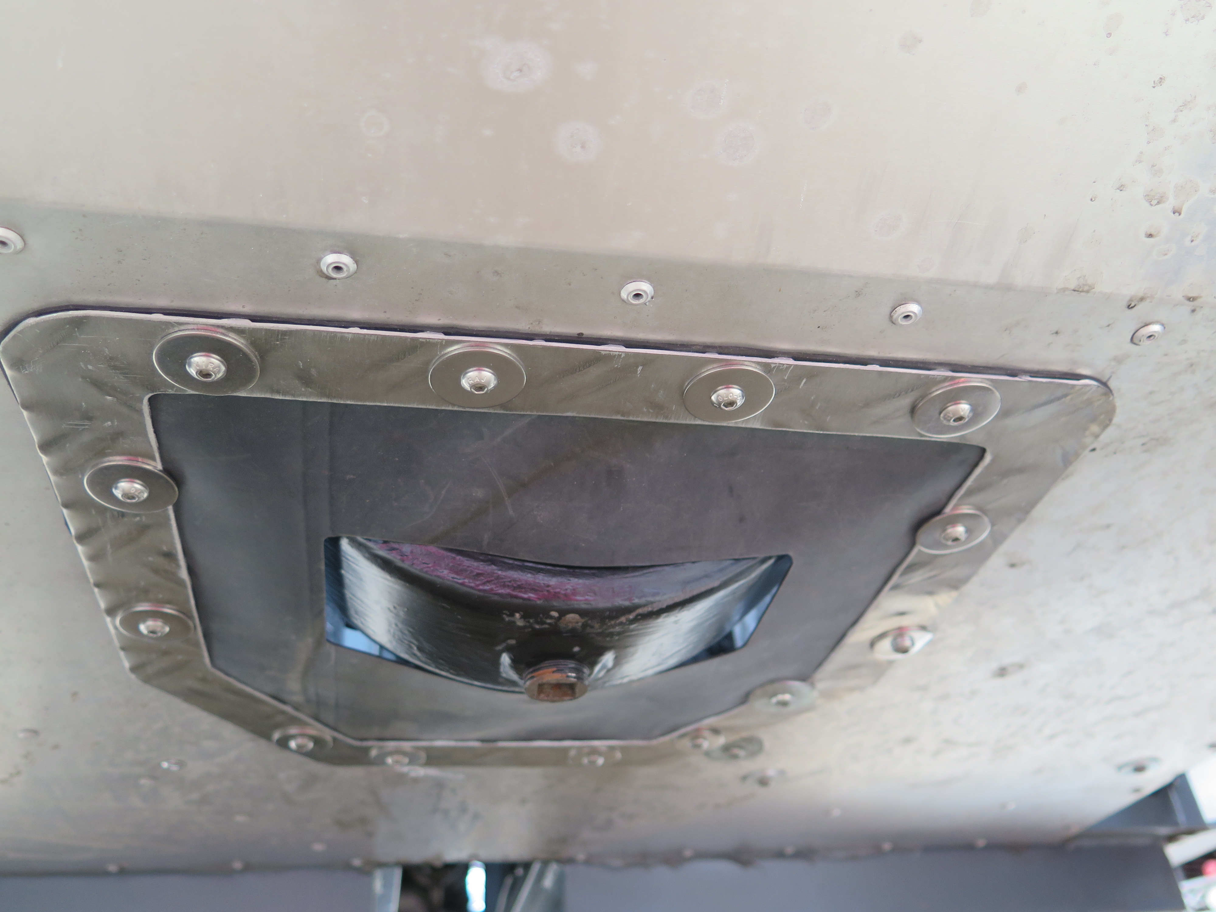

Fitting was straightforward - though the axle now sits lower in the chassis so a hole needs cutting below the diff housing to allow it to drop. I decided that, rather than leave this hole fully open and allow (even) more road grit to find its way into the rear of the car, I would frame the opening and cut and fit a rubber sheet as a gasket).
After trial fitting the shock absorbers / springs, it was obvious that the lower trailing arm bolts would need their heads reduced to allow the axle bracket and bolts to drop down past the bottom chassis tube. I used a laser disc in a 4.5" grinder and my powerfile to halve the depth of the bolt heads.
With everything fitted, I was able to set the ride height much higher than I was able to with the Westfield supplied suspension units. I have (measured from the ground to the underside of the chassis at the axle line) OSF 5.75", NSF 6.00", OSR 7.5", NSR 6.75". I have seen these settings recommended as a starting point with these longer Protech suspension units and the NS/OS stagger allows for some driver weight. I will have the car corner weighted in due course.
After tidying up the garage and cleaning the car, It was time for the test drive. I screwed the shock absorbers up to four clicks (of 13) all round and headed out of the drive. It was immediately apparent that the car was softer than before but the real change was the lack of crashing out (as the previously fitted suspension frequently ran out of travel). A quick run down a straight road past a couple of nearby quarries where the road surface is rippled (by clay subsoil movement), and rutted (due to the heavy lorries) was so much smoother with the car properly running true. No grabbing from the rear as the wheels seemed to be in contact with the ground pretty well all the time.
I then stopped off at a friend's house for a while and I put an extra click into the rear dampers. Continuing the run round, I could tell that the rear was a bit firmer, but still there was no crashing out and I drove all sorts of roads, from poor surface lanes to the A34 dual carriageway where a section of road that sends my Renault Clio V6 pitching front to rear (with its short wheelbase), was an easy cruise. I even took a little air over a hump back bridge and, whilst there was a tiny rear end twitch to the right on take off, the car flew OK and landed without dramas.
The increased ride height took away all speed bumps and rutted lanes worries - another result!
There's still plenty grip and, as I am using more revs now that the mileage on the engine nears 1,000, the Eleven is turning into a really enjoyable sportscar. All in all, a most enjoyable 50 mile run.
Once I have a roll hoop in place (beneath the rear clamshell) I will head for a track day at Abingdon Airfield, continue experimenting and take it closer to its limits.

If you have everythig set up properly, you wil find that you will be able to change the car from a neutral handling balance to slightly oversteering with a single click of compression increase.
Also, if you weigh around 170 lbs or less, you can get within 2% weight difference from left front/right rear ("Wedge) to RF/LR with your described measurements. Check the ride height, then correct to your preferred number, driver installed. This is figured with half to 3/4 fuel on board, and the battery opposite the driver on an RHD chassis. This can be easily fine tuned on the scales with adjustment of a single rear damper to 0% Wedge.
Nice hole in the floor. I don't bother to seal that off, as I have a pressure washer to clean the chassis when I wash the thing, or I vacuum it out. I dont have rear wheel housings, either. It gets dirty, but it is easy to work on.
