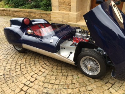

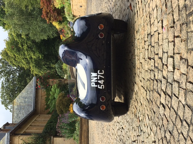

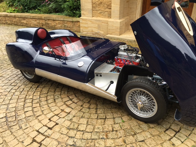

I have the XZXs fitted to 15'' MWS wheels (Jan's spec for the wheels - thanks Jan as ever for your input).  I too would love to fit 15 Dunlops but the prospect of losing my license here in the UK for having four illegal tires ultimately put me off. Come on Dunlop, certify those 15s....

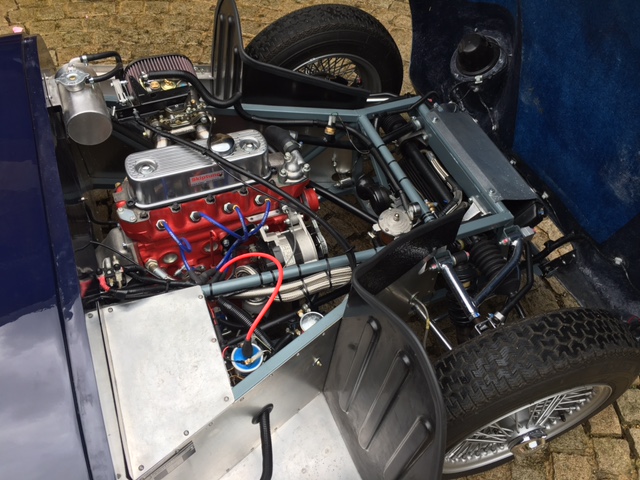

As Jan notes, the XZX and 15 inch wheel combination is very tight upfront. I have yet to fully set the car up, but adjustments to the light  pods are necessary and the turning circle is certainly restricted. I've also yet to look at what Westfield did with the steering rack to get my car through the IVA - they may have fitted restrictors.
I'm based in Ibstone near High Wycombe so if anybody wants to come over and have a look at the set up on the car,  just let me know.

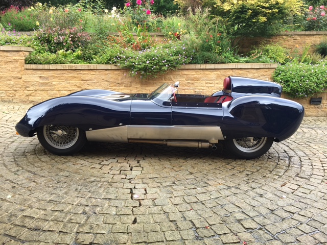

 A few pictures of the car on this wheel and tyre set up below

If your turning circle has been artificially reduced to stop the wheels rubbing at lock, it's almost certainly no more than a nylon tube jubilee-clipped to the track rods. Peal back the gaiters on the rack and there they'll be.

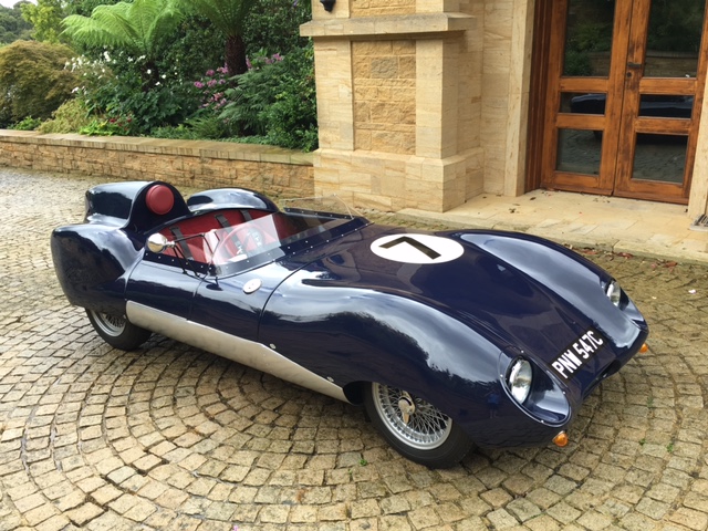

Ditto; the blue looks fab! And so does the gaff! Yours? The door in the background doesn't look particularly domestic, but you can't rely on that.....
In addition to the tyre make and sizes, can you remember your wheel dimensions? The back looks like Jan's beloved centre-laced jobbie, but what about the front?

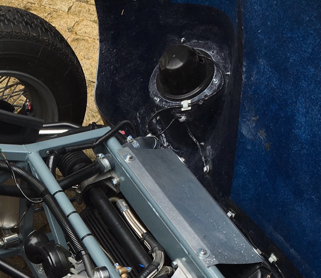

I haven't altered the light pods yet - you can see from the photo below the wear on the pods. Needs sorting. I've been on other projects but it's time to finish up this lovely little car.

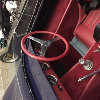

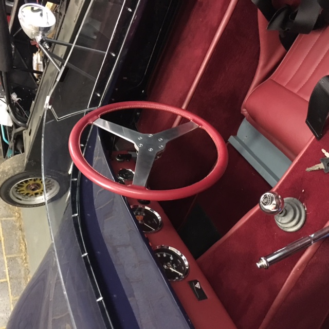

While I'm on, can I commend mark@jacobengineering.co.uk for their beautiful steering wheels. Fitted up with their quick release boss it's a joy. A few more pics

The ground off bits of the buckets are typical to cars with the ZX tires.
I don't use any limit stops on the steering rack with the 4.50X15s or the 185/70/13s. 'Doesn't seem to be a need.
The car ls lovely. I am going to make a note about the steering wheel, as I need a new one to replace the little 12" that is currently on my car.
