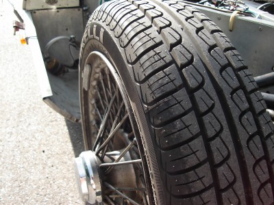

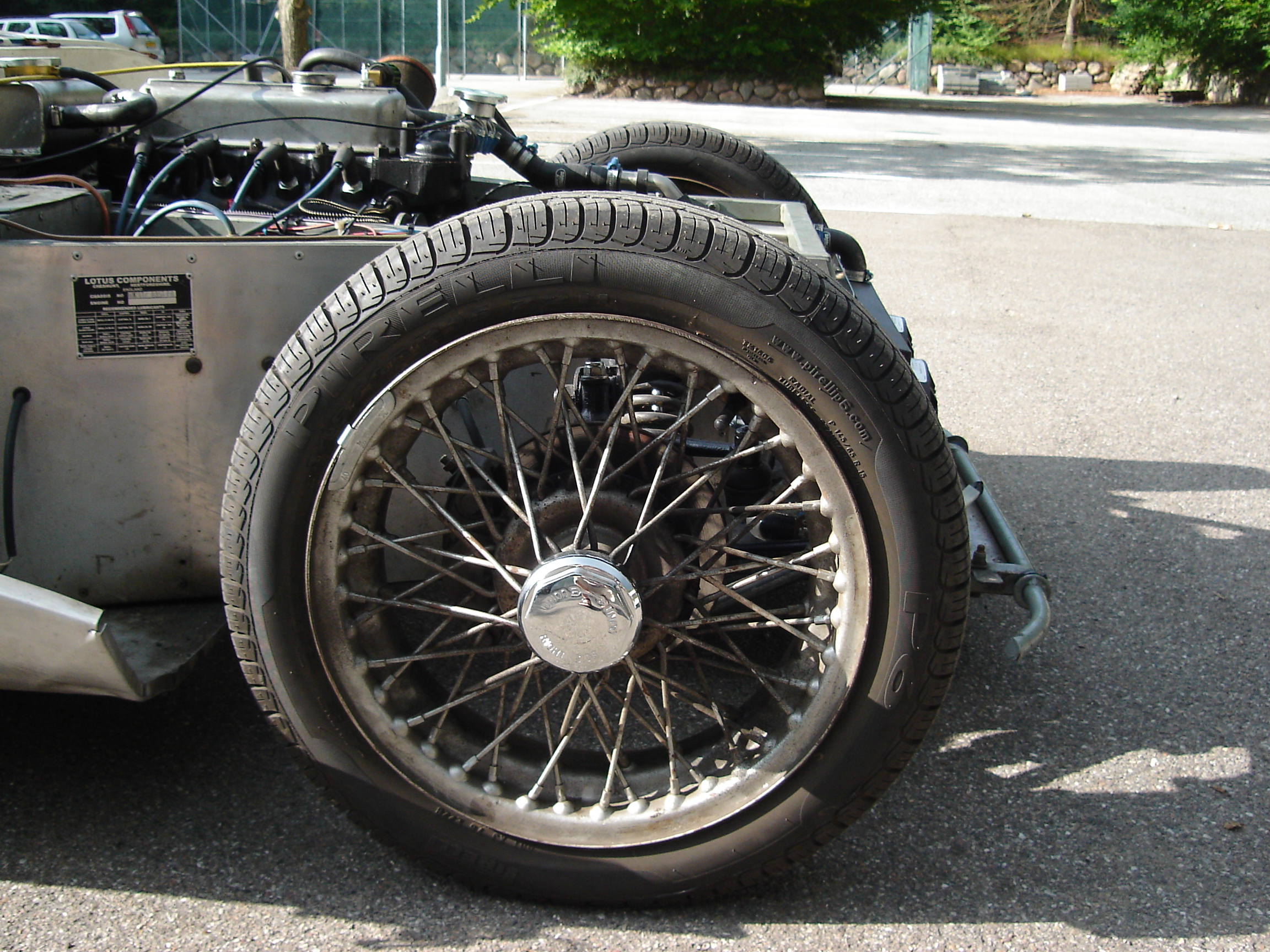

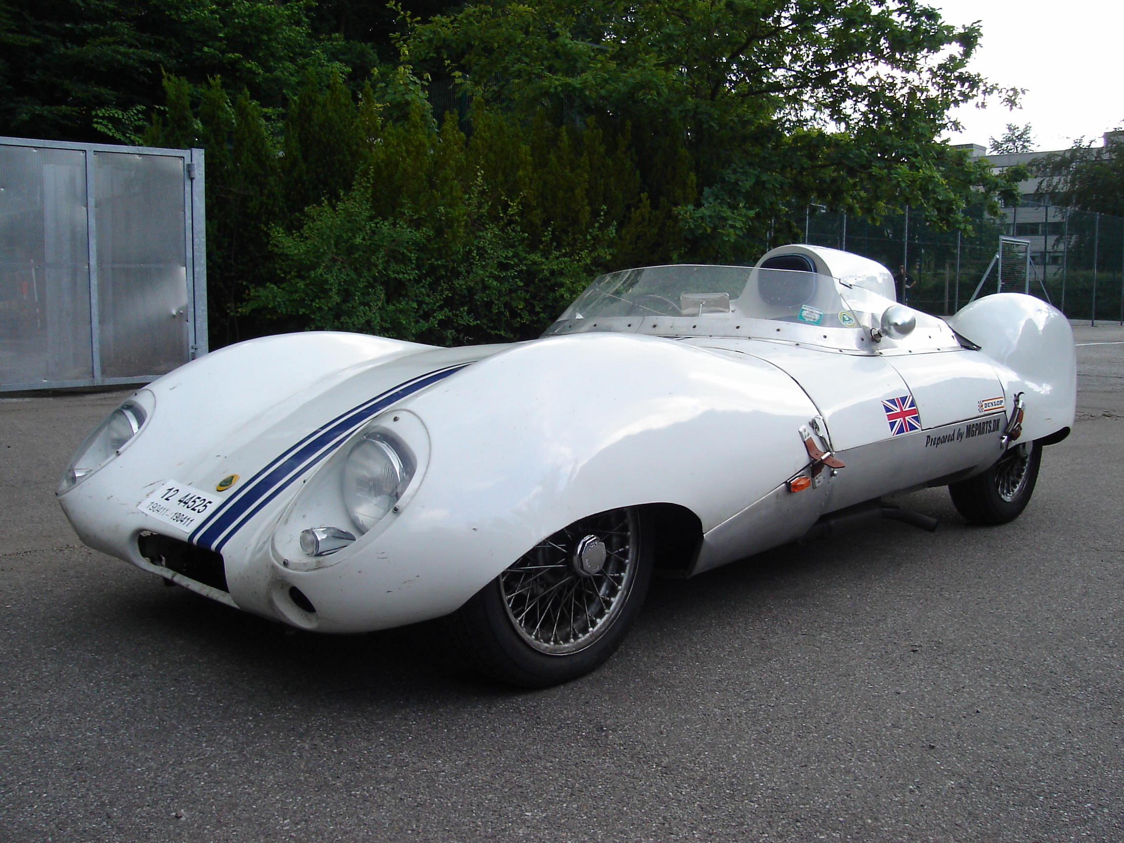

Have just taken some pics of my 15" AH 3000 wheels, so this is how they look
[attachment=2]DSC00004.JPG[/attachment]
[attachment=1]DSC00011.JPG[/attachment]
[attachment=0]DSC00012.JPG[/attachment]
Still front wheels
Still front wheels
How front 145/65-15 looks
How the car looks
How the car looks

Sweet. What is that 145/65x15 std fitment on?
I'm guessing a 155/80 x 15 fouls? That used to be a stock replacement size for VW Beetles.

I don't know what they are made for, I just asked my tyre pusher for a tyre in that dimesion.
Front is Pirelli (145/65-15) and rear is Dunlop Sport (165/65-15)

That is such a fantastic looking car. Just....wow!
Many thanks for the pictures. So, it sounds like you have 145x65x15's on 4.5" rims at the front? Interestingly the chap i've been speaking to at MWS said he would strongly recommend going down to a 4" rim for 145's - he thought that 4.5" would be too wide for the tyre. I'll have another chat with him. He could supply me with 145/65's on an AH 3000 60-spoke wheel, but it'd be 4", not 4.5". Not sure that there's any problem with that, mind. Charles, I assumed from everything that "Westfield 129" (sorry, don't know your name) kindly posted below, a 155/80 is going to foul at the front. From his very detailed post below, I guess crossply sizes offer more options than radial (am I reading that correctly?), but I have never fitted crossplys to a UK road-legal car and, I must admit, I don't even know what the situation here is with them, how easy they are to get, whether they are road-legal, etc.
Thanks again for the photos, I'm kinda getting near to getting this sorted I hope....
