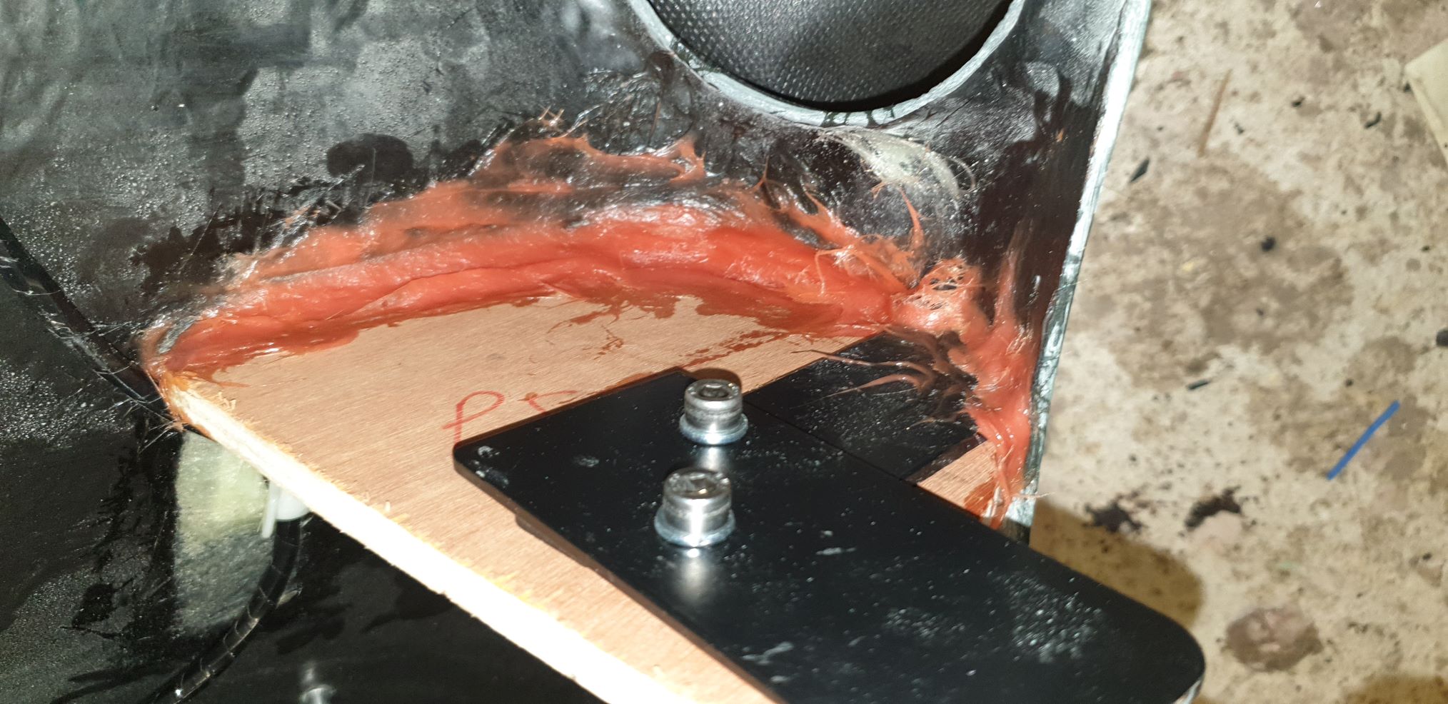

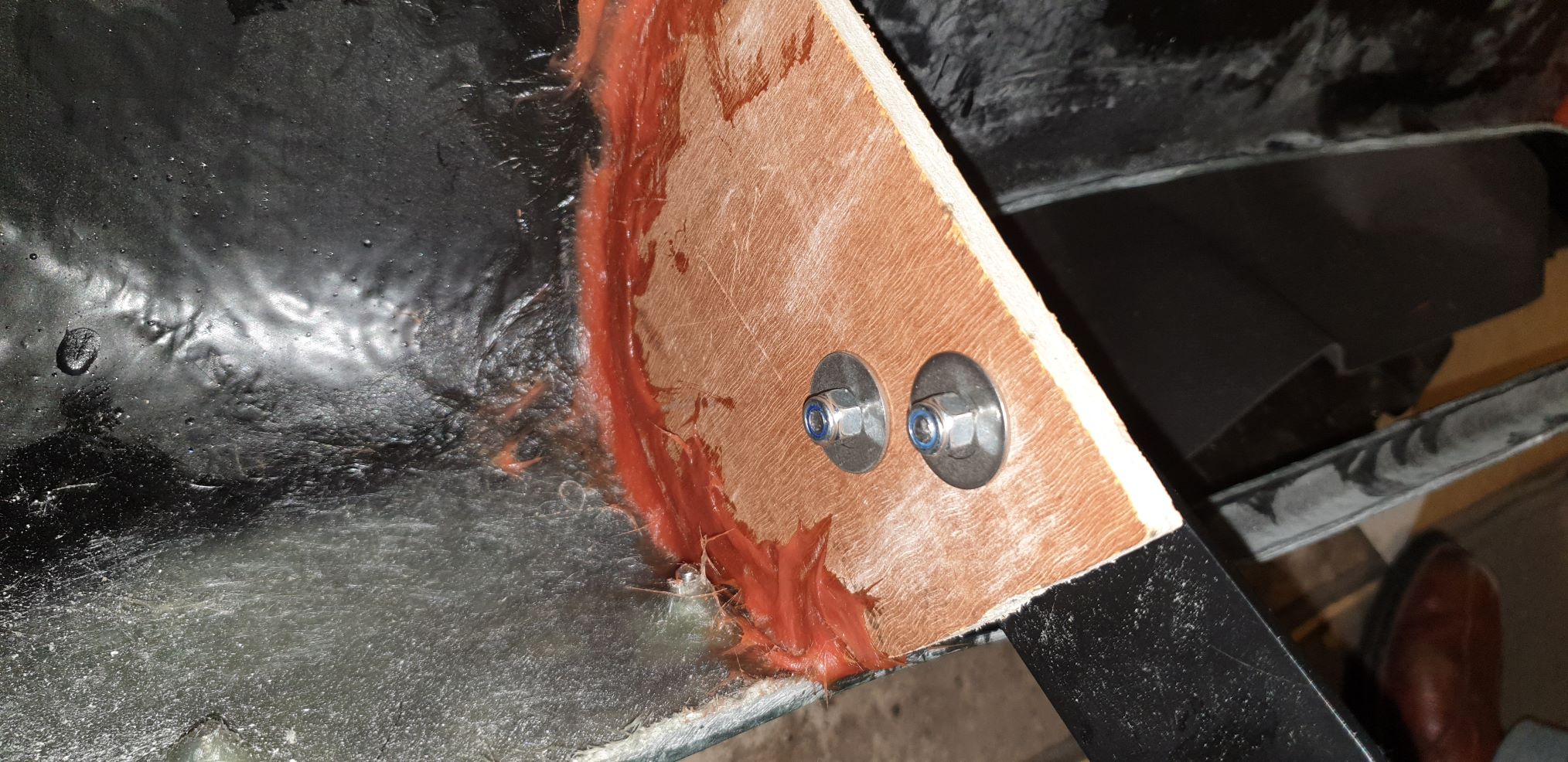

Glassing in the bonnet ribs as suggested by Jan. Just need to paint them black.
[attachment=1]bonnet rib.jpg[/attachment]
[attachment=0]bonnet rib2.jpg[/attachment]

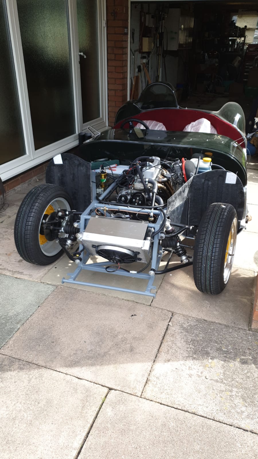

First drive out of the garage, I know not very far, but drives in first and reverse gears
[attachment=0]first drive.jpg[/attachment]

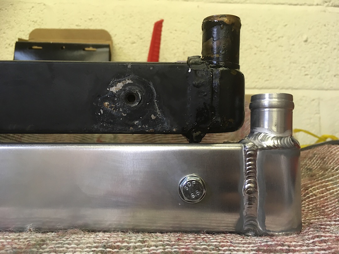

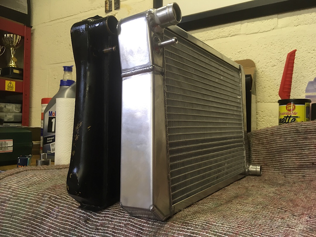

The photo on Peter May’s site is of a Radtec Racing radiator (even though it differs from the photo of a 1275 Midget radiator on their own site!). £312 +VAT from Radtec. They offer two core depths, same-as-standard 40mm and 50mm for the racers. They did me the latter for the price of the former. With a shrouded, front mounted fan, I have to be careful that I’m not running too COLD at times! Hot-weather track days and even last year’s scorching Le Mans trip, running hard in 35°C ambient temperatures, trouble the cooling system not one whit.

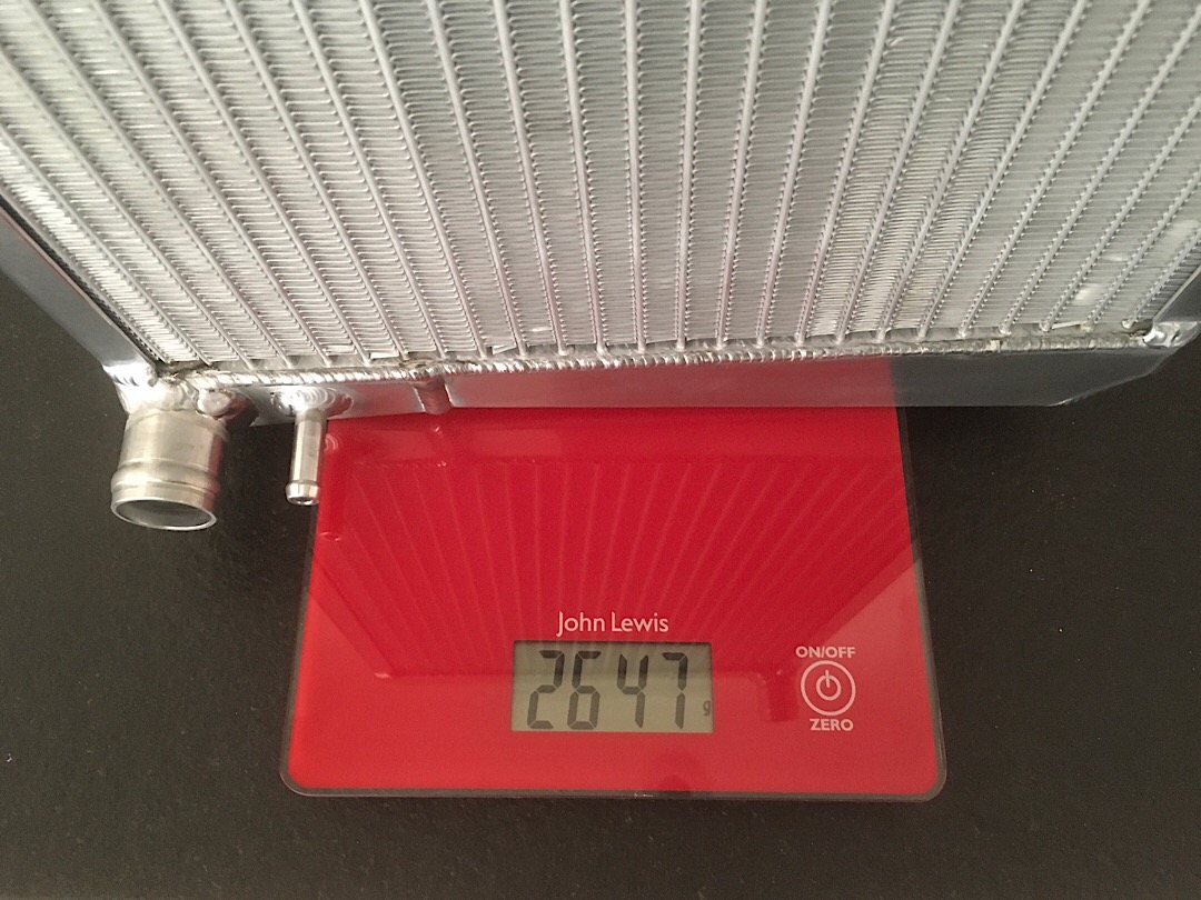

I used a double pass radiator (with both outlet and inlet on the same side to clean up the plumbing) that weighed 1KG in my last build, and used a much smaller fan. It also cooled "too much", but that's why I have a thermostat. I never ran into a problem in temps that ran from the low 40s F to a day in traffic/race day at Willow Springs at 110F.
It was a bit smaller than the original Spridget rad, which made packaging easier as it could stand nearly straight up. It was as wide as the front frame element.
