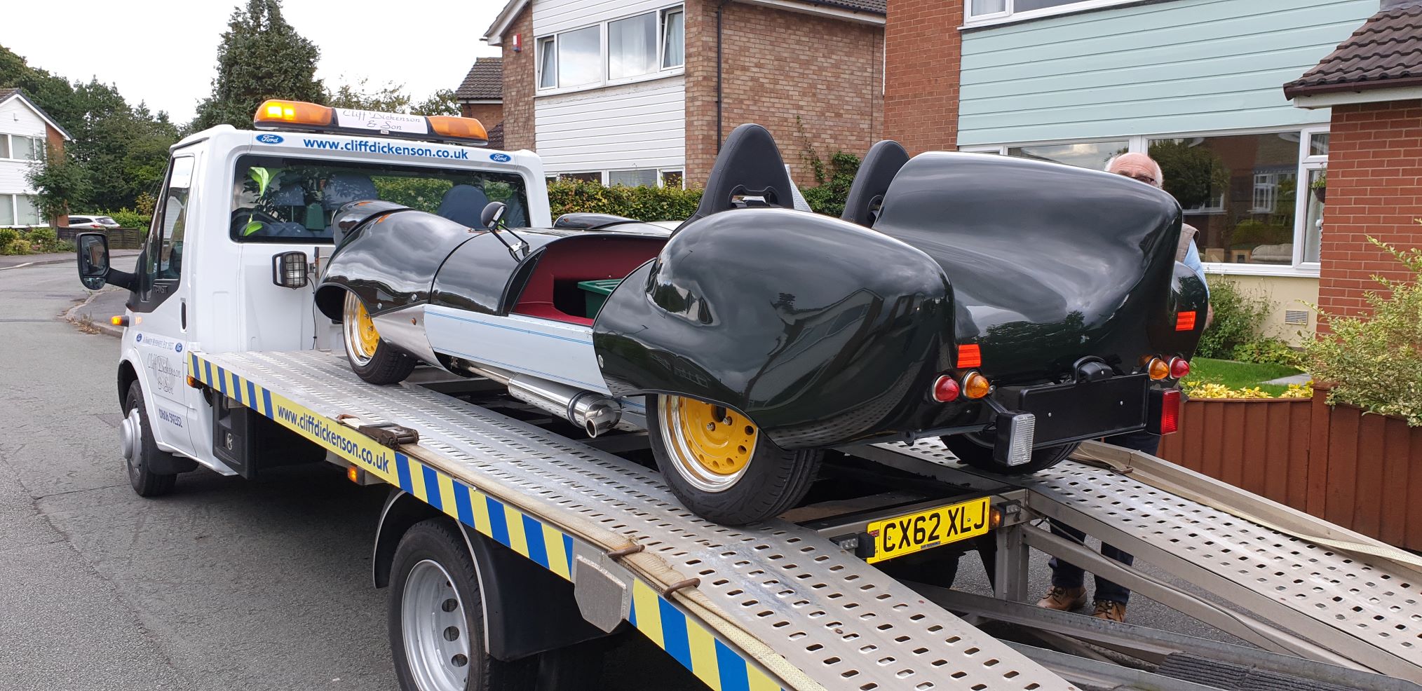

Well its too late now.... its on the transporter ready for the IVA tomorrow.
[attachment=0]transporter.jpg[/attachment]
Good Luck - three years (almost to the day) since I did mine!

Its a fail i'm afraid, nothing to much though. There was a fluid leak at the tee piece on the rear axle, no self centring steering, and a problem with one of the brake lights.
So I'm after some information on the steering... can anyone tell me the amount of thread shown their top wishbone, please. I think the self centring is controlled by the castor angle.
The best of us came away with a few little bits to sort - don't be too downhearted.
I can't remember the settings I used for my suspension. I'm pretty sure I set it up as per the build guide - but I did make sure that the car was sitting on four pads that were absolutely level when I did set it up. I'm sure that good advice will be along shortly.
As soon as I got home with small list of "to dos", I phoned up to get the next available test to give me a deadline. I was able to book for seven days later (no problem as sorting the issues out wasn't even a (Sunday) morning's work). It was at a different test centre but the examiner only looked at the items on the list. I didn't even have to take my car off the trailer but I am sure that you will have to do so to check the steering self centring.
