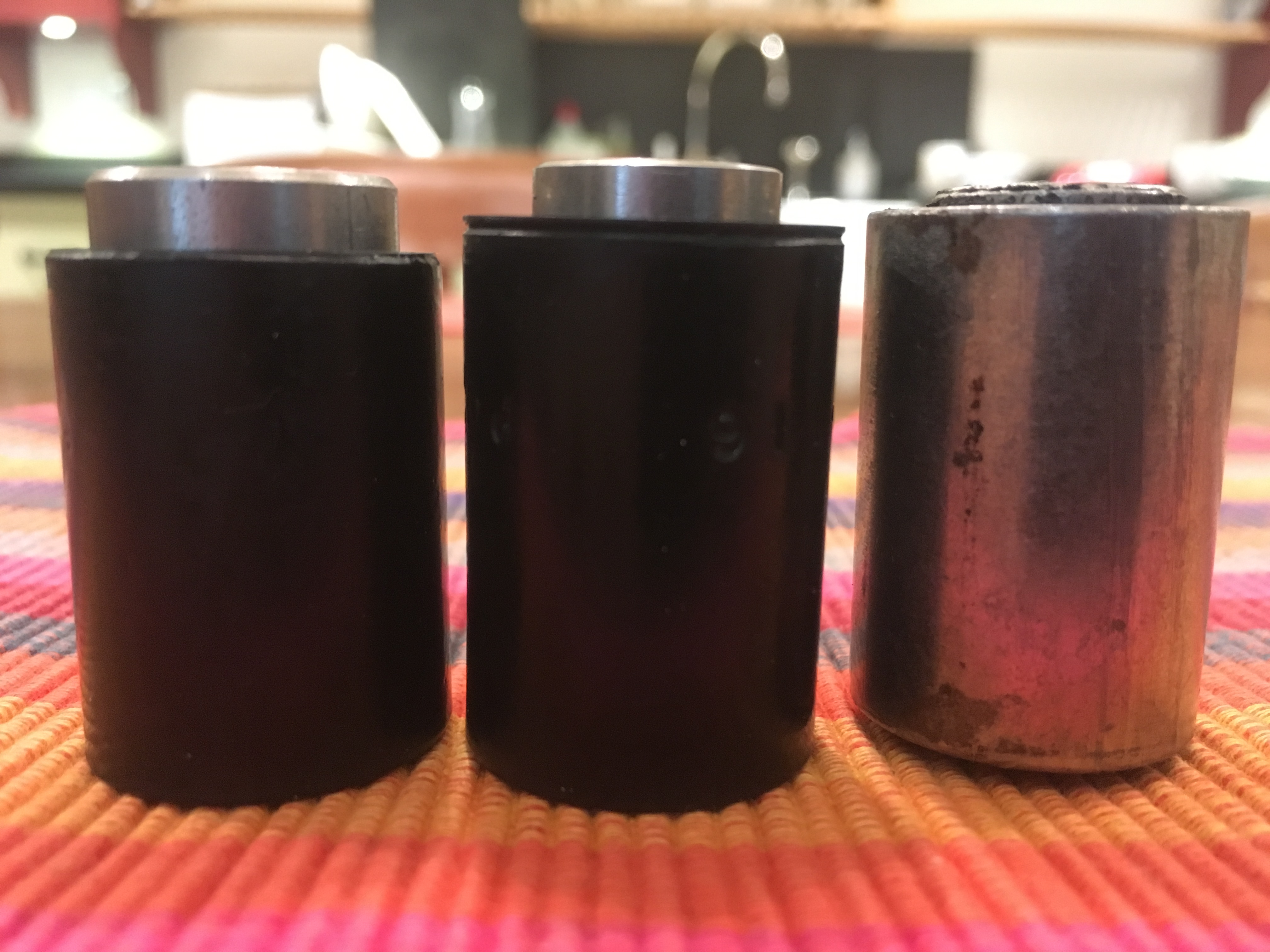

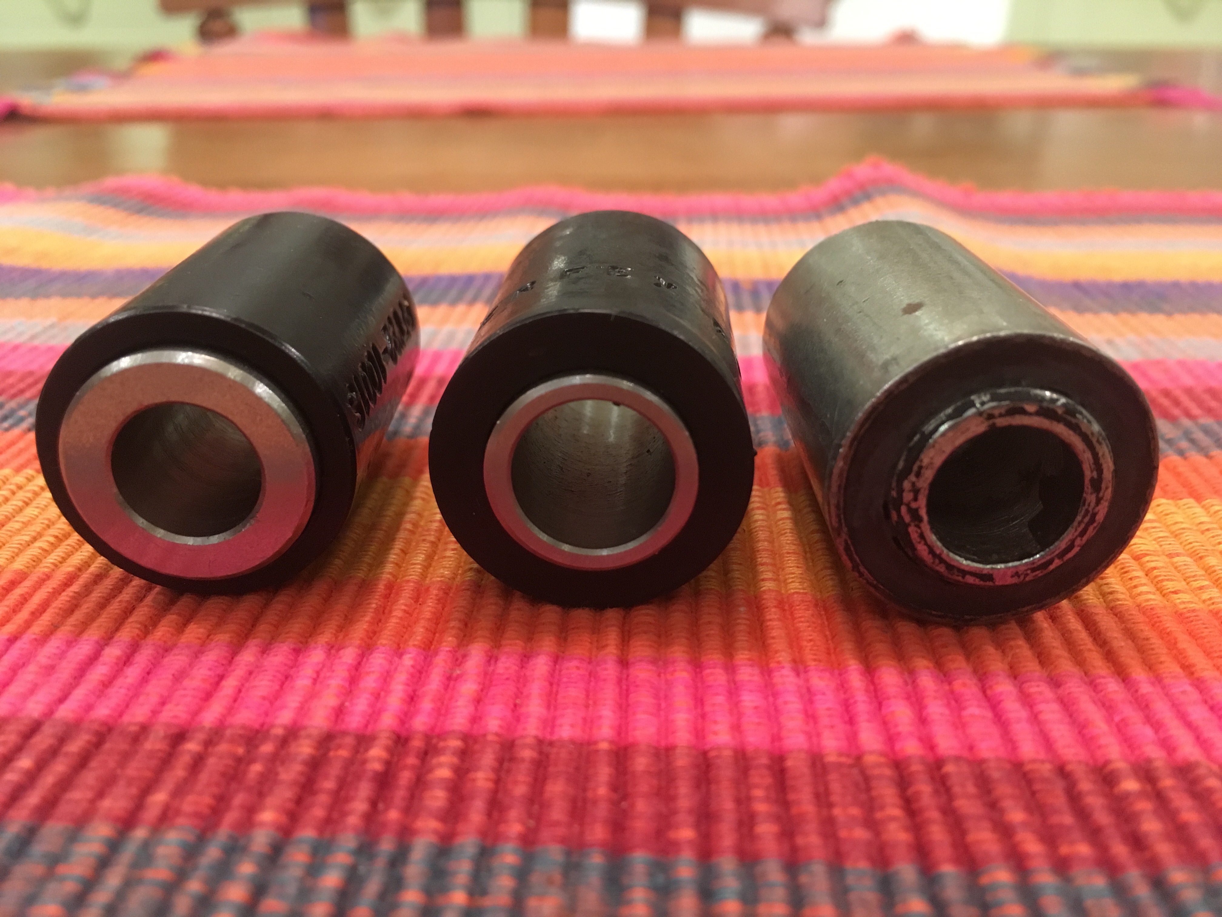

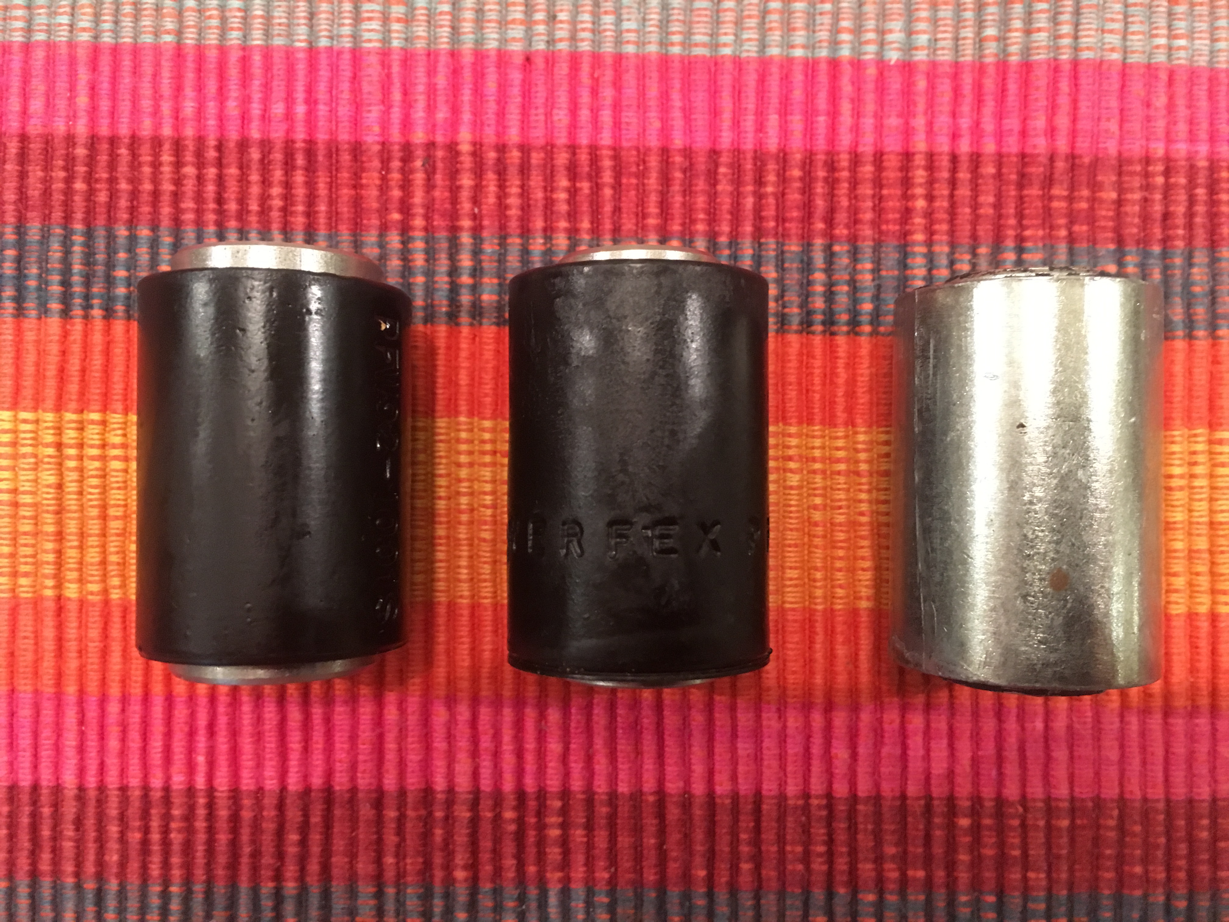

Photos below, but here are my observations and measurements:
Both types of Powerflex bushes (those from Powerflex and those from Westfield) consist of four parts; a stainless steel centre tube; a black PU sleeve with a knurled inner bore to slip over the aforementioned tube; and two plastic washers, one for either end of the bushing. The outside of the PU tube from the Powerflex pack is marked "POWERFLEX PF99-116". The outside of the PU tube supplied by Westfield is marked "WESTFIELD PFW92-1001S". However, the PFW92 (supplied loose, without packaging) is very clearly made by Powerflex (just from basic comparison with the Powerflex packaged PF99s).
For the measurements I shall use he following; M for Metalastic; P for PF99; W for PFW92:
The overall external diameter of the bush is; M 23.8mm; P 24.3mm; W 24.0mm. The Metalastic bush has a metal outer casing and is pressed into the suspension. The PU bushes have no hard outer case, hence the very slightly larger outside diameter.
The bore of the central steel tube of each bush is; M 11.1mm; P 12.2mm; W 11.0mm.
Most crucially, the overall length of the central steel tube is; M 38.1mm, P 38.9mm, W 38.0mm.
Which leads to some significant conclusions! Firstly, note the inner bore. 11mm is just right for the 7/16" bolts of an eleven. 12mm is for a modern M12 bolt. Secondly, the PF99 unit is 1mm longer than the Metalastic bush. The PFW92 is exactly the right length. So the "Universal Kit Car/Westfield" PF99-116 that is widely available, seems to be specified for a modern, metric chassis. The PFW92-1001S, not recognised on the Powerflex website, and only available from Westfield, is dimensionally identical to the original Metalastic bush.
There is only one fly in the ointment. Compliance! Compare the thickness of the PU sleeve of the two Powerflex offerings. The PF99's have 4.1mm of PU. The PFW92's are just 2.5mm thick! The photos speak for themselves.
In the following photographs the lineup remains constant: left to right; PFW92-1001S (W); PF99-116 (P); Metalastic (M).

Nice to see all the parts together.
Here in the US, the price of the bushings is about $200 for the rear suspension alone... Around $400 a set for the entire car. Expensive... Especially when they dont really fit everywhere on every W11.
The PF 99-116 inner sleeves that I have are bored for a 7/16" bolt. This was the first thing I checked when they arrived, as I was advised after they shipped that theye were 12mm bolts. Fortunately, that was not the case, and the factory documentation on the parts is in error.
The fit is fine correct for the 716" (AN -7) bolts. The bore on the part that Powerflex USA sent me is identical to the metalistic's inner bore.
Also, I have built a few of the late chassis, and those cars still feature all fractional 7/16" suspension attachment bolts and the same old metalistic bushings. This is one of the reasons that I build the cars with all fractional chassis fasteners, eliminating the need to carry two sets of tools.
I did notice that the Westfield supplied bushings did have a very thick central tube, with little material for compliance. This would be ideal for the front end, but problematic for the rear with the equal length 4 link, especially in roll.
So,.. I am still using a set of the Powerflex "kit car" part numbers at the front attach point of the 4 link. This will work on both early and late chassis (the shear plates can be spread slightly to accommodate the slightly wider Powerflex parts.
So far, these compliance bushings have extended the life of the axle end metalistic bushings. It is certainly possible to get the PF 116 bushings to fit, shortening the tube and the bushing itself, along with a slight milling of bushing mount in the suspension arm to accommodate the thrust washers, if you choose to fit them.
Eventually, I will get to doing this, maybe... I may just shorten the tubes and install the bushigns in the axle mounts without the thrust washers. I have an extra set...

The Westfield-supplied Powerflex bushes seem spot-on. Despite Jan's assertions, the 11mm bore is perfect for the 7/16" bolts used in the Eleven. The PF99 universal items, at 12mm bore, are definitely designed for the more modern Westfield chassis (SE, etc.) which uses metric bolts. Hence they're also a millimetre too long and won't fit between the lugs of the Eleven.
Westfield obviously gave a Metalastic bush to Powerflex and said, "Replicate this." Unfortunately, they took this literally and the PU compliant part is the same thickness as the rubber in the Metalastic bush, which is only as thin as it is because of the physical constraint of having to be sandwiched between the two metal tubes of the bush. Without this constraint, Westfield would surely have specified more compliance in the original Metalastic part.
So there's no more reason for the PFW92 part to bind than there is for the Metalastic bush to do the same. It would just have been nice to have the correct sizing of the PFW92 part combined with the greater thickness of PU given by the PF99 part, giving a more compliant, less noisy ride.
As the PU is not bonded to either the arm or the core, it shouldn't rip, unlike the bonded-in rubber of the Metalastic unit. The PU is lubricated within the assembly with PTFE-loaded silicone grease. Compliance should be the same and longevity hugely improved. Anyway, we'll have a better idea in the next couple of weeks when I've got around to replacing the five in my rear suspension......
