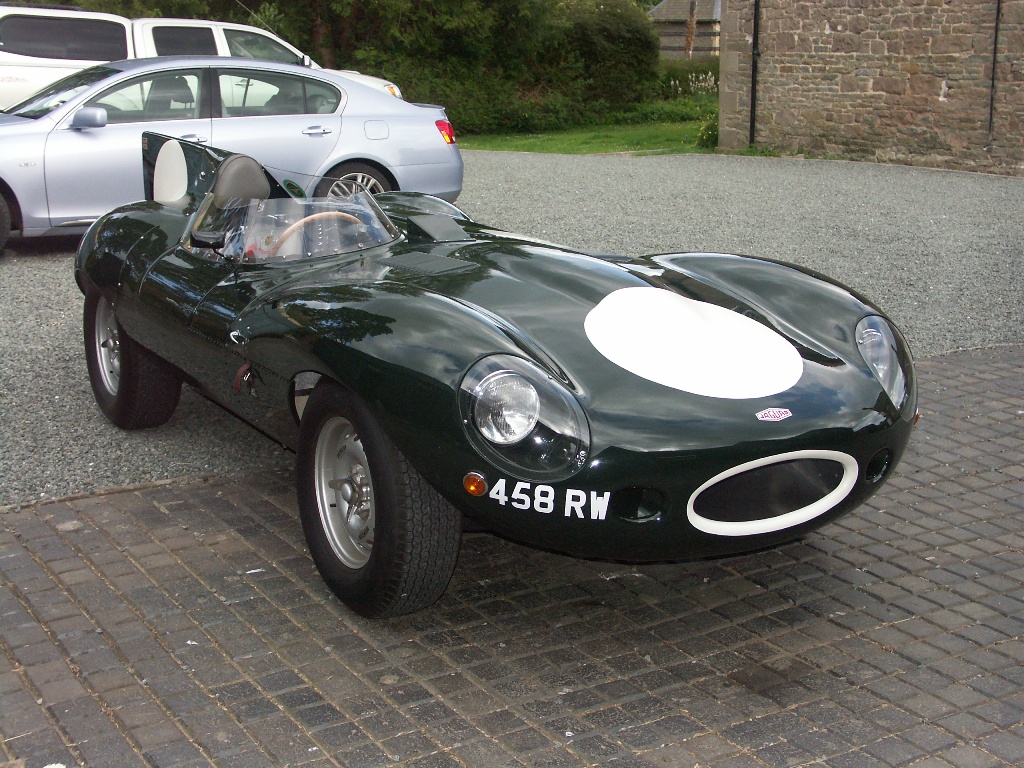

To get back on topic, I attach a photo showing those fat Dunlop racers. The 'MOT' man said 'as long as they have legal tread, they're fine'. The main problem is they cost close to £1000 for a complete set (4) and last about 8k miles. Since I only do around 2k miles per year in the D I do get a few years out of a set. Driving back from Le Mans with the DB3S's that are shod with Avon tyres, I could hear them behind me with their tyres squealing around the tighter swoopy bends, whereas the Dunlops are silent and grip better, so I can recommend them.
