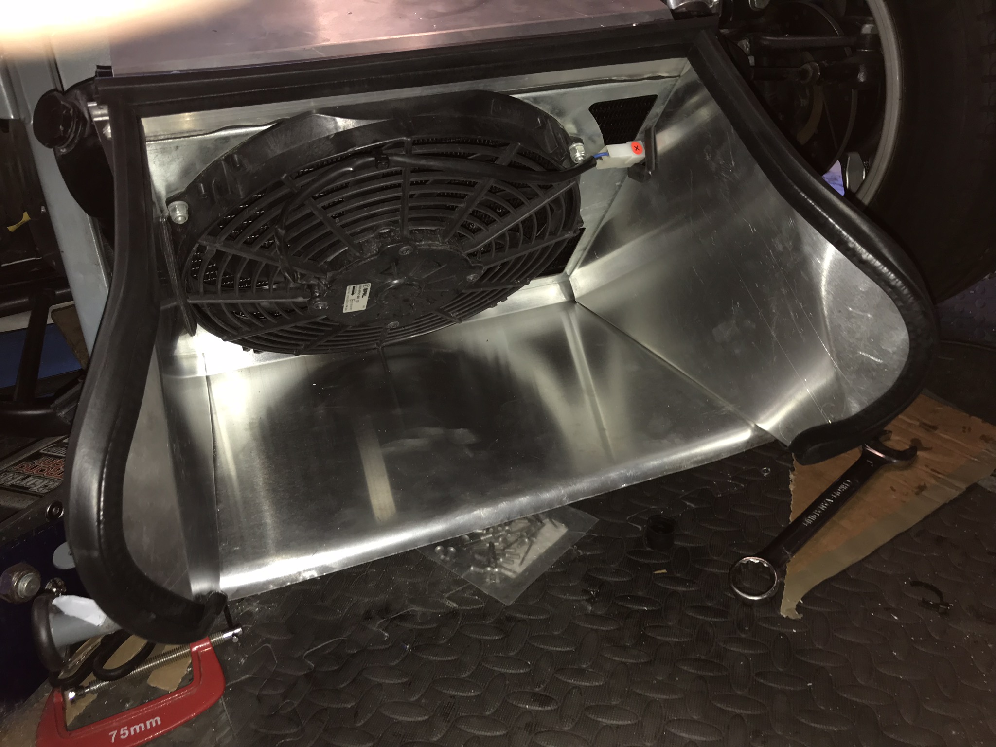

The retest is due 6th Sept so I will have a go at building ducting for the rad, it get hot as it is.
- Posts: 64
This is my solution followed by removing the Westfield fan bracket and mounting the fan directly on to the radiator. Last mod was to add an oil cooler and I now have no cooling or oil pressure issues even on very hot days at Le Mans last year.
Good move to get rid of the Westfield shroud (it blocks most of the radiator). That, along with attaching the fan to the backside of the radiator and run it as a "puller", you will drop a quick 20+F in temperature.
This is our standard setup in Southern California. The oil cooler also helps.
- Posts: 118
- Location: U.K.
I didn't fit the shroud during the build after reading comments about the problems it caused. The fan is mounted directly on the rad, but I think the cure is to build the ducting around the rad. I will leave the fitting of that until after the IVA is complete.

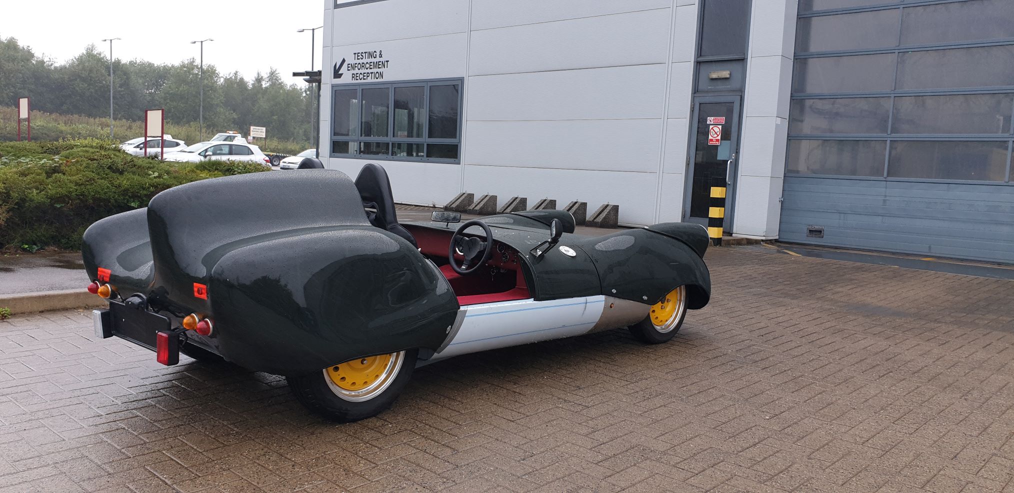

Took the car for its retest this morning...
[attachment=1]IVA2.jpg[/attachment]
Came away with a pass.....
