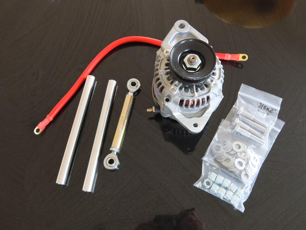

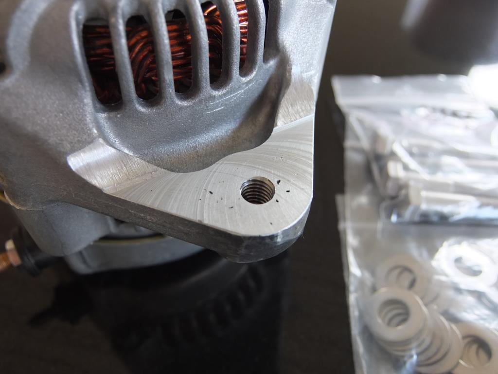

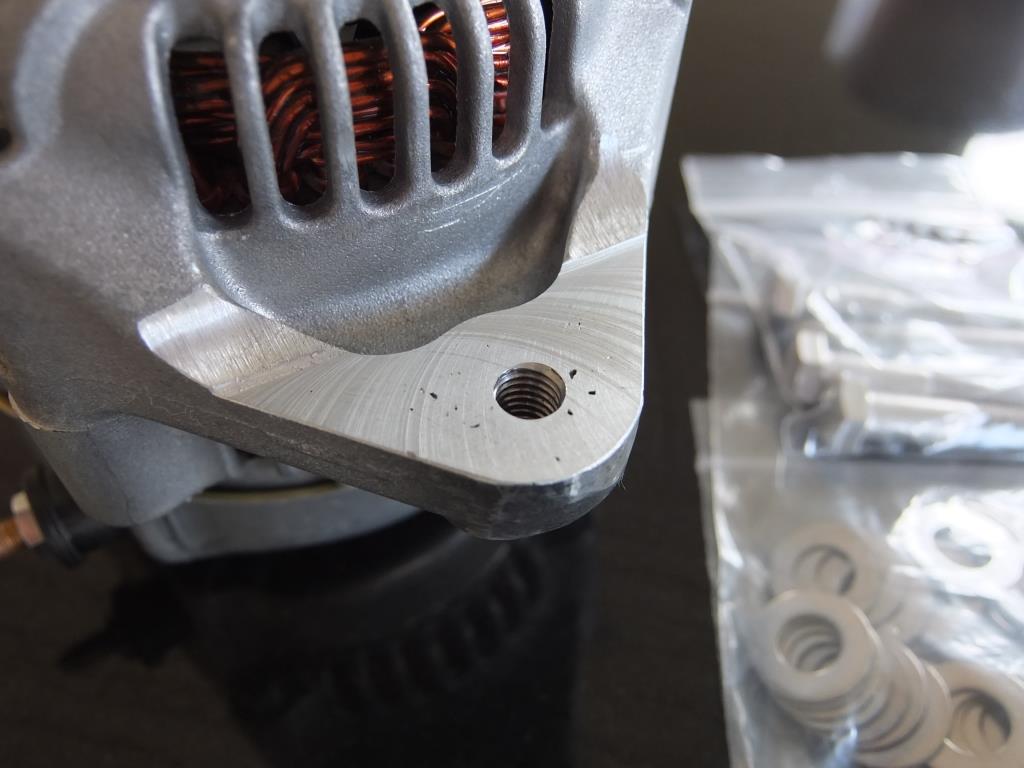

In the absence of any real progress (because I've been driving the car when I can and tied up otherwise), here are a couple of pics showing the stuff I have ready to bolt on (the ally tubing will make the approporate spacers).
I have yet to drill the alternator lug to 3/8", but you can see how good the milling is - and how porous the casting!
[attachment=1]alternator.jpg[/attachment]
[attachment=0]alternator lug.jpg[/attachment]

My lower bracket with the rod ends is quite a bit shorter than yours. My installation has a threaded rod length of only 2.5".
The milling job is really good. It's cut back enough so that you can get a good swing and a flat mounting. Perfect.
It's hard to hold the alternator in the mill to get a good cut.

Re: Small Alternator
Yep - need to cut down the turnbuckle and rod ends. The next smaller size from McGill was a little too short, but we'll see upon fitment.
The milling was set up to alight the tab with the pulley face. I have some pics and I'll dig them out and upload them when I get home. We used these stepped triangular blocks that I had never seen before - it took a few minutes to set up, but the milling took much shorter!!!
