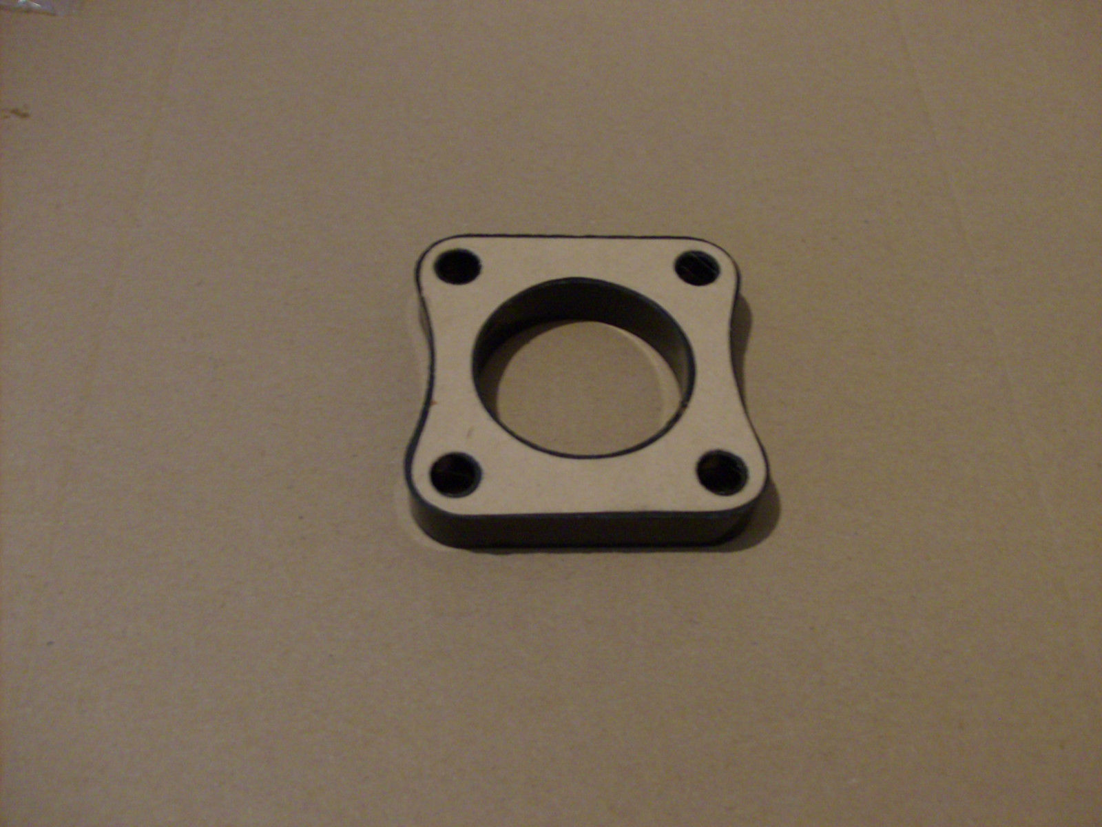

Jon, do you need the spacer betwen the manifold and the carb?
From tne pictures it looks like the fit would be better without it but I don't know what the function of the spacer is so something more important might be worse!
- Posts: 1050

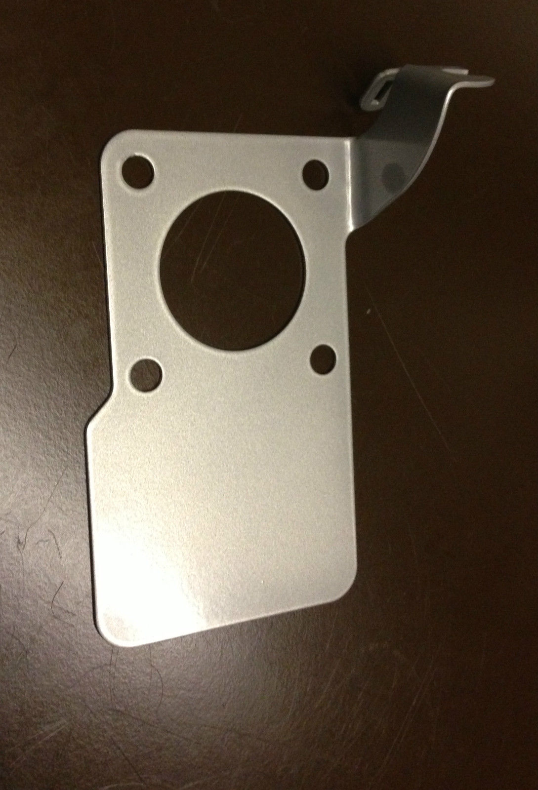

The carb integral float bowl needs to be away from the exhaust manifold. I have a heat shield on the way. I'll try a dry fit without the spacer, but the onger inlet tract = more torque.

Jon, would be great to know if it fits without the spacer as my carb doesn't have the spacer and I am hoping it will fit.

Also to add, Chris, that I picked up my spacer new from eBay. Ditto the heatshield.

You will need the spacer, as the throttle linkages foul on the inlet manifold. I''ll get onto Maniflow and ask them about producing a Westfield XI spec manifold.
