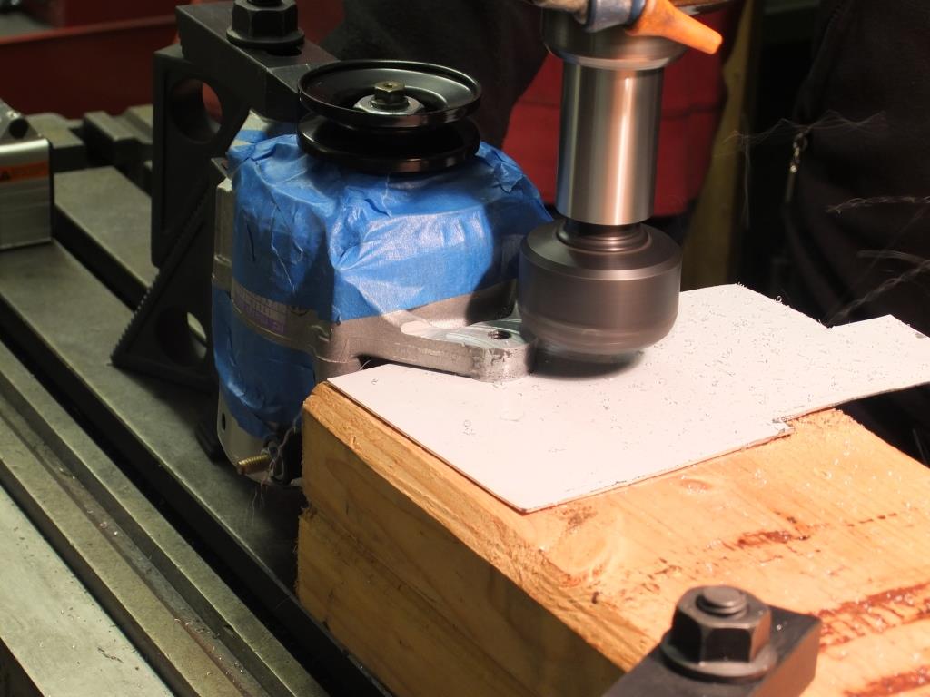

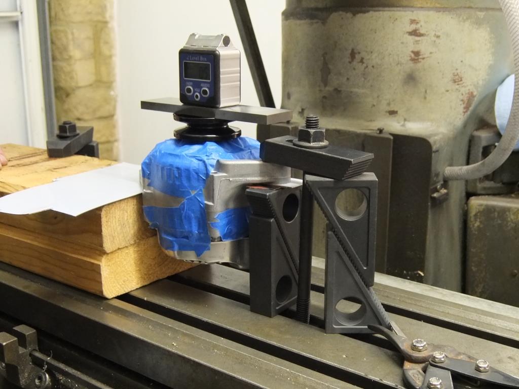

As promised, some pics of the machining process.
Sorry it's taken so long - I am up to my ears in work/revision/testing at the moment!

Teeny Weeny Denso alternator fitted. Genuine Denso MIJ item from E Bay for £80. After 35 years in manufacturing I really don't like to buy from China unless absolutely essential. Went and bought the correct connector for another £12.99 then found one on a scrap Corolla for free. So if anyone needs the oval 3 wire plug let me know - you're welcome to it. Used a hacksaw and filing to remove the 5mm or so needed to get it all to align. Didn't go the turnbuckle route - needed to use what I had to hand, so a modified Land Rover alternator adjustment bracket used. I found an 850mm x 10mm wide belt works nicely. Hopefully the last time I have to mess with an alternator!
