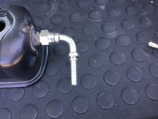

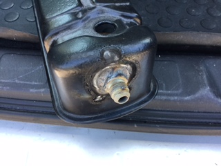

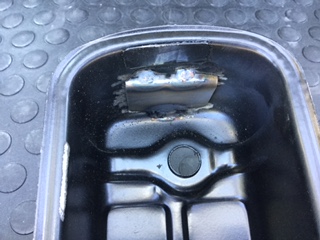

In other news, I have my modifed and baffled rocker cover back from Loaded Gunn. I'll post a (pre-paint) picture later...

Posts: 1050
Here are the pics as promised!
Posts: 70
Post by allymally »
Hey Jon, you must be expecting some pressure then! ;)
