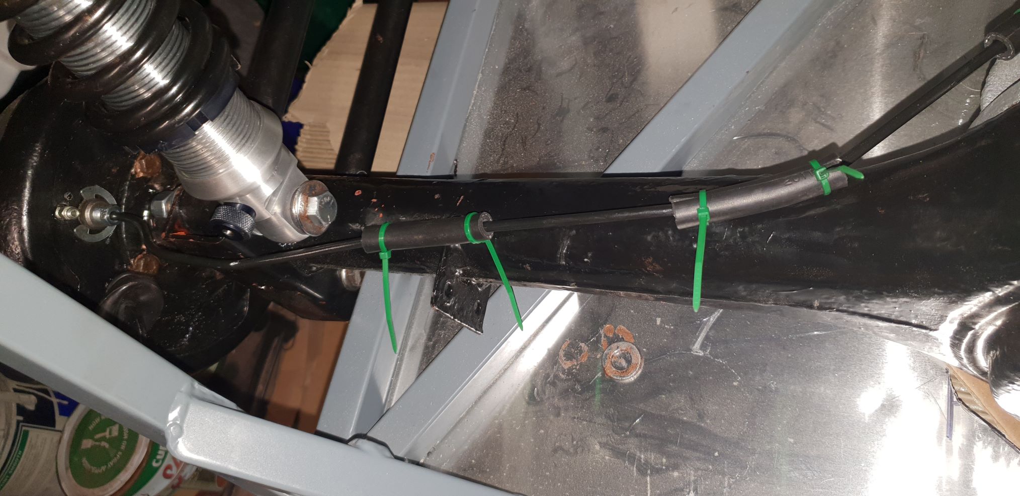

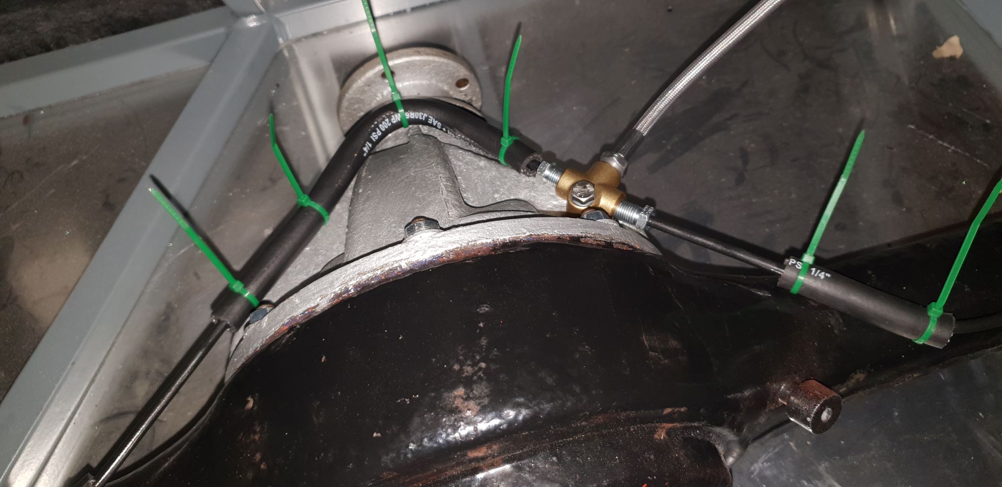

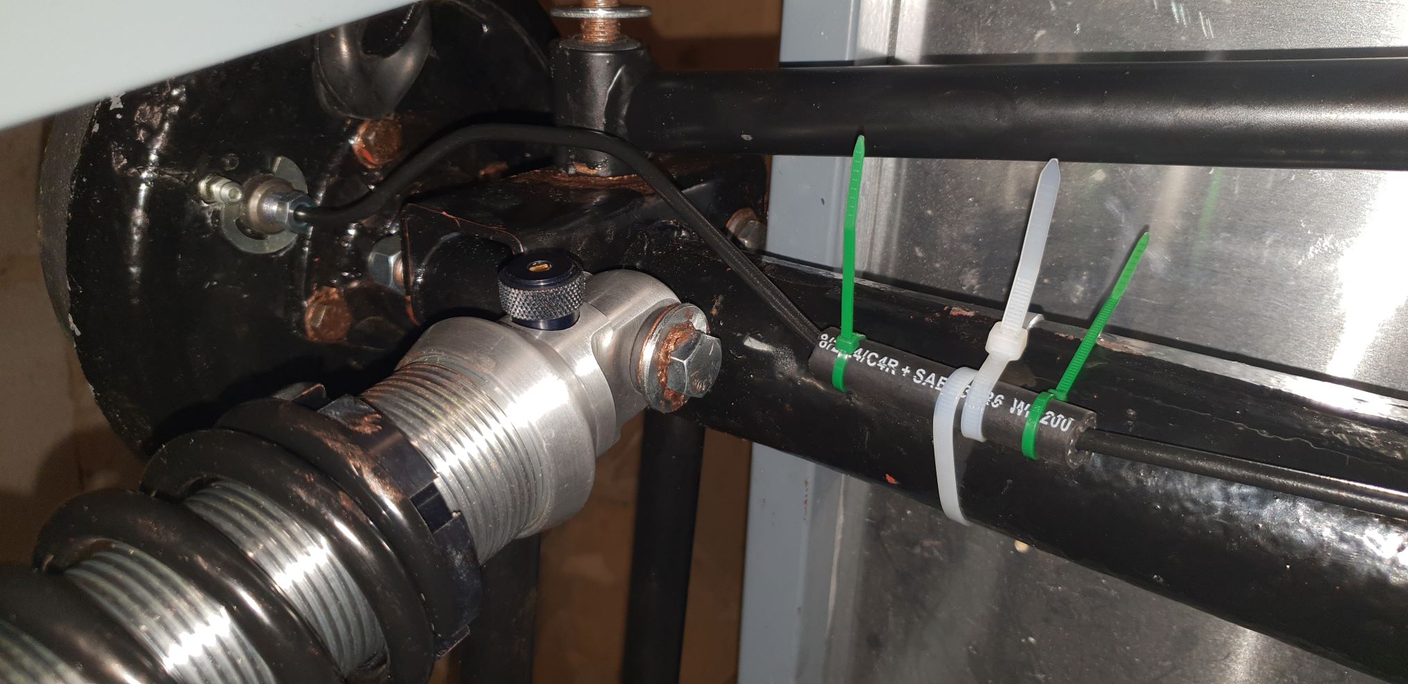

Sundays results.
I've turned the bolts which can be turned.
Trial fitted the brake lines on the axle, need to buy black zip ties
[attachment=2]brake line.jpg[/attachment]
[attachment=1]brake line 2.jpg[/attachment]
[attachment=0]brake line 3.jpg[/attachment]
