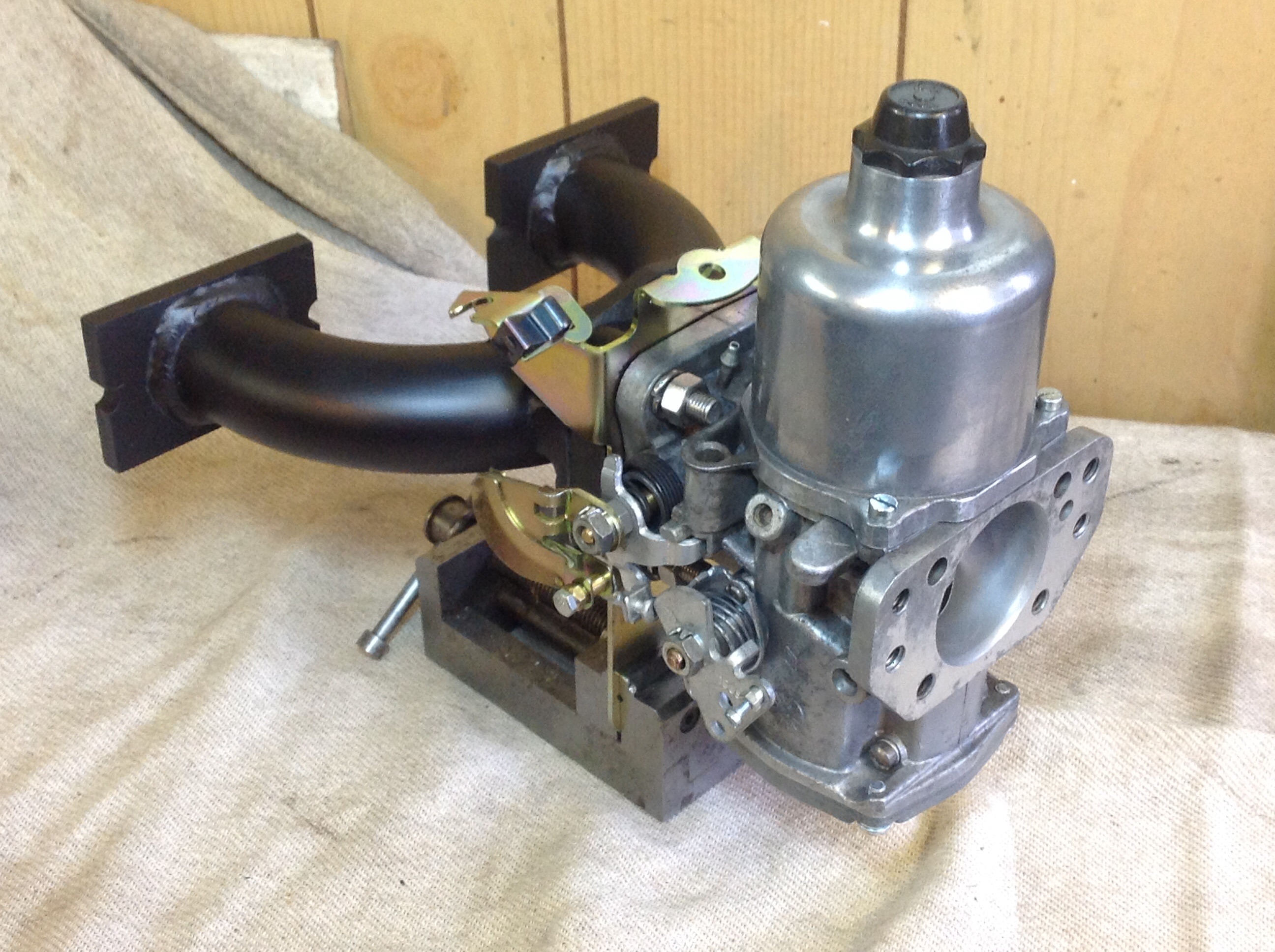

I have collected manifold, thanks for your help.
Hope to have engine in place in the next couple of weeks.
Daggers

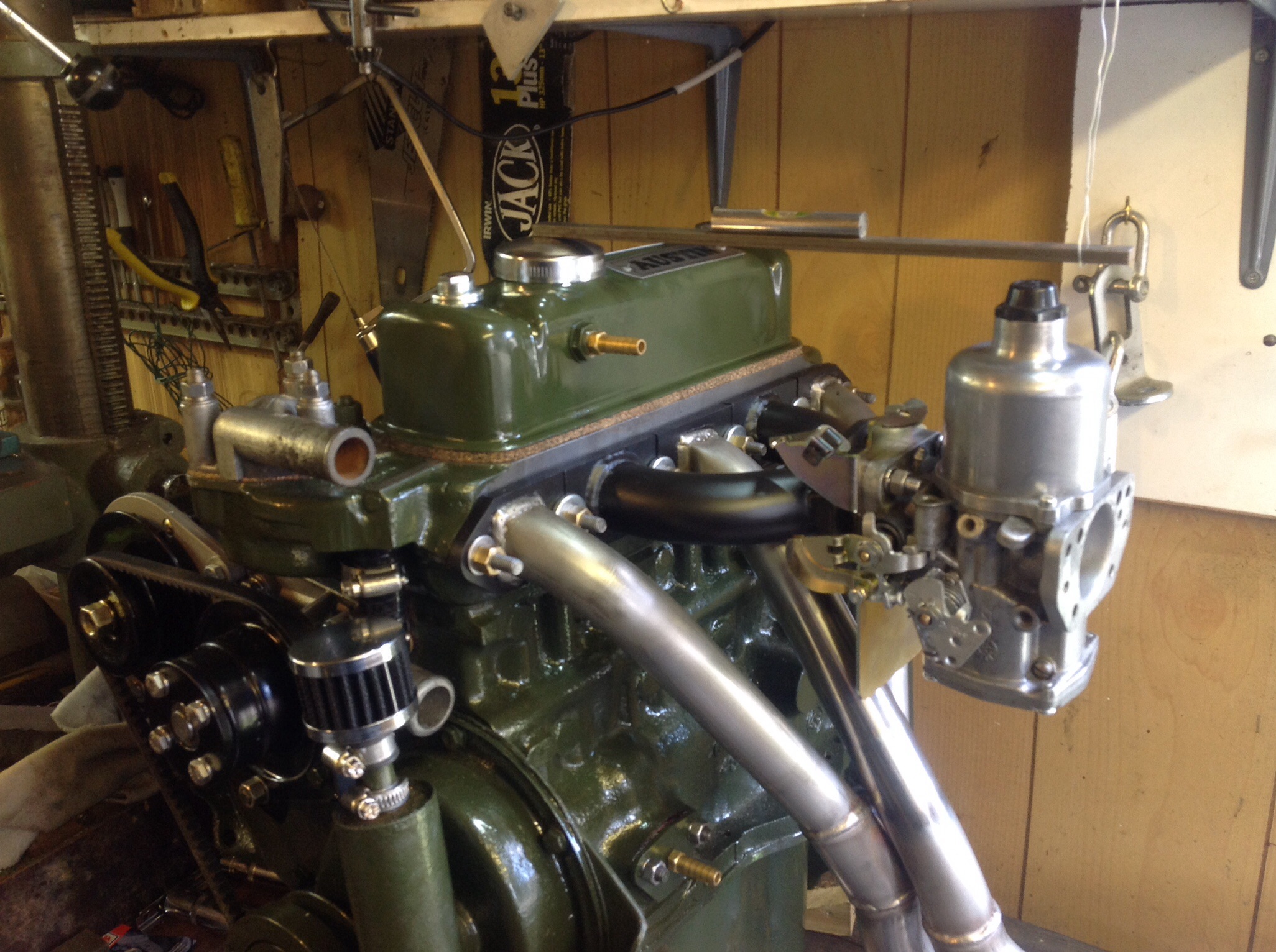

Just a final post to end a question I tabled.
Thanks to Jon for your efforts on the manifold, photo attached and congrats to your daughter.
Thanks again to Jan for all you posts, I attach a photo showing crankcase and rocker breathers also rocker cap modification.
Daggers
Daggers
