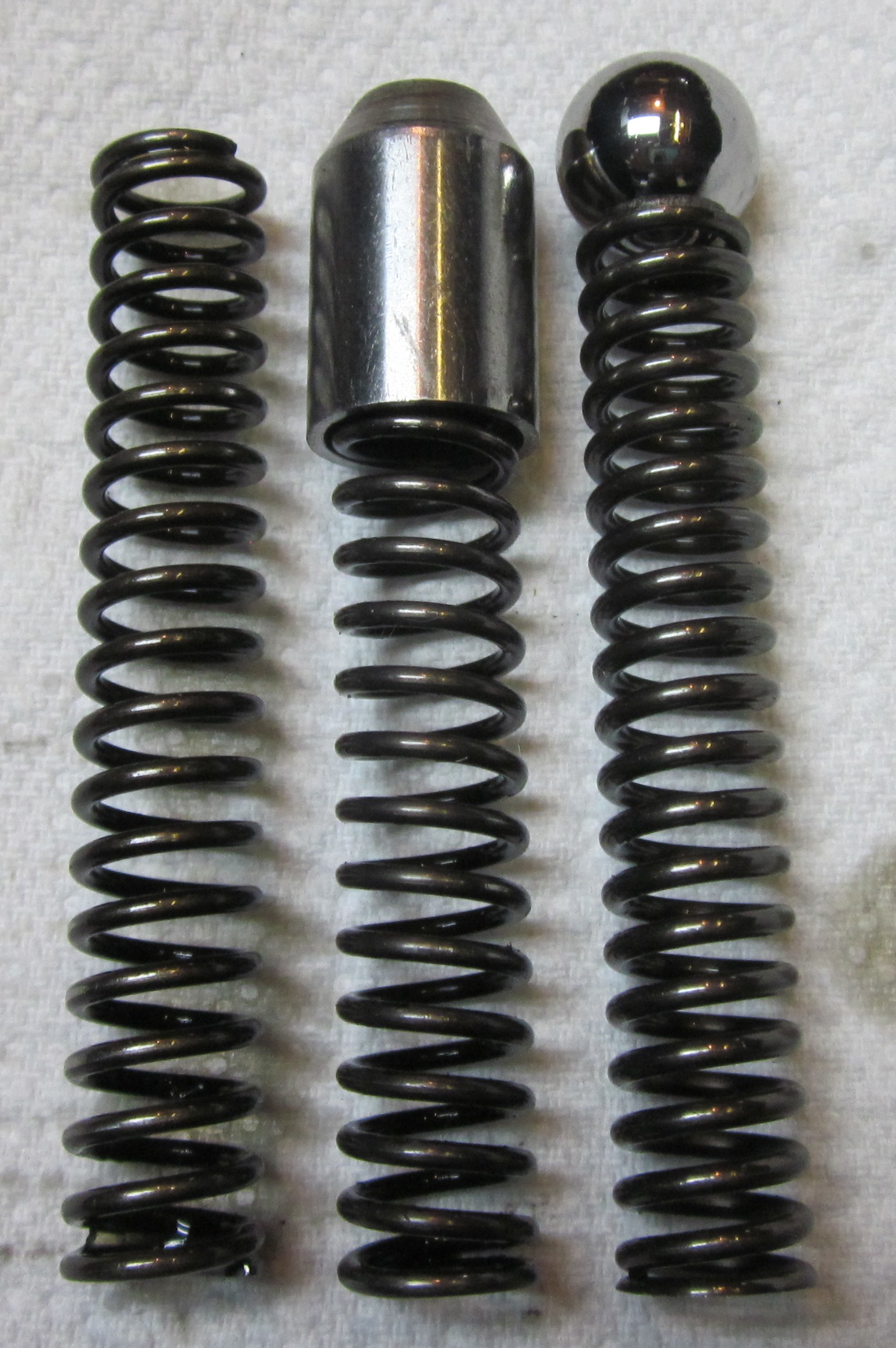

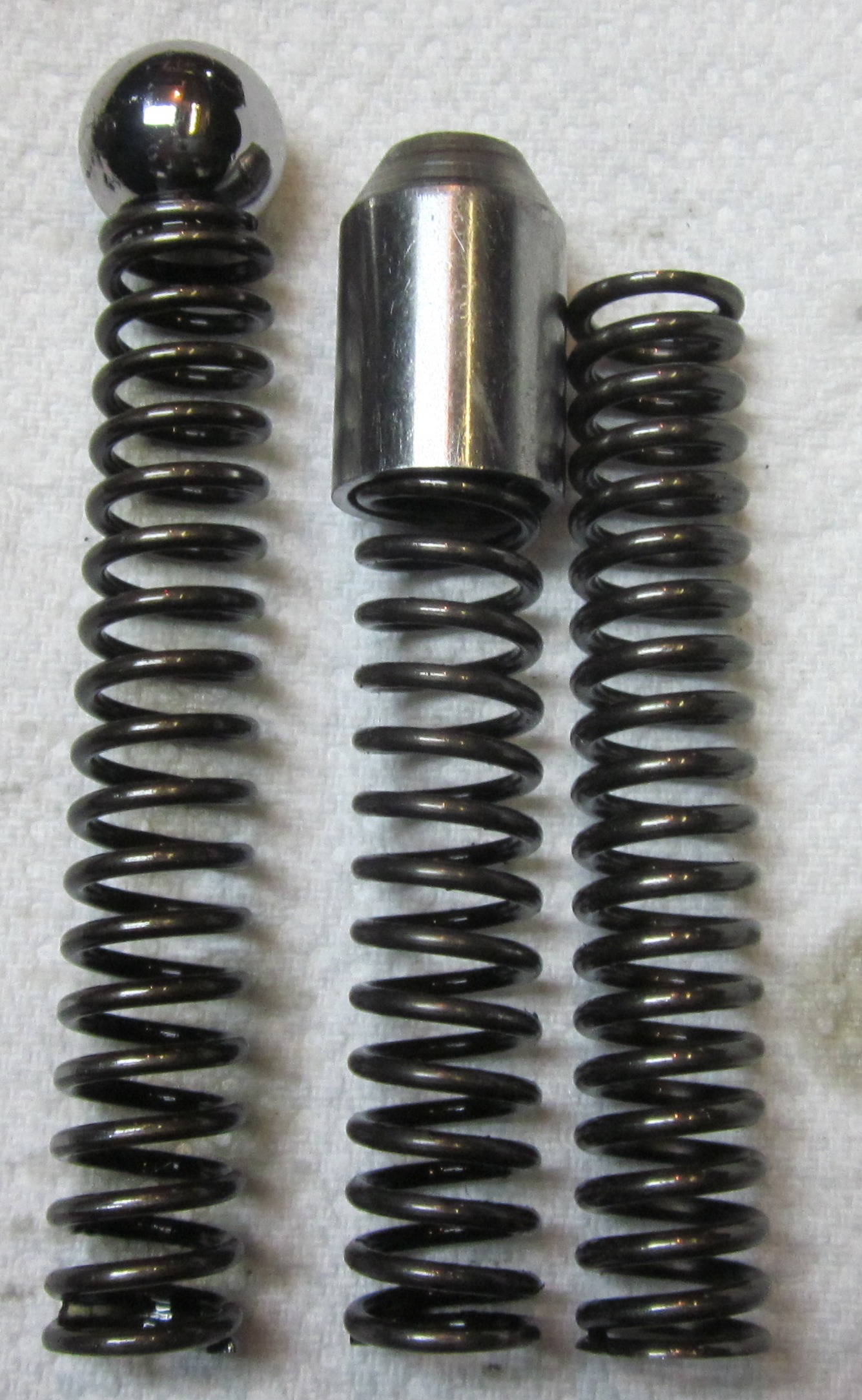

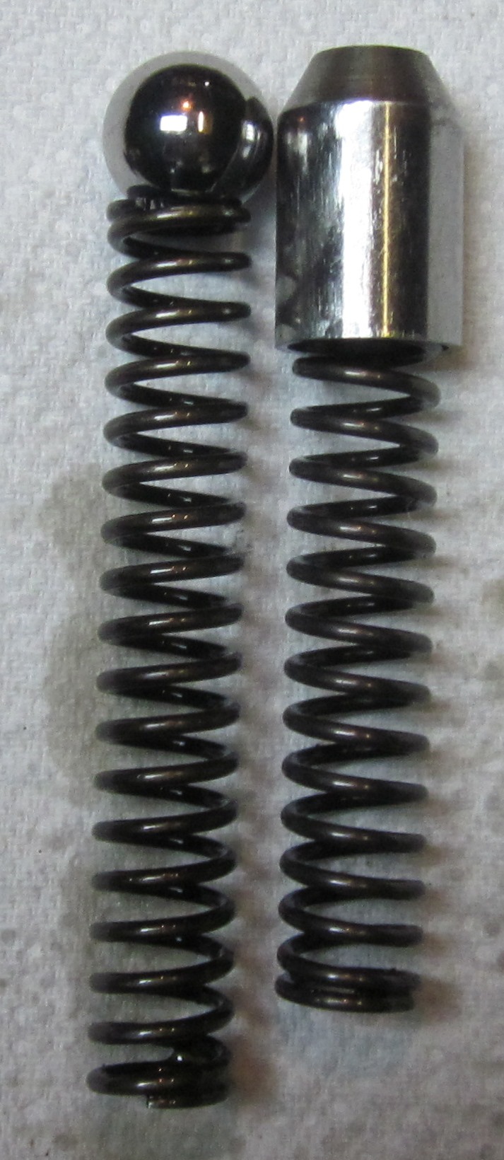

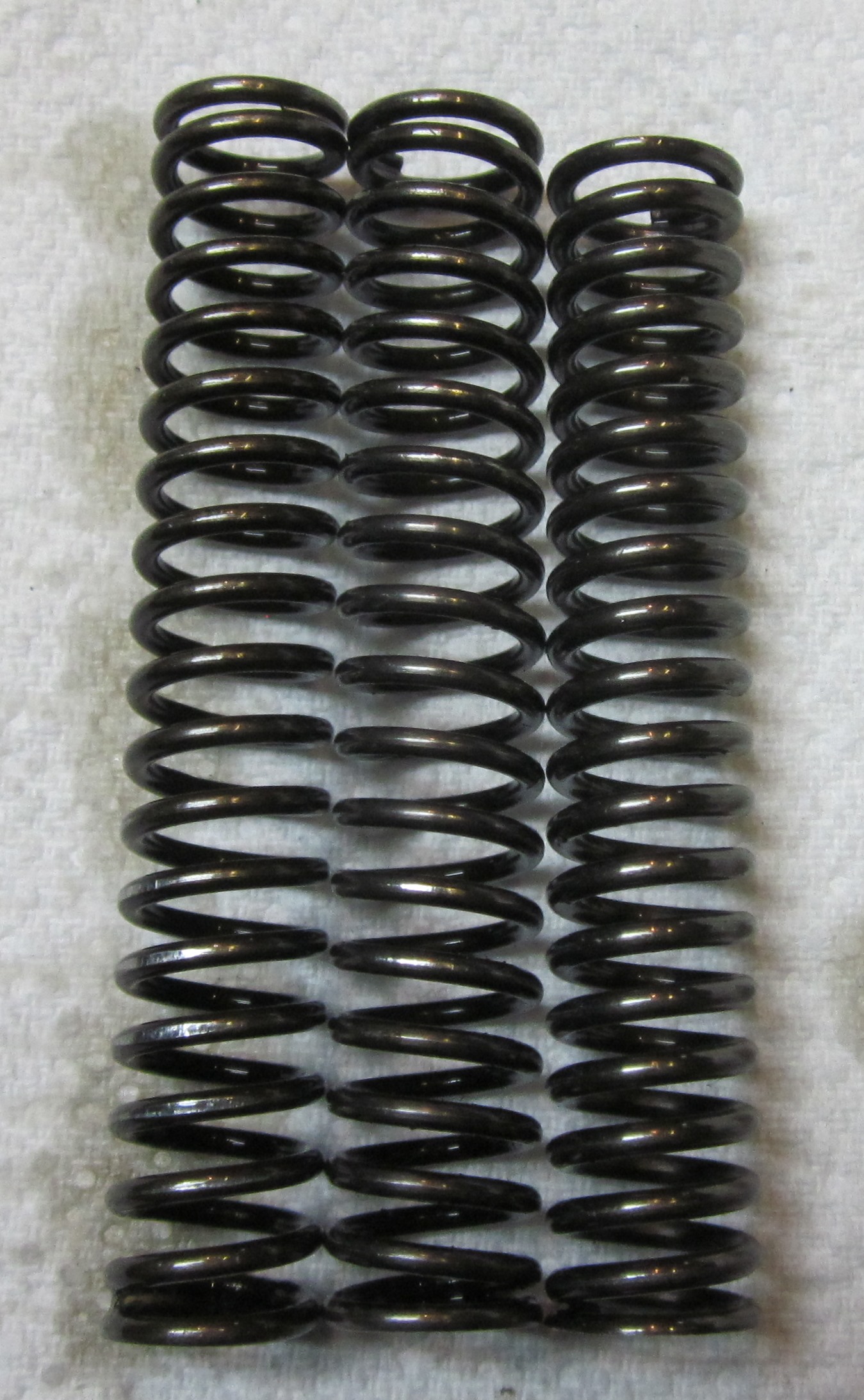

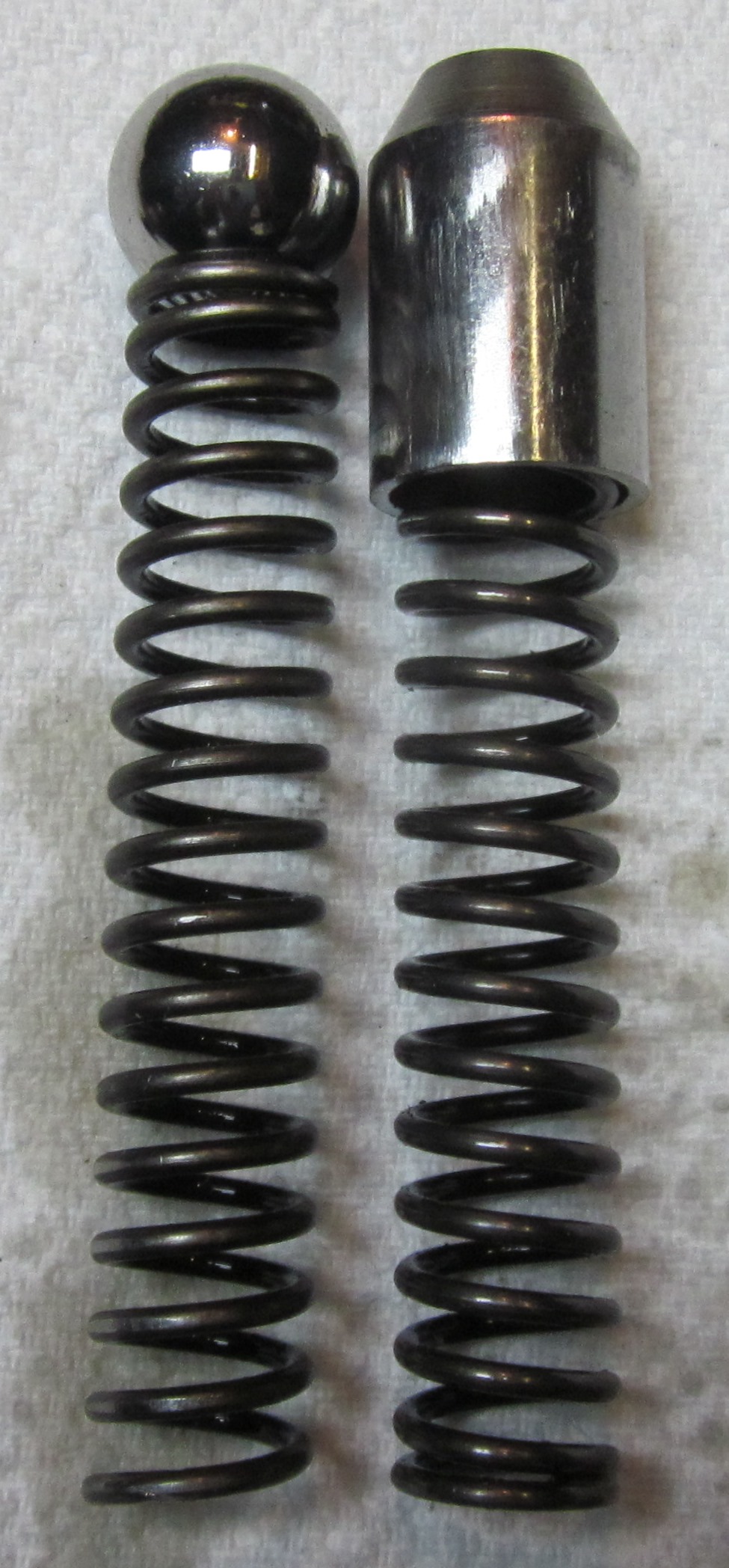

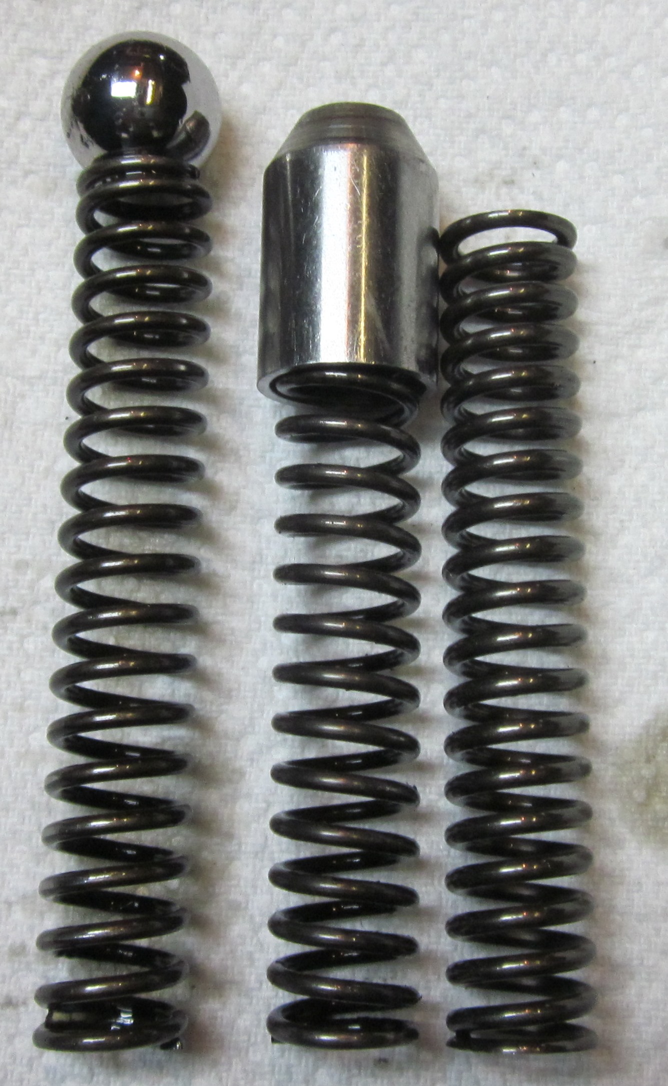

Here are the spring pics:
MG, MG, Mini
[attachment=2]IMG_5024.JPG[/attachment]
Ball on MG spring
[attachment=1]IMG_5025.JPG[/attachment]
MG, MG, Mini Springs
[attachment=0]IMG_5026.JPG[/attachment]

MG with ball, MG with plunger
Two coils removed (wear eye protection then you do this!!!!)
