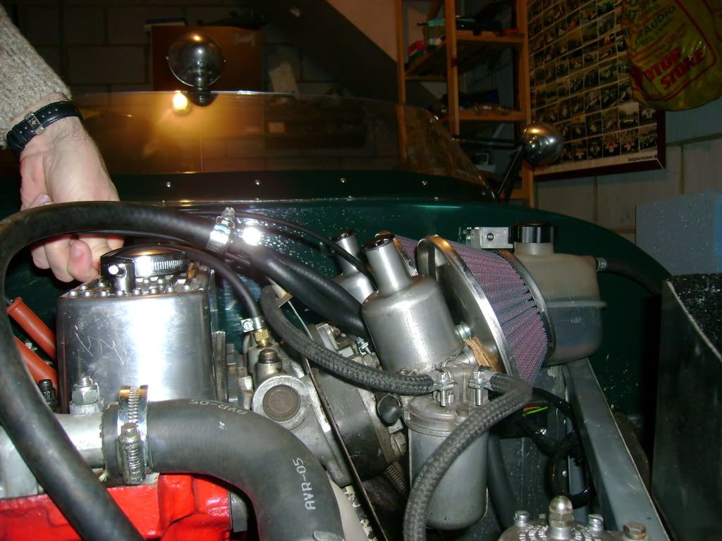

Before I got the Weber I was running twin SUs 1¼" but I did find a nice set of 1 3/4" brand new that I picked up for £20 or so! Unfortunately they wouldn't go undet the bonnet.
I was just seeing where it would fit. I could possibly shoehorn it in but it would be a tight fit unless I did something drastic like going blow through and mounting it where the alternator is. Trouble is I don't think that the car needs that extra torque so I am enjoying it as it is.

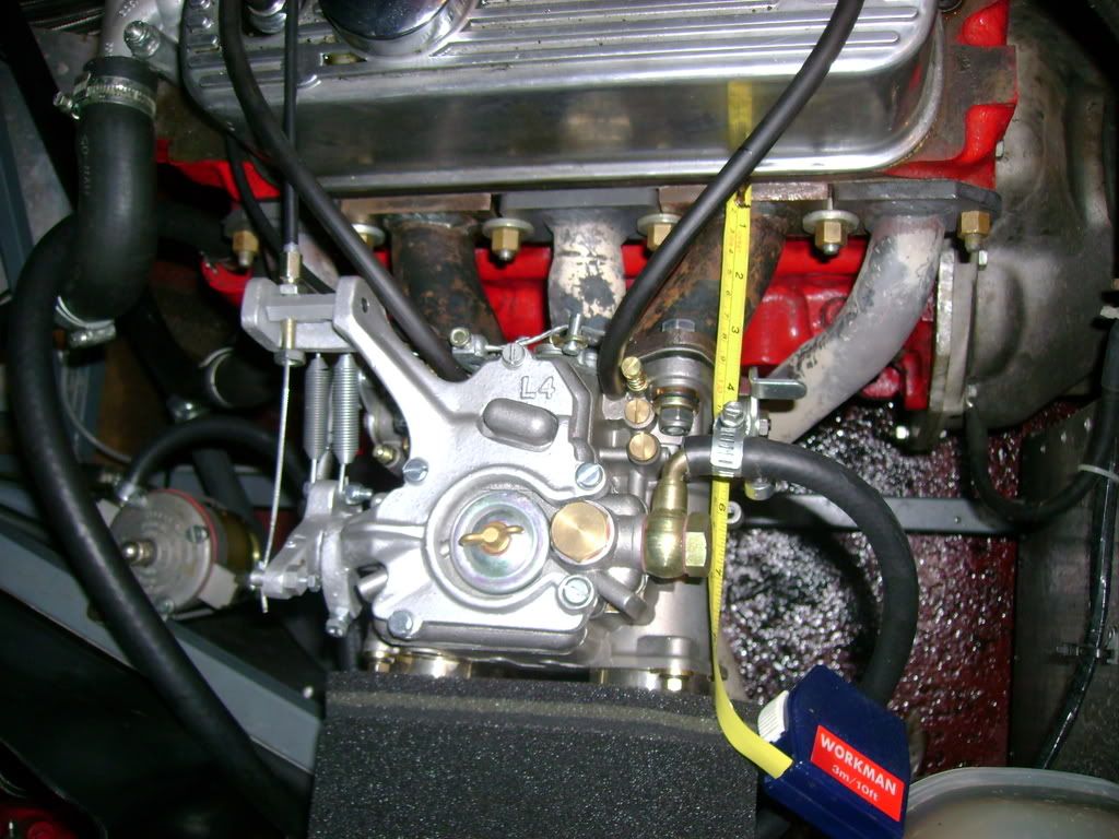

Hi Matt. Maniflow tell me that they make the flat manifold in a variety of lengths. Is there any chance of you measuring yours for me? I can see i've got somewhere between 9 and 12 inches of clearance between the block and the chassis rail, but of course it's all so dependant on exactly where the carbs sit. If I can just tell them to make my manifold to the same length as the one you have it might increase the chances of this all fitting for me.....
Just been to measure the manifold and it is shorter than I thought, face to face is 3½". The Weber trumpets sit over the chassis rail so clearance is less of an issue, see photos. The most important thing I think is the height, not going over the level of the rocker cover T handles. Maniflow should be familiar enough with the A series to come up with something to suit. (I sourced mine via Ebay second hand).
Thanks Matthew - that is really appreciated. I'll have a chat to them in the morning. Sounds like I can go a little longer than you have, although I guess at some point the bonnet starts to drop and reduce clearance height.
