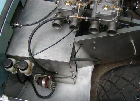

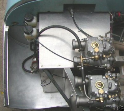

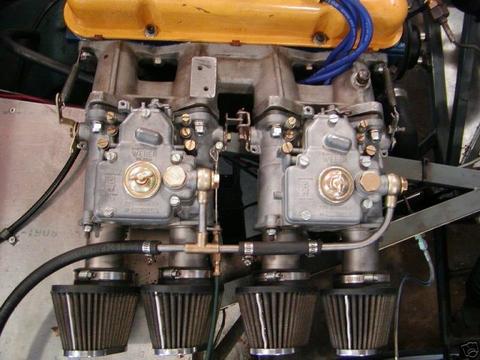

Still don't get it that twinn webers to the right shouldn't have room enough under the hood/bonnet, just found these pic's in Yahoo w11 group
[attachment=2]ford weber-1.jpg[/attachment]
[attachment=1]ford weber-2.jpg[/attachment]
[attachment=0]ford weber-3.jpg[/attachment]
So my point is that there are room for the webers it's just a matter of getting a manifold that place them in the right hight and at the right angle. A job for Maniflow
And maybe some stiff engine mounts
