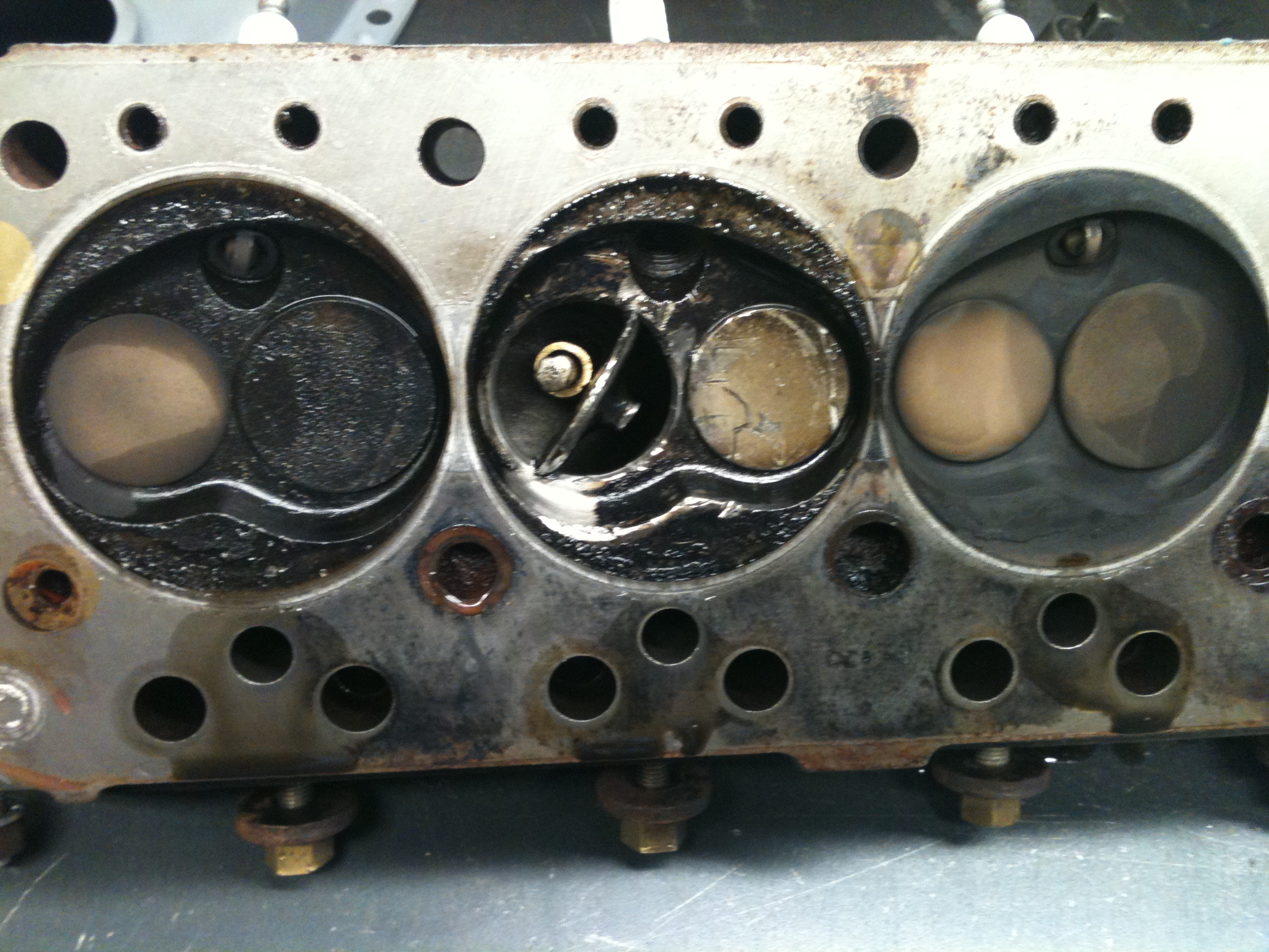

I really don't want this to happen again so K Series replacement starts this week. If you're running a roller rocker in an A series this is what may happen if one of the roller pins fails.
[attachment=1]aug 09 080.jpg[/attachment]
