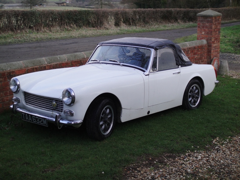

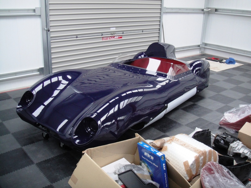

It arrived today! Contrary to Jan's 'The Last XI', I took delivery of a new RHD Westfield XI with dark blue polished bodywork - and so the build begins. The donor car is a plucky little Midget with a 1400 engine and rather good Minator wheels. It's a shame to break it, but I needed a car with an MOT that I could drive when we moved house (recently). I'm sure the bodyshell will find a good home.
The kit is being housed in a new workshop I had built - in fact it's not quite finished, and is waiting for the electricians to arrive. It's a steel framed, insulated structure supplied and installed by 'OZ-UK' . I certainly recommend them. The garage measures 8 metres by 9 metres, so there's plenty of room, plus a 4-post lift. I have a couple of other precious cars to get in there too.

Looking good already!!!
Re: Chappy's Build
An excellent choice of colour, I must say!

Is it only me who thinks that Midget looks georgous?
Seems a real shame to break it up....

Yes, as I wrote earlier, it's a plucky little car. The attraction for me was that it had those wheels and tyres (with a new spare), plus a recently rebuilt 'fast road' engine, a new radiator and steering rack. The good news is that out here (in the middle of nowhere) I have only two neighbours, but one has a Midget that has rotted away, so we should be able to rehome this bodyshell once I've had the bits I want. I'd also say that although it looks great in the photo, it's not quite so good up close, though the floor pan is good and solid.
