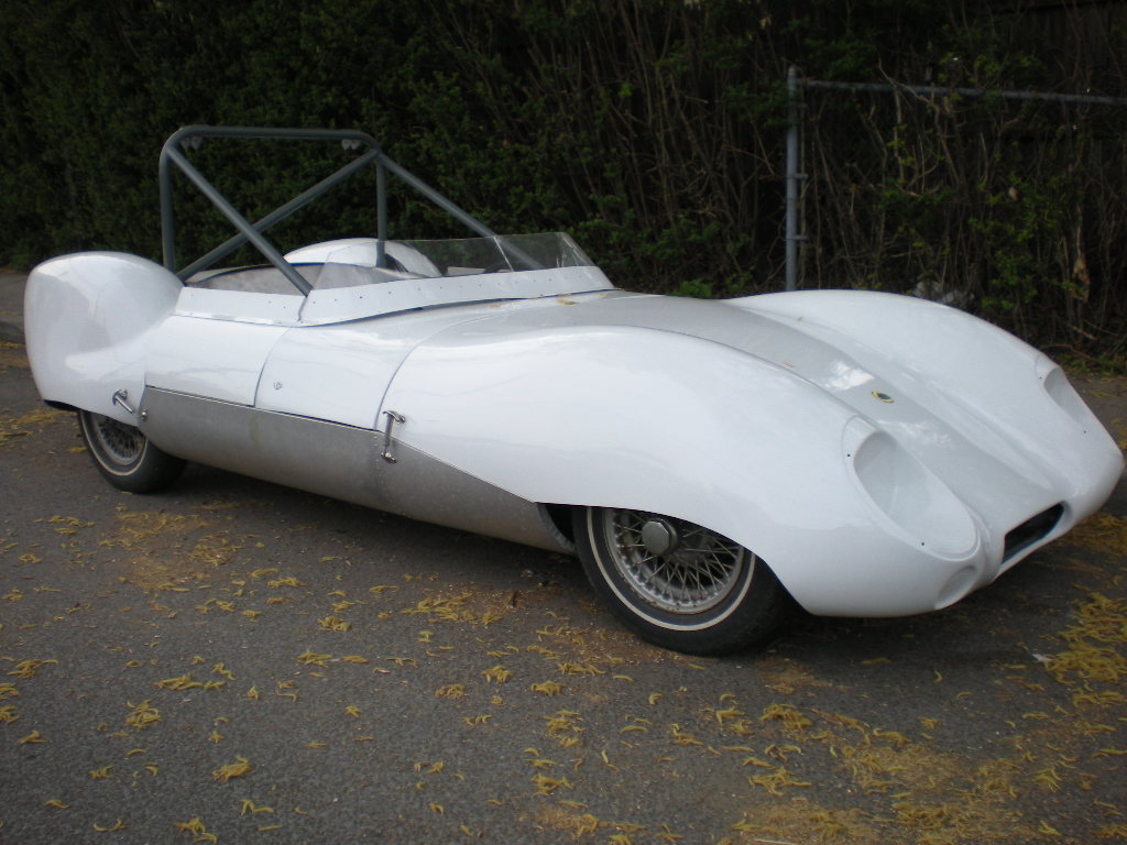

[attachment=0]DSCN4388.JPG[/attachment]Hi, Andy in New York. Just bought a series one XI and found this page, GREAT!!! My kit has sat a while, but has never been completely built. Looking where to begin? Was there an assembly manual. I would love to see one complete, and I live in New York? Anyone local or have a site that they used for their build? Any way, Glad to be aboard. I will try to post some pictures, Andy/Users/andreworourke/Desktop/Westfield  XI/DSCN4401.JPG

This is I believe an early production? Does anyone know where the serial numbers are? No gas tanks? where do they go. Who knows about interior options, and!!! I need a center section windshield. Thanks.

That car has been modified, with different damper mounting positions on the rear axle, rod ends in place of the original bushings for the trailing links, and fabricated front suspension arms. These parts are substantially different from the original factory bits.  There have been some frame modifications and additional frame members added to that chassis. Modifications to the rear section, moving the dampers inward, to the rear floor, and the passenger compartment floor. There is also a roll hoop added to the scuttle section, I guess for the forward part of the roll cage, required by SCCA.
I don't know what parts were with the car that came with the original kit, as the seller was not forthcoming with all of the information that I had asked for.
The chassis number, if there is one, should be on the top, forward most frame tube. It will be a small square piece of metal welded to the tube, with numbers or letters. Sometimes, this is covered by the forward top radiator support.
The car is early production.
The fuel tank goes in the right side adjacent the passenger compartment foot well. The fuel tanks are not "side mounted. There is a well to the right of the scuttle floor that holds the roughly 5 gallon tank.
