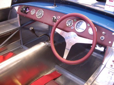

All 'genuine' elevens that I have seen have extra gauges, switches in different positions etc to suit the needs of the drivers over the last 50+ years, often with racing in mind. When I made the dash for my chassis I looked at several pictures of cars and cut a piece of 18 gauge to size, bent round the bottom tube using a soft mallet and then cut out the holes using either a stepper drill bit or drilling small holes round the larger hole and filing down to size. Only took a couple of evenings then coated in contact adhesive and covered it in the same material as seats, it looks quite convincing. Picture below to illustrate this arrangement, with its IVA compliant gauges, and Lucas SF4 fusebox!
